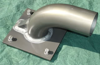

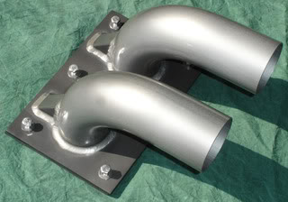

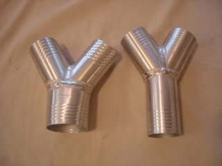

Greenie
6,820
Like this?
Also with a base plate:

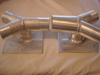

If you really want to maximize airflow, get one of these:
