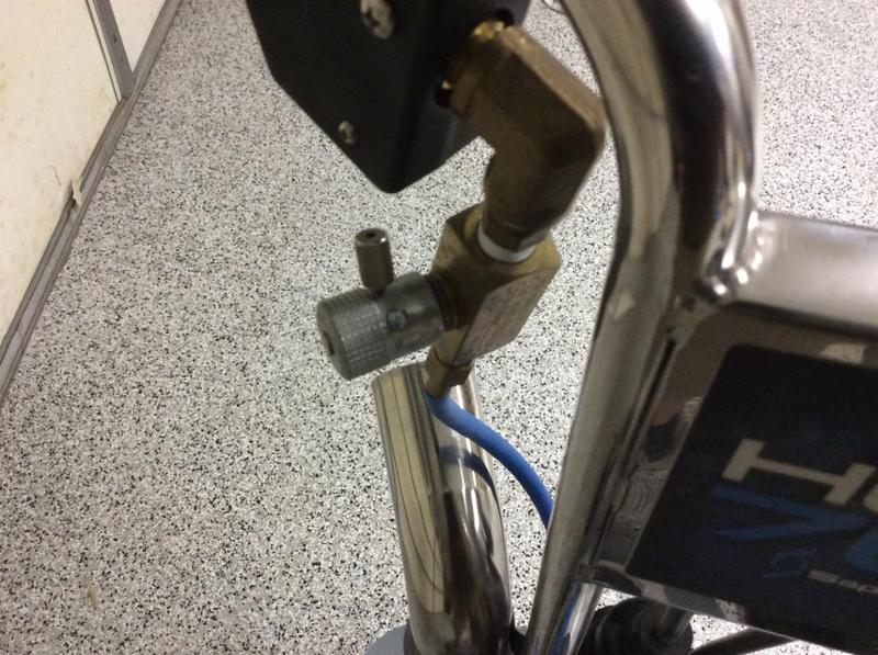

Dan
49,572
Prattville, Alabama
Seems to me that controlling the flow is completely paradoxical to the reasons for using that tool. Increasing the vacuum efficiency should be the focus.
Dan
Dec 19, 2006
979
Beaumont, Ca
Dan
Gives you control for every carpet as apposed to running back and forth to truck.
