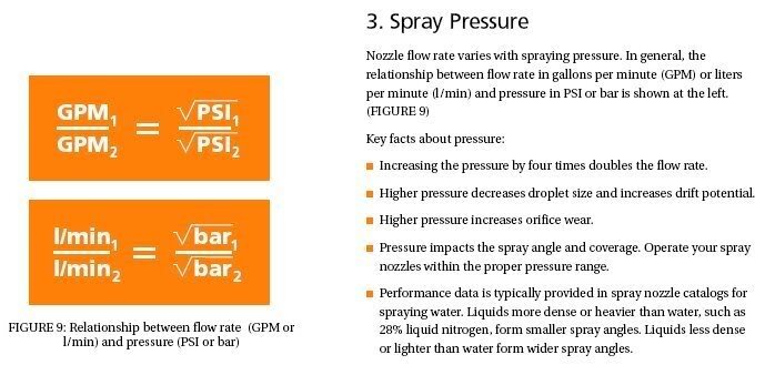

Eric Valentine
Four times the pressure will double the flow.
This was taken from the teejet website's users guide to spray nozzles

Using the bucket, at 400 psi, with a 9506, single jet wand, I get 1 1/2 gallons a minute.
