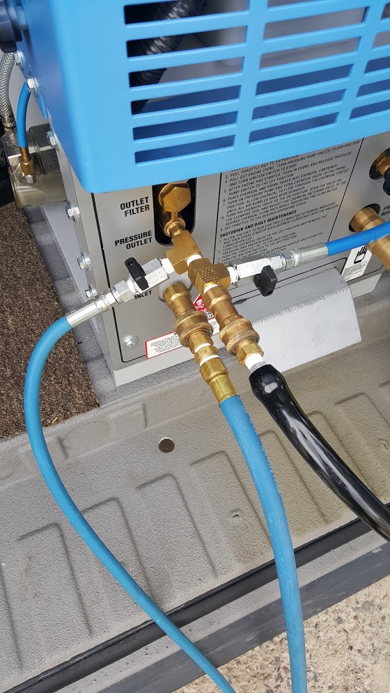

The fine folks a Carpet Maintenance Supply hooked me up with a "Hot Water Convenience" hose (left ball valve)
and a other line just for filling my rinse tank.. (right ball)
Y9RB6FLU6hu4KGXbaKHMokvxSipcGSo5MCQVOSBwA4hblx_4t6zTC-9IAwIYpUTTIVDOCH29lA0WdF74PG8=w560-h995-no.jpg
Most TMs dont come stock like this so lets see how you do it..

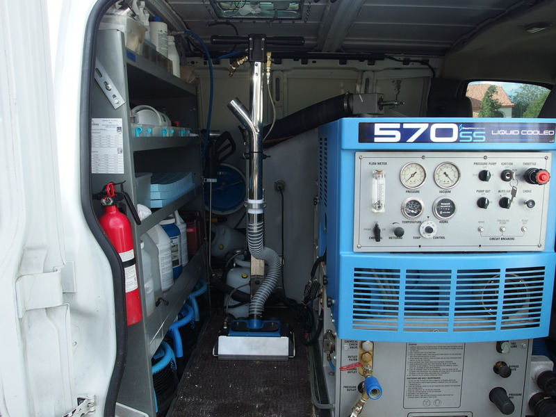

Butler has a Hot Water convenience hose and nice shut off on the front of the unit...the hose is pointed through a hole in the bottom of the floor to help prevent water getting in van, or burning you.
We just pull that hose out from it's floor hole, wipe off road grime and fill jugs and hot water as needed.
I also have from my fresh water tank a hose with a valve too for the cold water if wanted....

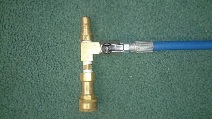

Hydro-Force just introduced a quality convenience hose outlet two weeks ago. Top quality 1000+ PSI ball valve and Qucik connects. You can buy it assembled View attachment 12017 for less than the cost of the parts to build it.
That looks convenient, Scott. But why not just plumb the tee directly to the machine and eliminate a set of quick connects?
Buy that assembly, remove the female quick connect for use elsewhere, and plumb the tee to the machine.
