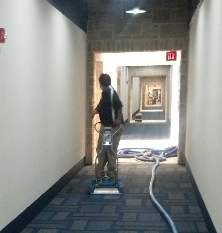

Top down or "in place" drying is another popular option for drying. The pro's are you only have to disengage a small corner of carpet to check for a porous carpet cushion so you are less likely to damage the carpet or seams when handing a wet carpet. In place drying requires more drying equipment and less labor so it is more profitable.
The cons are you are not getting warm dry air to the carpet cushion so a thorough extraction of the carpet and cushion, increased vapor pressure differentials between the wet material and ambient air, as well as the sub floor temperature well above dew point are crucial to successful in place drying. In place drying usually requires more equipment on the job and more effective equipment so your initial equipment costs are more.

I've done a few small top-down drying jobs.. I've used the water claw followed by the zipper... The wicking of the walls weren't that bad considering the source of the leak was a downspout over flowed between the walls... The wettest part of the wall was cut out to find the source... I used a airpath and dehu to do top-down drying... The carpet/pad dried in 1 day, the other walls took 2-3 days to dry then had a repeat flood as it stormed hard.... The second time wasn't too bad but additional days to dry out was required... It was a ground floor with concrete subfloor...
I get that it depends on the subfloor and pad if your able to do top-down drying.... IMO I think its more possible/efficient with the sub-surface extraction tools available...
