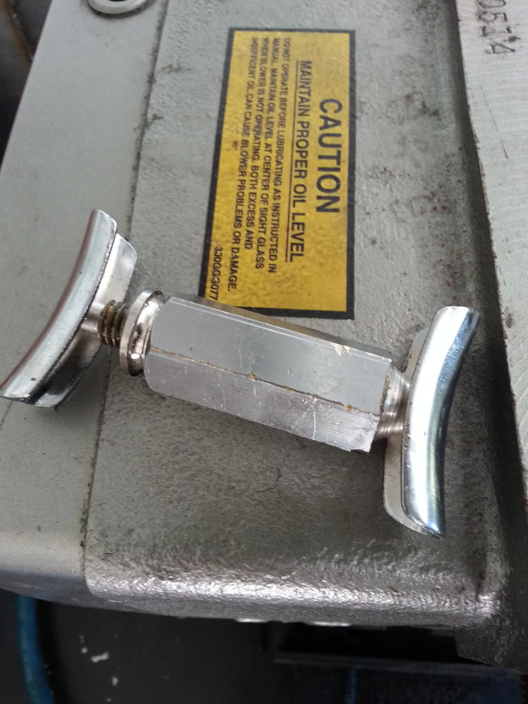

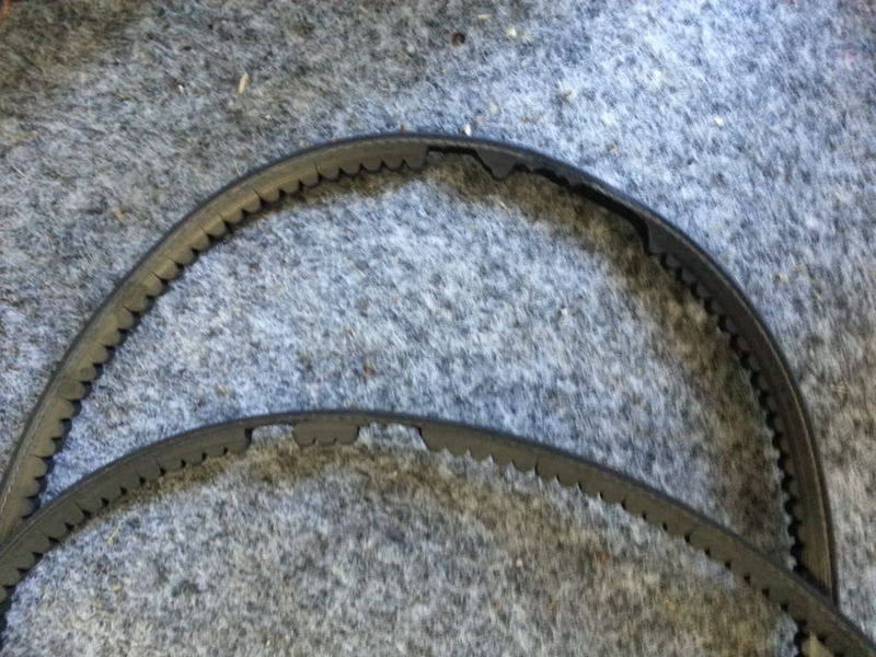

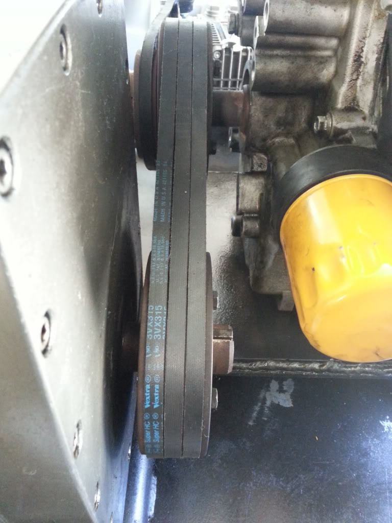

I'm pretty sure this is my third set in 780 hours..
I'm snugging them up to what "feels" right and snugging them up again after a few days of replacement, even using this tool to do the centering/tightening..
Looks good and straight..

Vortex belts last "forever" but they are way LONGER AND RUN much COOLER..

A standard rule of thumb on deflection with 3v belts is 1/64 inch for every inch of length (belt span). Length being measured on top of pulleys center to center. Example, 32 inch run would be 1/2 inch deflection. That's using roughly 5 to 5.5 pounds of force.
Well, here check it out for yourself:
http://www.morbark.com/service/belttension.pdf

When my 3 belts broke, they disintegrated all over inside my van. Not much left. Thats why I reommend Predator belts.
