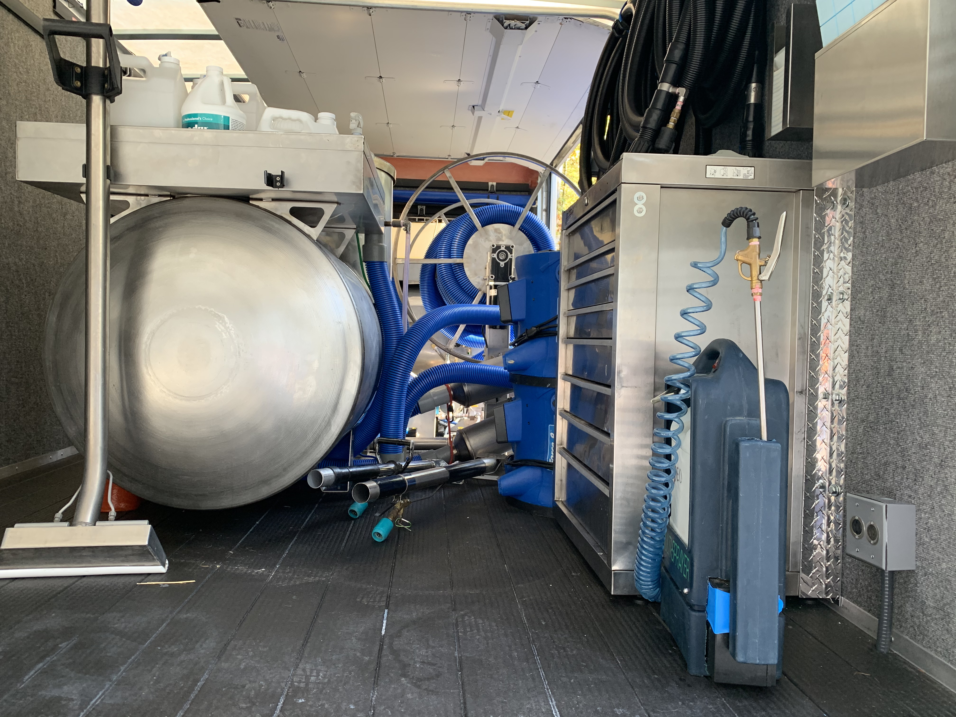

I stopped using filter for the waste tank 4+ years ago....I get more suction at the wand.
To empty waste tank, open the ball valve and let it all out in my yard.
been doing this for the last 4+ years. Only one clog in all those years....ran a plumbing snake through the discharge pvc pipe, quickly dislodged the gunk. Every now and then suck a gallon or two of cheap enzyme deodorizer into the waste tank to freshen things up and eat up the gunk.
EZ system works well for me.
