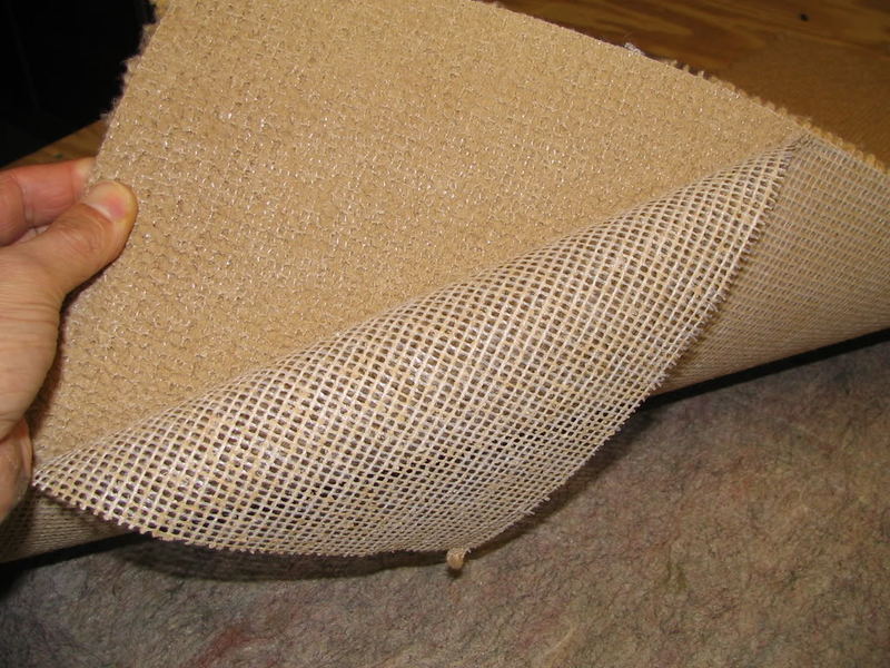

I will try to post some more later, just a little tight on time now and just got back in from travel but here is one point: Try to remove the backing from as large of a piece as possible when you are setting up to do a graft, here is an example of removing the secondary backing
Then, when you cut out your donor piece you will not have to try to remove the backing on a small piece.
Hope this helps, sorry to be so brief right now.

Use a bigger piece for the donor if possible like Steve is showing in the photo. Sometimes you still have to work it till you have a corner or edge that is big enough to yank. Otherwise yes it is more difficult to remove it from the smaller piece.

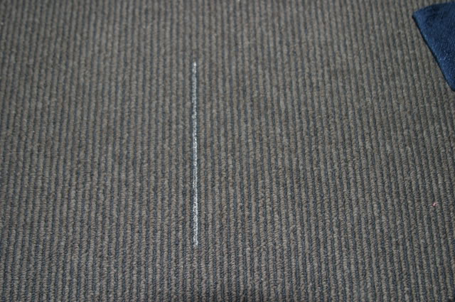

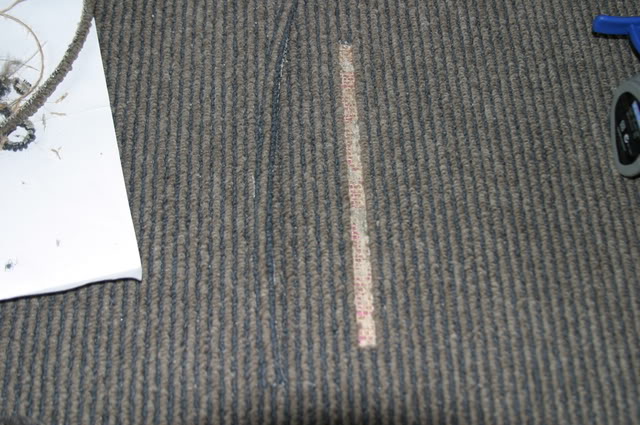

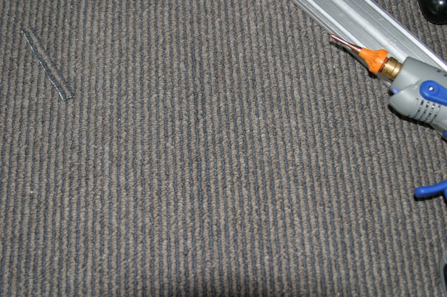

Graft from today. 2 week old install. Client damage so not a warranty. Didn't want to pay the rate for me to sit there re tufting. For retufting, I'd guess around $300 but I chose to graft at $135 for 25 minutes work.

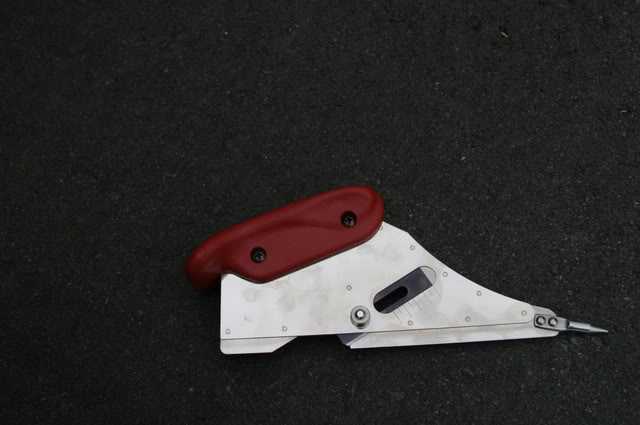

So John, how did you cut the problem piece out without damaging or cutting through the jute? Did you use a scalpel or something? This is the bit I'm having trouble getting right but can't find any info on exactly how it's removed off the backing successfully. Nice repair - customer must have been rapt.
J
Jack May
I use a cushion cutter.
This has 2 adjustable blades depending on which side of the row you are wanting to cut.
Adjust the blade down to half depth, run your awl or whatever through the row a few times to help define it and open it up then run the cushion cutter through. Run back the same way. This cuts the primary backing only.
Once you have that done, I then like to pull the threads in the middle and let them pull out 1 loop at a time and when I have it all neat across the number of rows I'm doing, then I use a new blade in my stanely and carefully trim out the ends, including cutting through the yarn that is now between the two backings.
Trim up the other end the same, and that will give you a really neat cut out.
