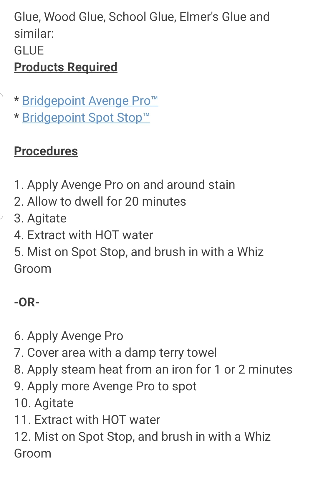

I used avenge pro or solvent clean and cut slits to let the chemical in the goo. After 15 or 20 minutes dwell I hit it with the 360i Quad or BH and it came out. I was surprised and it was the first time I had had any success removing the junk.

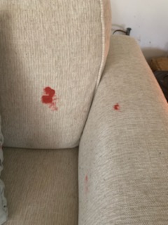

look what a customer just sent me to have look at tomorrow..
not sure if its home made silly putty or not? But its bright! 😳
