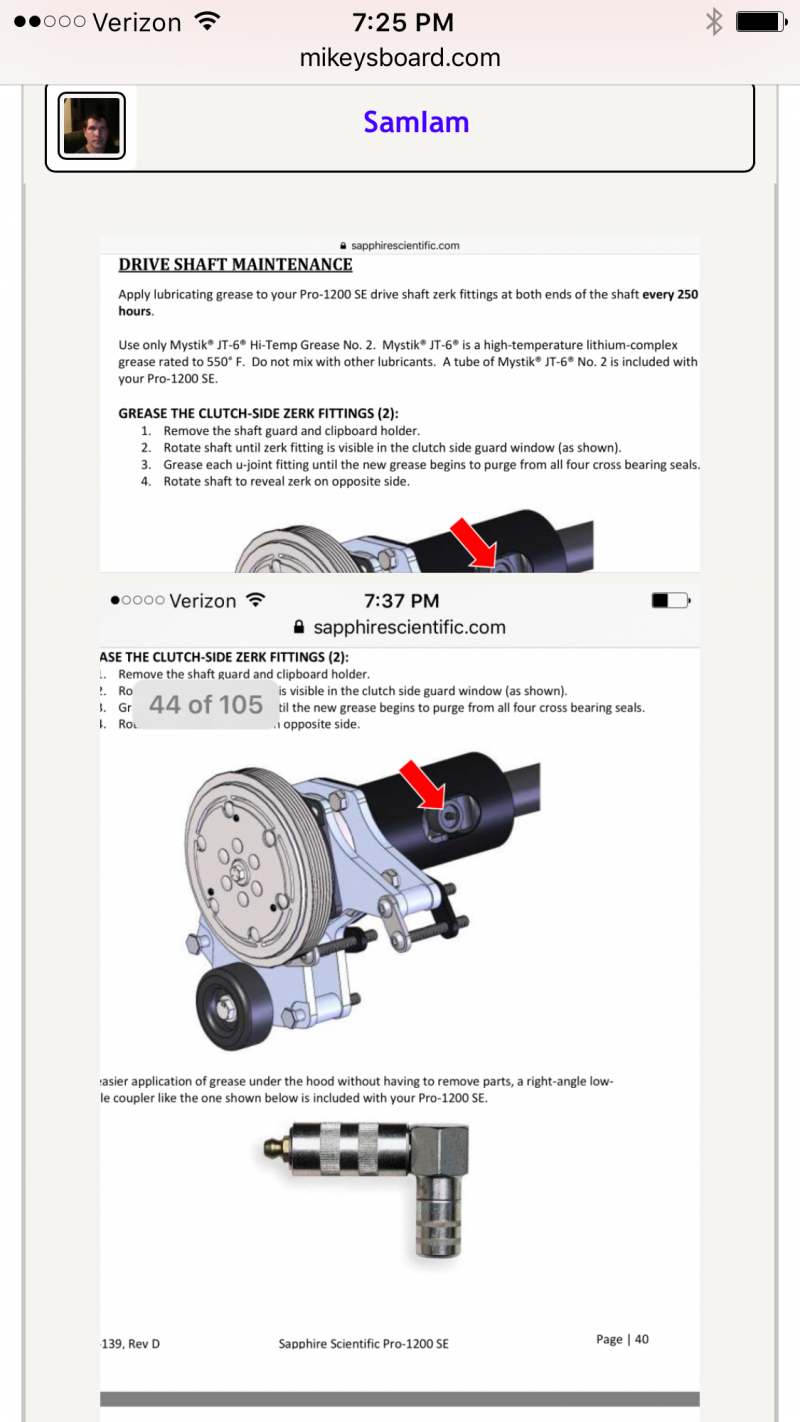

This image is for the pro1200 se you need the grease gun fitting at the bottom of photo and line the above response said there's a few place to grease so keep
Rotating and filling.
