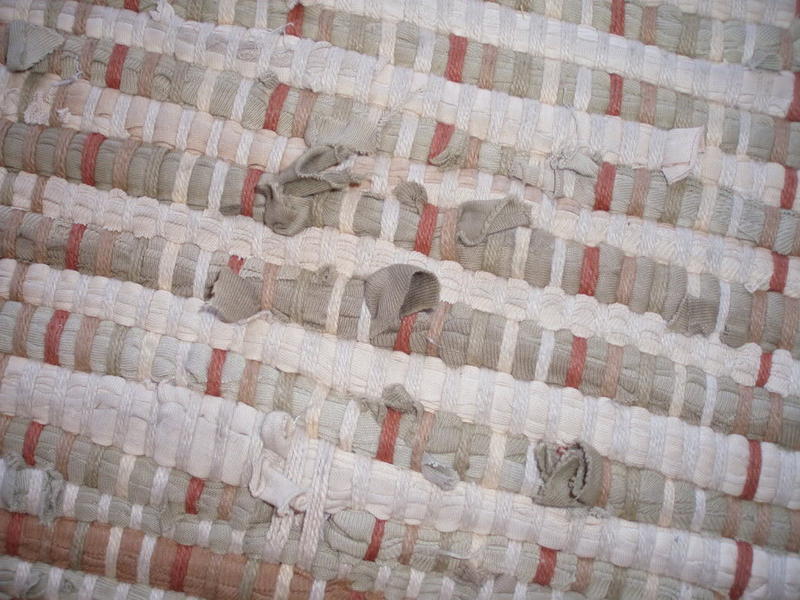

All Cotton construction. No backing., Lots of loose "threads" sticking out.

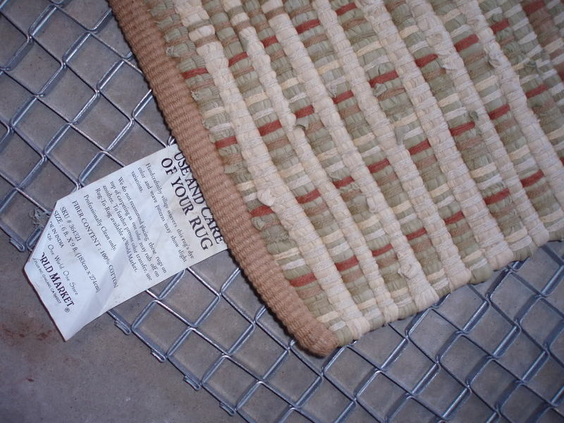

The problem with this thing is that there are hundreds if not thousands of loose ends (as you can see in the 2nd pic) that will pop out of the weave if overly agitated or "sucked".
We actually put it in the commercial wet washer.
