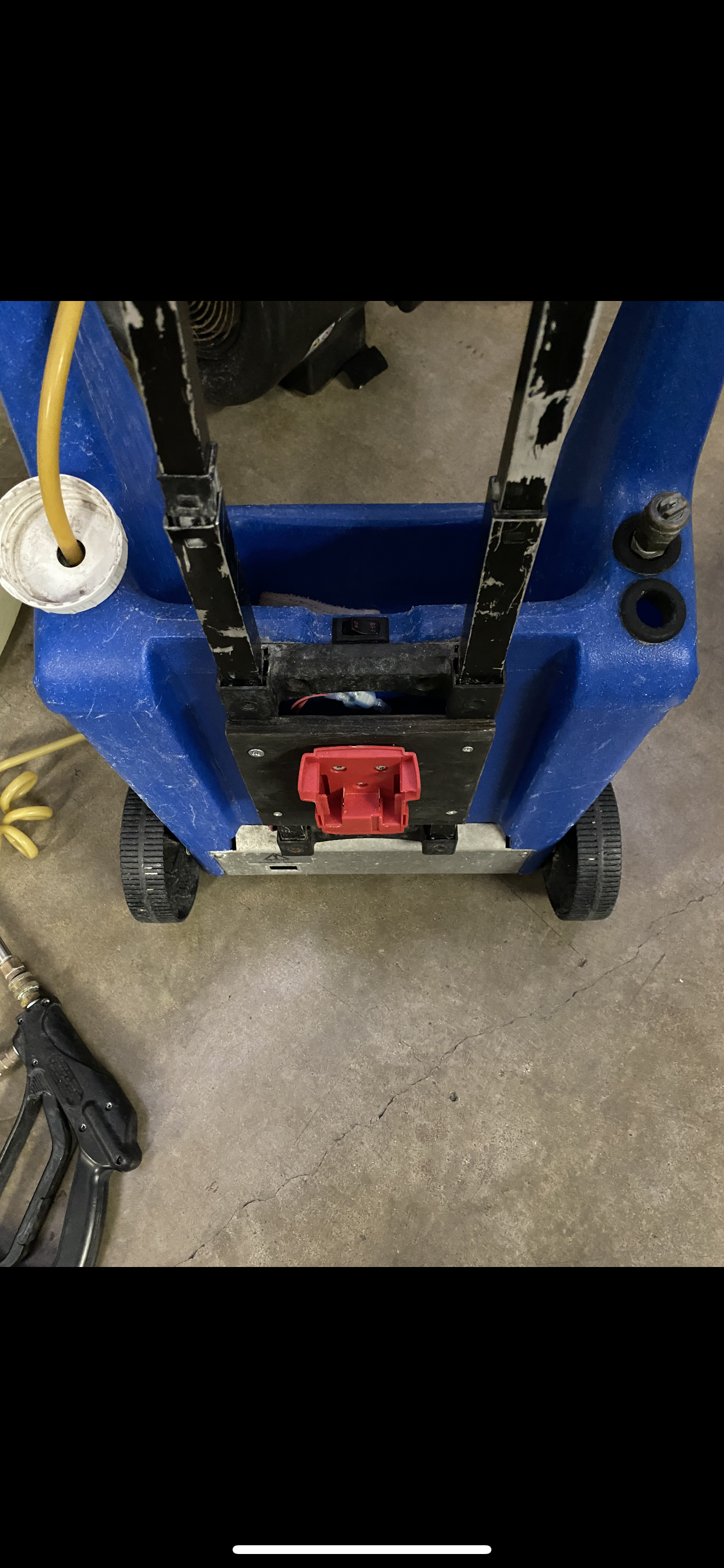

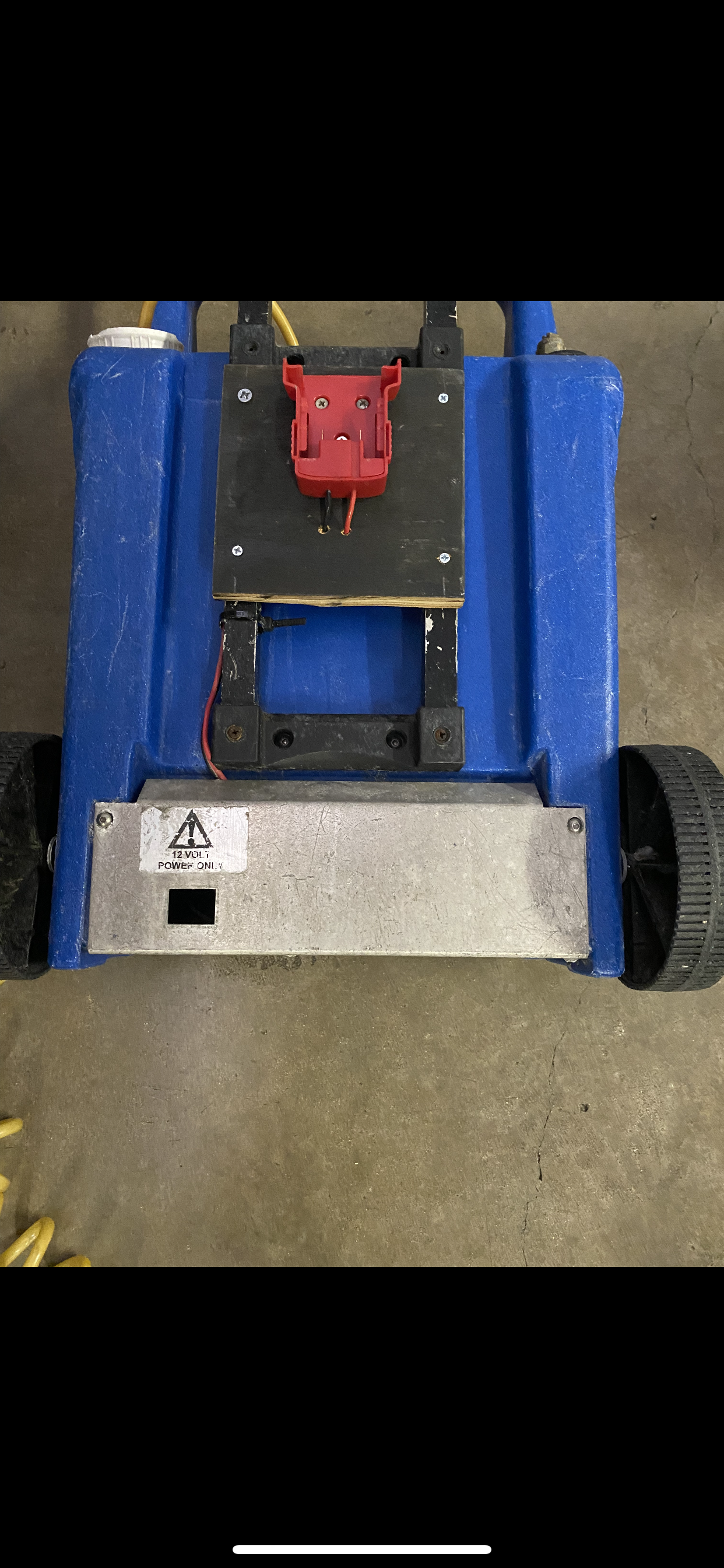

I have 5 of those multi sprayers. Only one still works and it can’t be charged by plugging it have to remove the battery and charge it by itself. Still love it though. Used to carry two on the van before they stopped being capable of charging. Never have found out what’s wrong with them.
You can switch out the internal batteries for Milwaukee, DeWalt, Makita.. Just get the adaptor for whatever power tools you currently use.. I did the 12v first, then the 18v.. Runs great and you know what level the battery is at, no more guessing on the job..

Thanks for the advice. How do you mount the battery on the sprayer?
That’s how I mounted it.. Works for me.. The reason I used the M18 is it shows the battery level.. No second guessing if it charged or not.. It bumps up the psi as it makes the pump spin faster..
Couple other guys used a DeWalt as that’s what power tools they got..

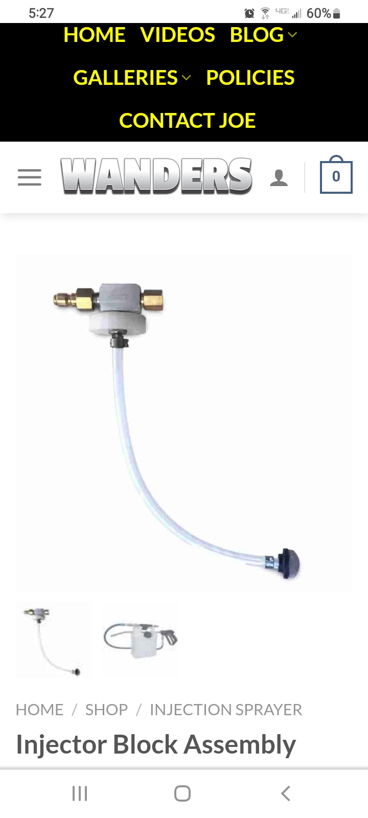

I’m having trouble with my sprayer. It changes tone like it isn’t always picking up soap and seems to get a bit weaker pressure. The filter is clean and I don’t see a blockage anywhere. I even replaced the block and I’m still having the same issues. I could use some help if anyone has any ideas. Thank you.
https://a.co/d/94hdkPH
Was replacement block a new one? There is a o- ring
and flat white washer in the block, they should be replaced, also is worth checking the spring, and ball in the tube. Make sure there is a tight connection, do not oversight. These hydro-force sprayers can behave weirdly at times. I have 4 of them, only two are working as of now. When you said that the filter is clean, what do you mean? You should have three filters, one before the block ( in QD), one after the block where the hose meets the handle, and one before T-jet at the end of spraying wand. You can submerge the block in the descaler, or the vinegar( take out the o-ring and plastic washer) and following day blow the gunk out of it. Sometimes Teflon gets in the system and causes the problem, cracked delivery tube has to be cut and shortened if possible. So when the venturi effect is disrupted you might have a problem. It's worth mentioning that at higher pressure you get more water, and less chemistry dispersed, with lower pressure is the opposite. In some cases, hot water coming through the injection sprayer eliminates mixture delivered and you're pre-spraying with hot water only. Too many variables...
I hope this helps. I have 10 blocks on hand, I've ordered another a few minutes ago, and you should too, the price is unbeatable.

This info is great. I usually put aside in old parts pile after a year or 2. Is it worth it to try to figure out, repair, and sit on inventory? Think I answered my own question Just took a look and they are over $300 now. May be digging them out of the parts pile and referring to this thread for repairs.
This price jacking is starting to piss me off. Cant wait until competative pricing comes back, and wont mind paying a premium for good service.

This info is great. I usually put it aside in old parts pile after a year or 2. Is it worth it to try to figure out, repair, and sit on inventory? Think I answered my own question Just took a look and they are over $300 now. May be digging them out of the parts pile and referring to this thread for repairs.
This price jacking is starting to piss me off. Cant wait until competitive pricing comes back, and won't mind paying a premium for good service.
I don't want to take your hopes about competitive pricing away, but don't count on it. If you need me to answer more questions, I'll be happy to. The least of your problem is the tube between the block and male Qd, everything else needs to be maintained vigorously.
