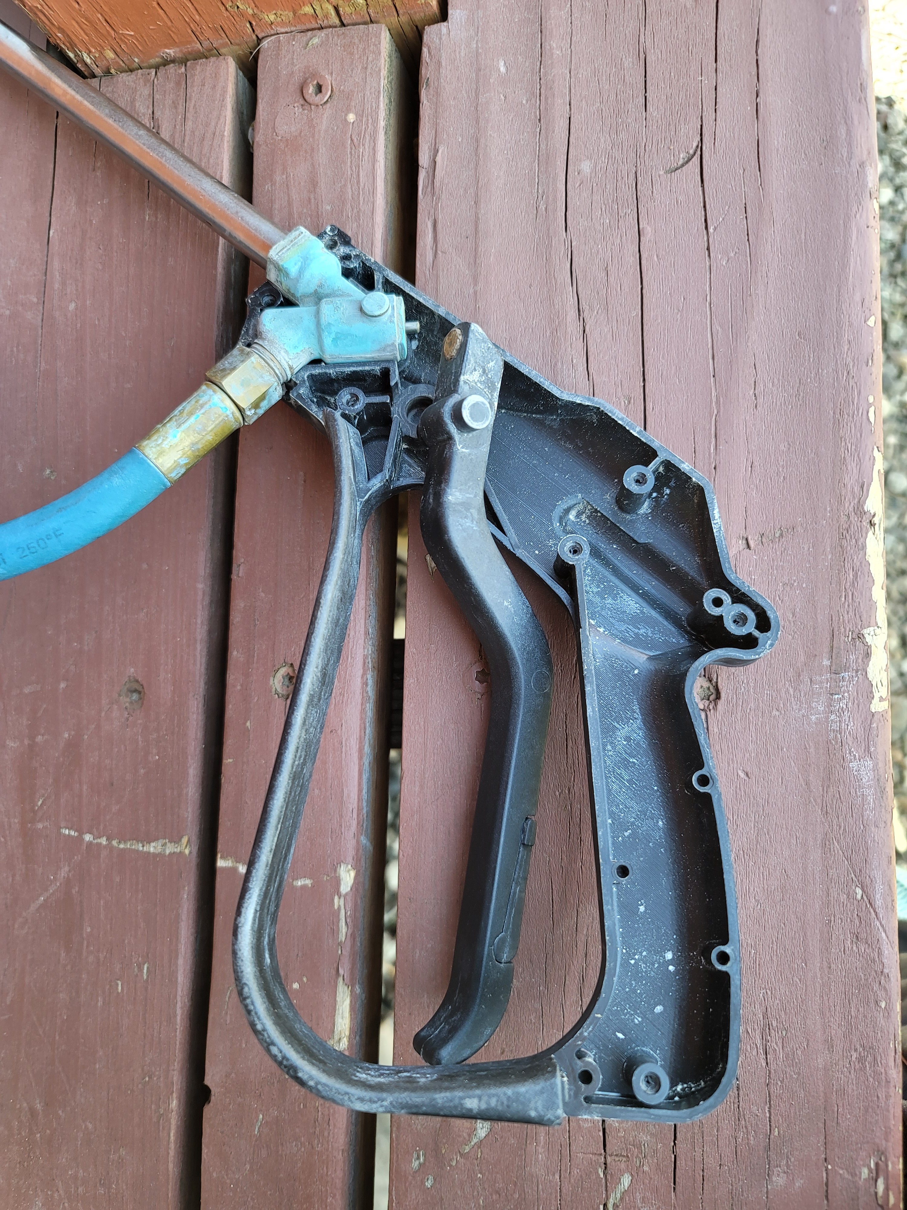

My hydroforce injection sprayer will not quit spraying even when not keyed. I pulled it apart and cleaned the filters and screens but it didn't help. Any tips or troubleshooting advice greatly appreciated!

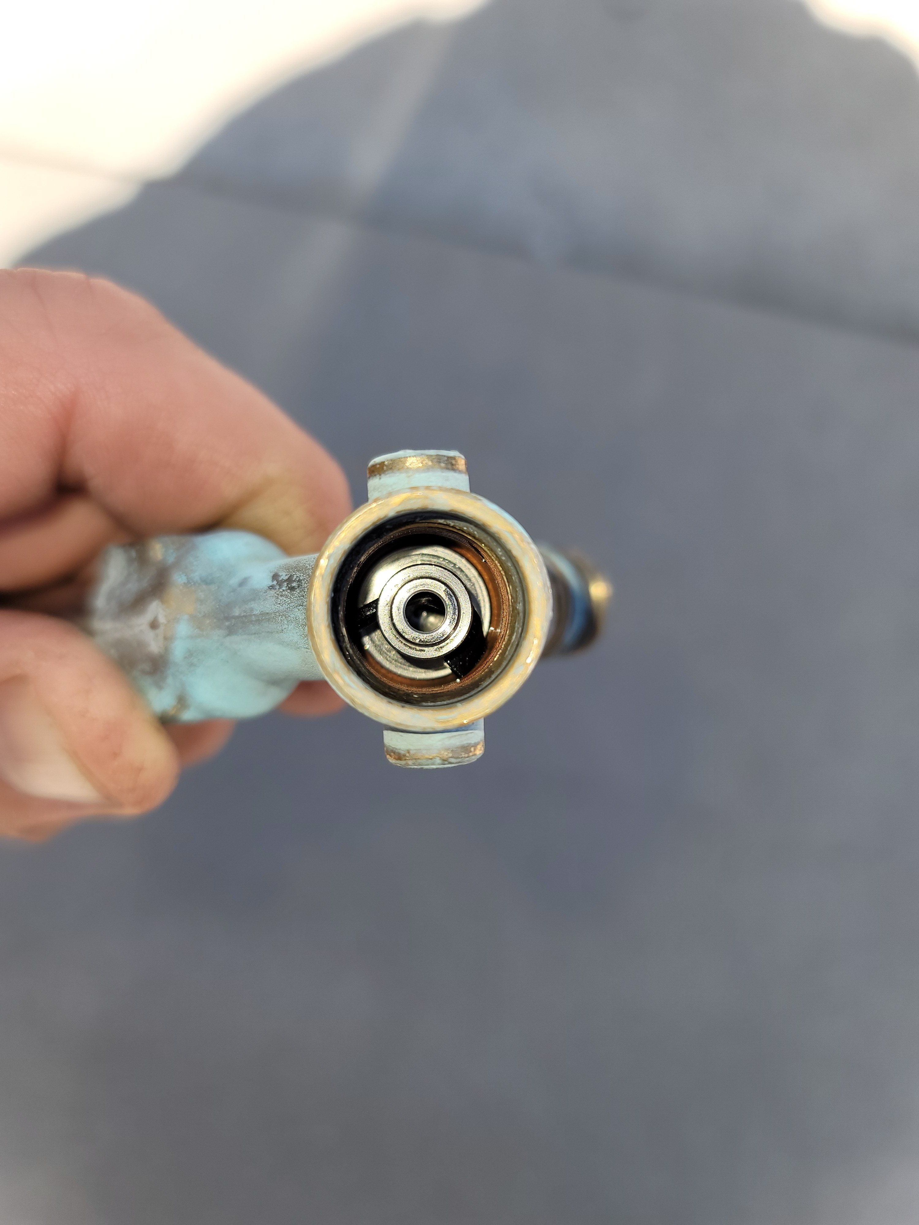

Can this valve assembly be bought individually?

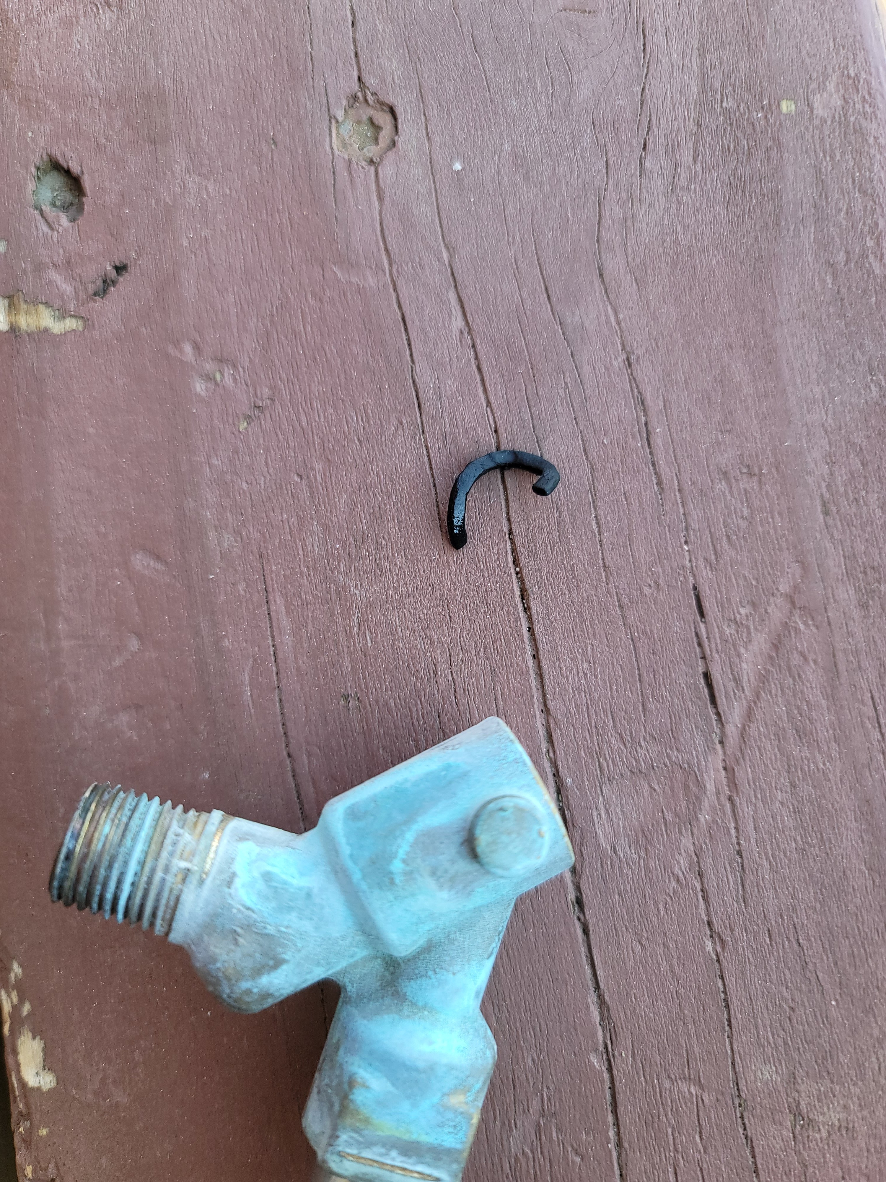

If you look closely at this picture you can see a busted seal, but where did it come from?20201003_125939.jpg
valve
or you can get the handle/trigger valve assembly for $37
looks like that 10 cent oring might fix you up though

Tried several different O-rings today and it made things worse. I think they were to fat. I think I'll order the replacement valve and pull it apart to see what the proper seals and O rings are. Then I can have a rebuilt spare on hand.
