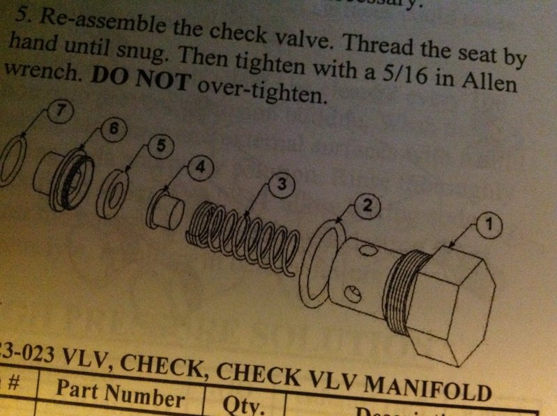

Paul before you go through all that check the oring on the solution outlet check valve. If it's leaking past the oring it will give you the symptoms your describing. The oring on the very end of the check valve. It's a part that gets over looked. Number 7. It will cause your solution meter to flow slightly also but sometimes not enough to show.
Gene

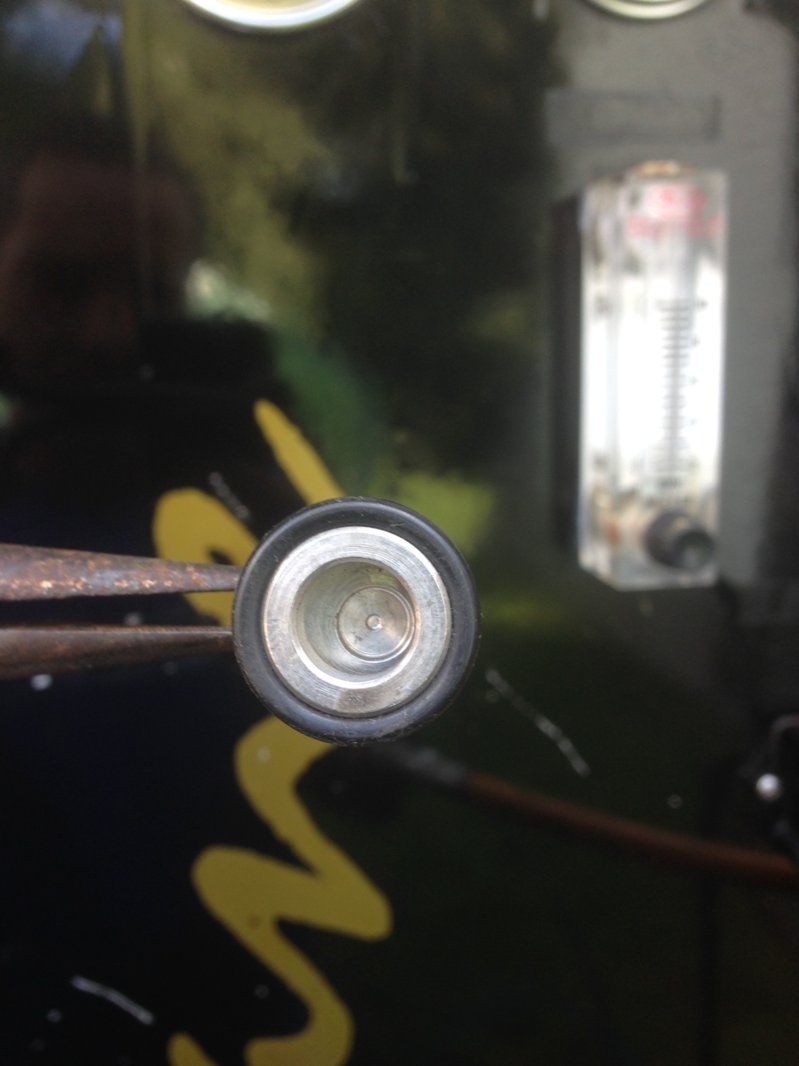

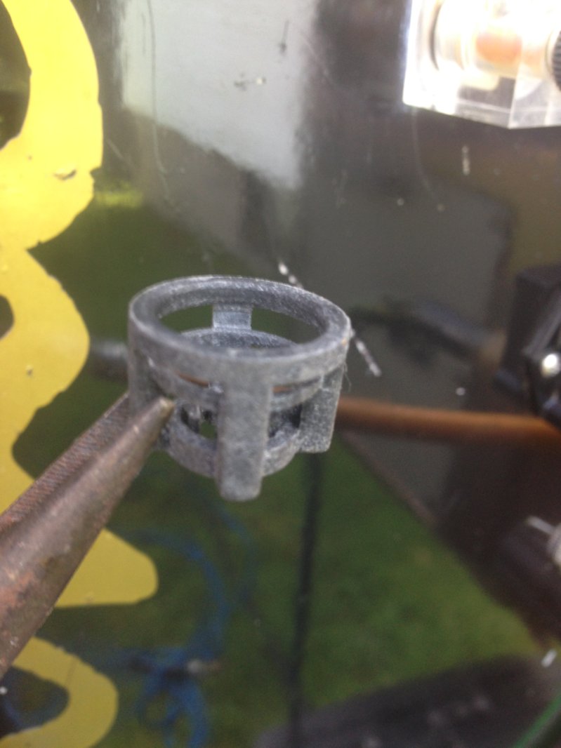

Sounds a lot like a stuck valve to me - the remaining pistons can get the pressure up but can't maintain it when there is flow.....
Dan hit the nail on the head !! I pulled out the check valves and the plate that rides up and down seated above the spring wore down the side frame enough to cause a lip which the plate got stuck under leaving an opening up top. 3 out of 6 had a lip - 1 more than the 2nd which was more than the 3rd. 1 was caught under the lip, 2 snagged but did spring back and 3 was occassional snag. I replaced all 6 and pressure is rockin !!
Spurlington
Dec 15, 2012
1,324
On The Board
Spurlino
You can see the circle looking from the top is off center in pic 1 .. see the lean in pic 2 .. pic 3 you can see the side worn down creating a lip
