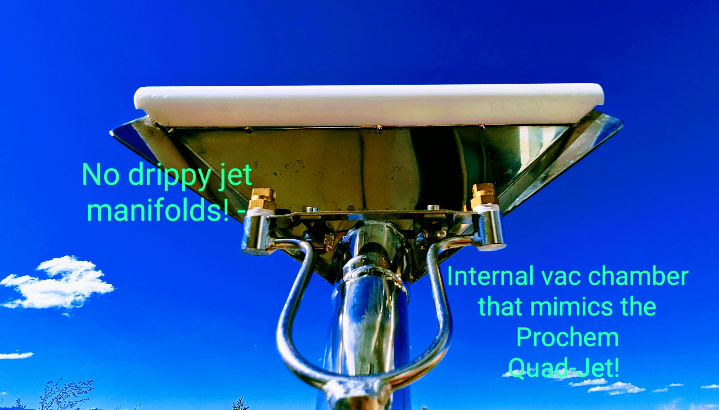

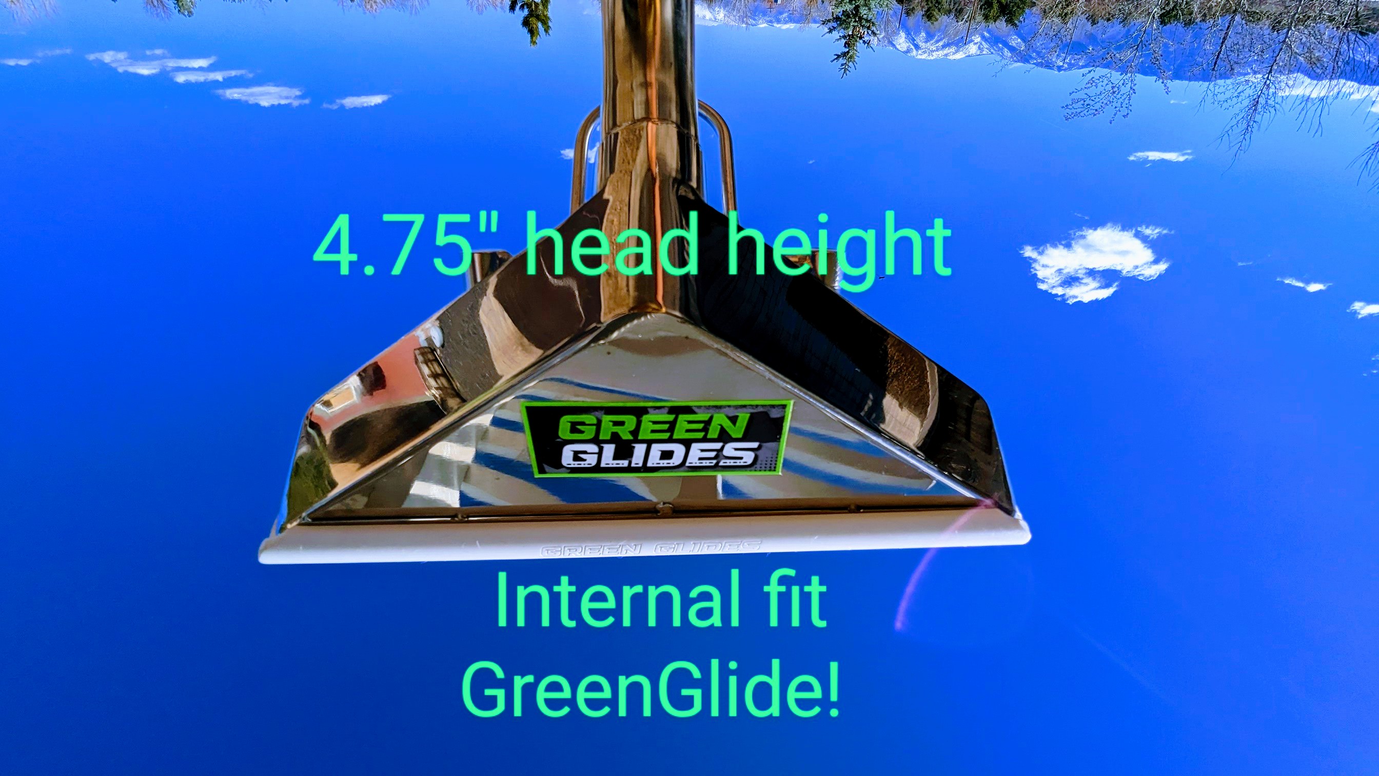

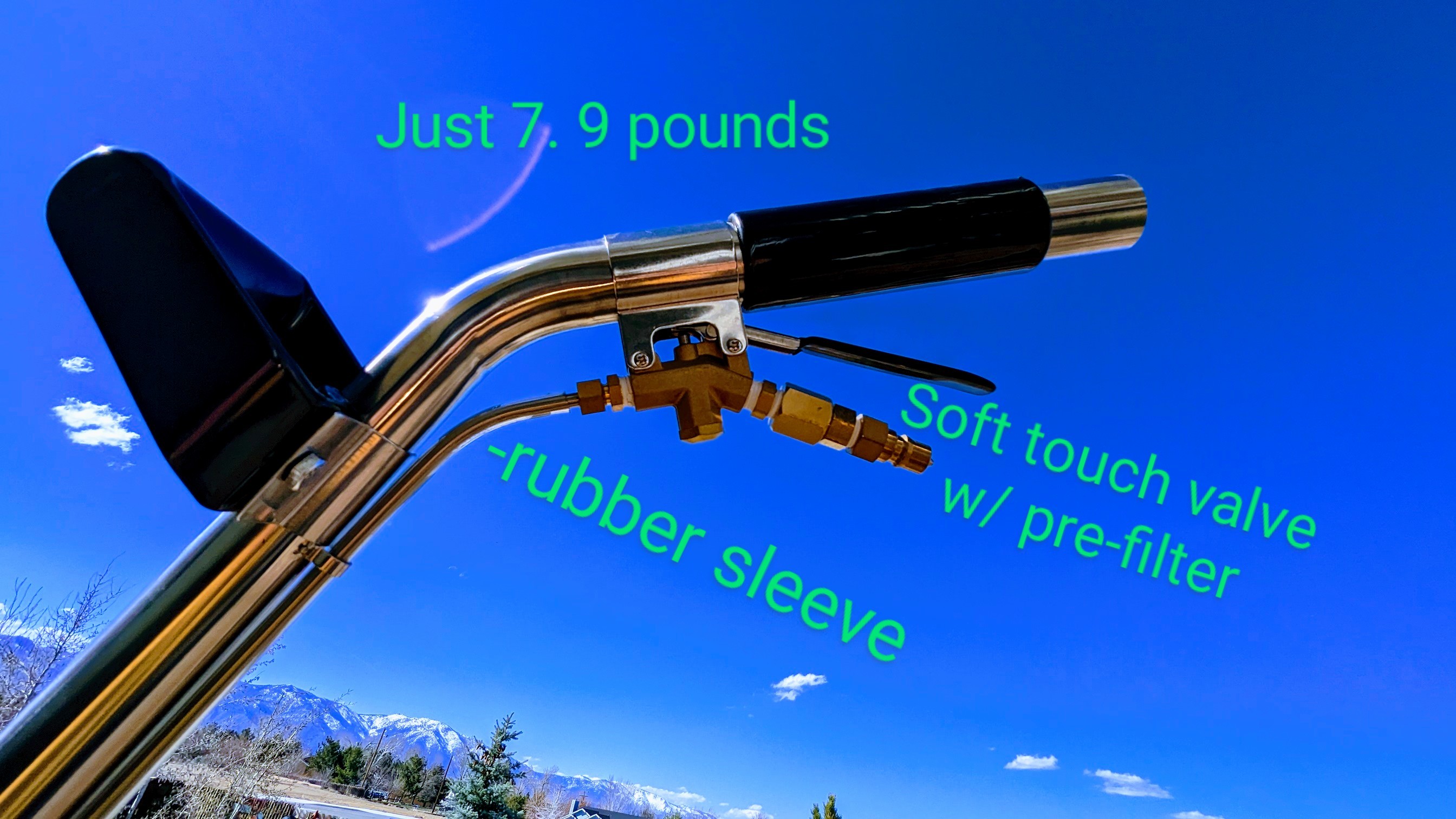

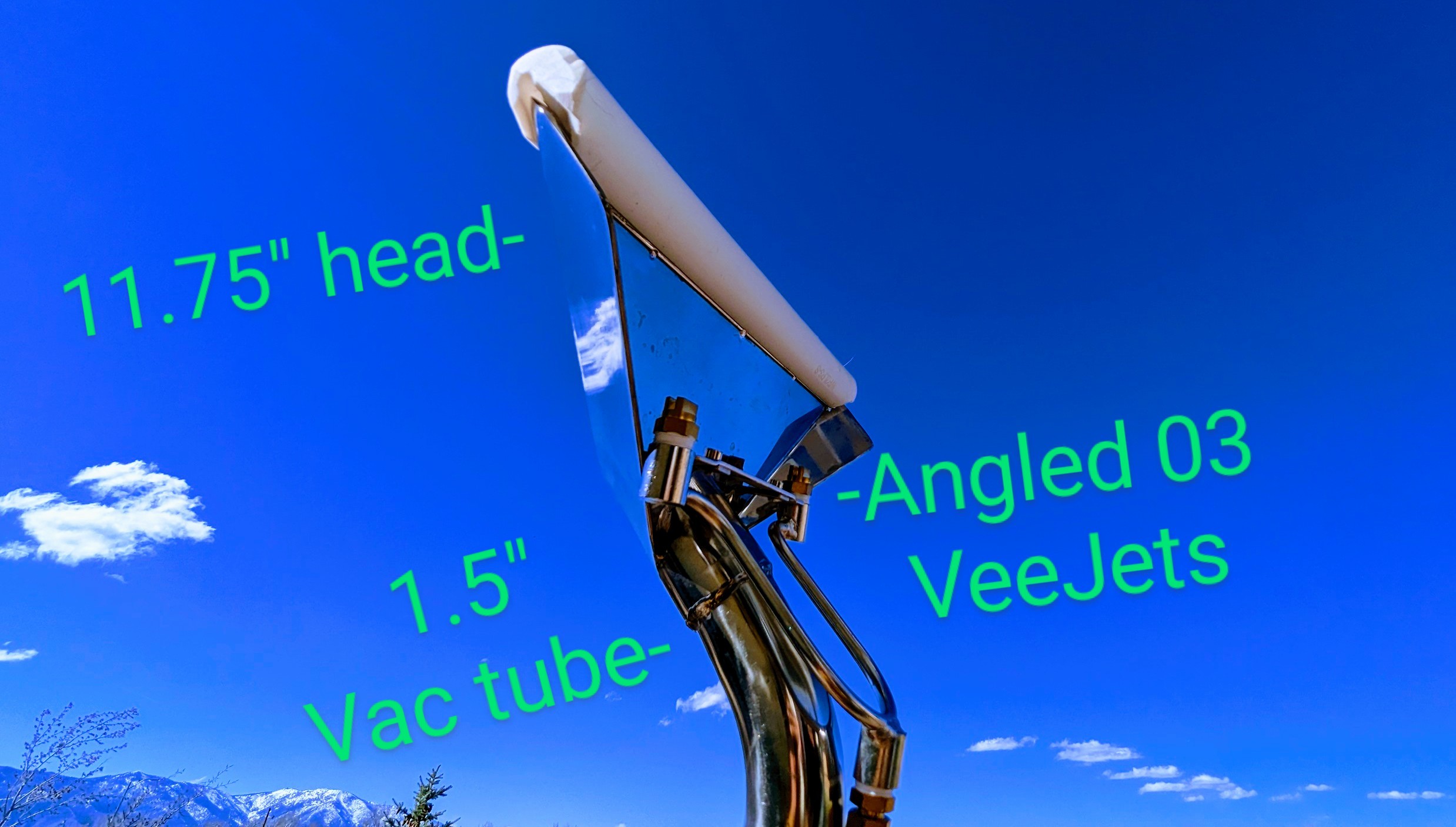

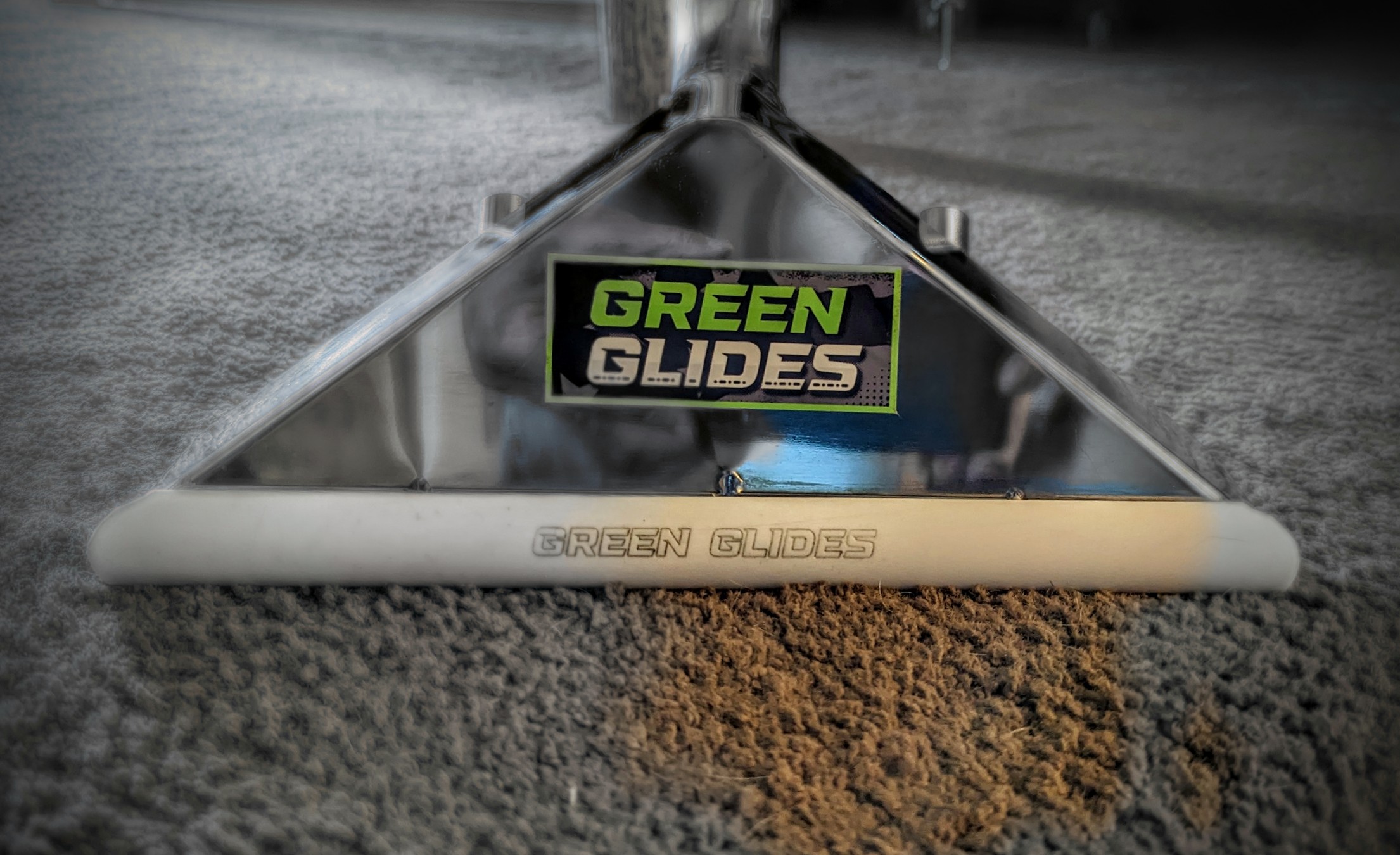

I can't wait to go clean carpet tomorrow with my new wand!

You know I’m a wand hoe, but are there any advantages over my SS12?
1. you can step down to four flow, if you are at 6 on the SS and get the same performance and better dry times.
2. no over spray
3. heavier, but not too heavy so nicer on some pile types
4. triangle shape has it's advantages.
5. no cuff adaptor needed if you use a whip
6. shinier
7. less jets to maintain
SS12 positives
1. much lighter.
2. sic @$$ Glide swapping
3. Hard Surface Glide
4. lower head in the center

I didn’t think about the flow thing. At 4 flow, the droplet size from bigger jets likely cancels out the extra flow advantage from 6 flow.

Well I was very surprised that in my version of God's country yesterday on that thick filthy carpet how quick it was drying was six flow at 400 PSI but I still plan on dropping it down to four

Too light
exactly. That is another point on the pcqj being my choice. Since all carpet I clean is on the ground, having some weight to it gives it better agitation, and dry time. With the glide helping it slide around it is perfect. Besides bringing it into the job once on site, it is all about gravity to help bring it back down to the truck. Thankfully in this business its all on the floor. Let the weight be your helper.

I agree. Except that little 11"er. 2 more inches (pcti) will help you enjoy your job even more
