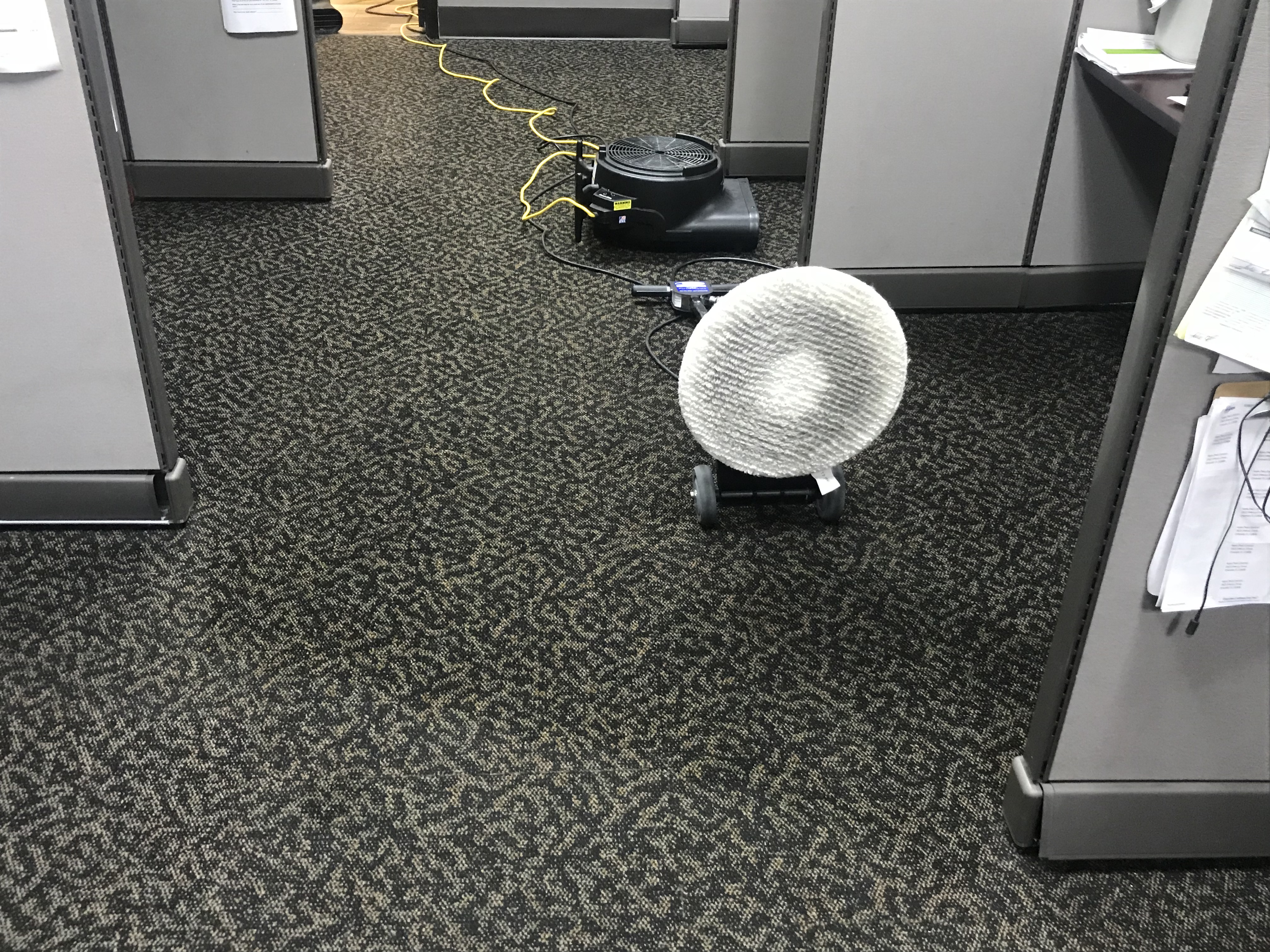

Cleaned a library a couple weeks ago. Both vans and a buffer.
Some areas got flushed and encapped.
28,275
I did a community college in February. All cgd with lots of coffee and beverage stains. Just to see how it would compare, I Cimexed the first third only. Used the truck mount on the rest and combining them in the heavily soiled lobby. Using the Cimex as a scrubber, then flushing. Everything came out clean. The first third that I cimexed, I used Harvard Oxy Encap. All the stains disappeared and the carpet looked as clean as the areas I used the truck mount. Inspecting the following week, it still looked clean.

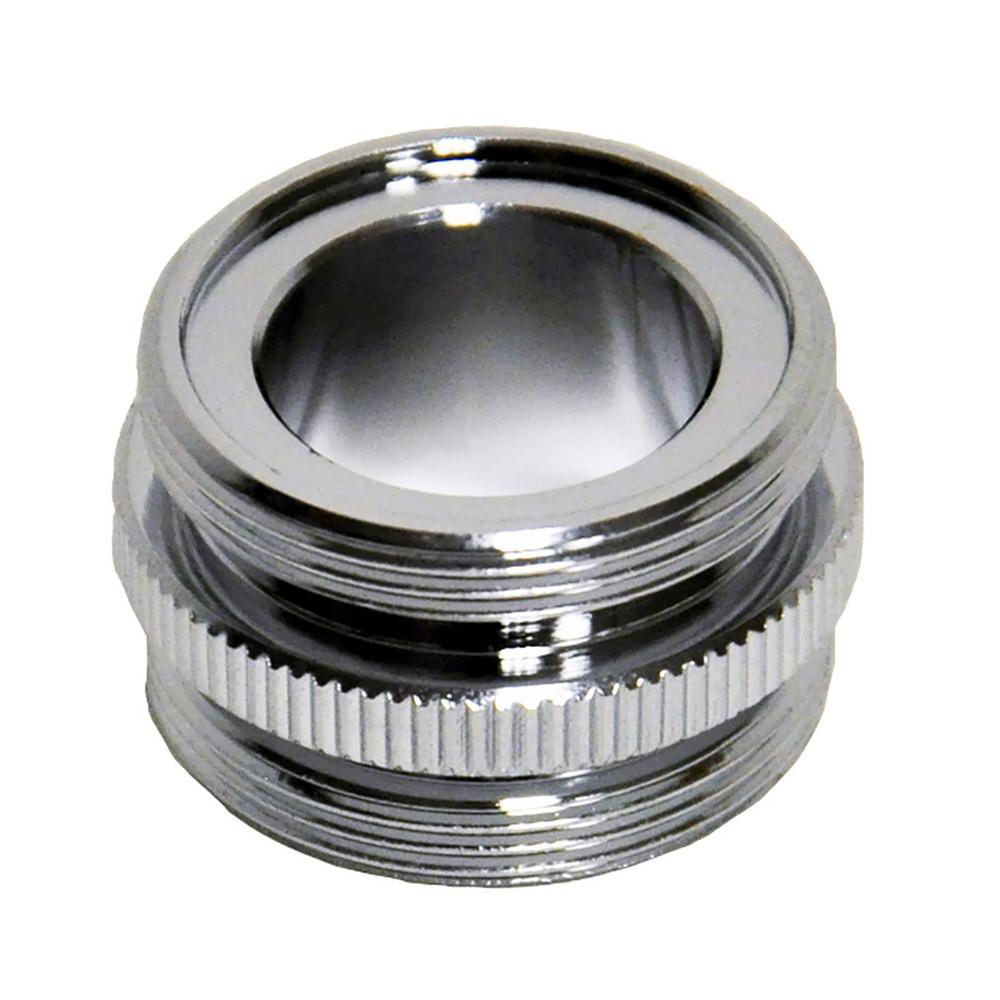

no laundry room in the apts?
you don't have a faucet adapter?
This one adapter covers 97.23333333333% of res
and 94.86666666% of com
lta
Sometimes i reach my bullshit jumping through hoops limit.
No keys to locked laundry rooms, no manager, second floor, parking sucks. Tenants are idiots and not asking them anything if i can avoid it.
