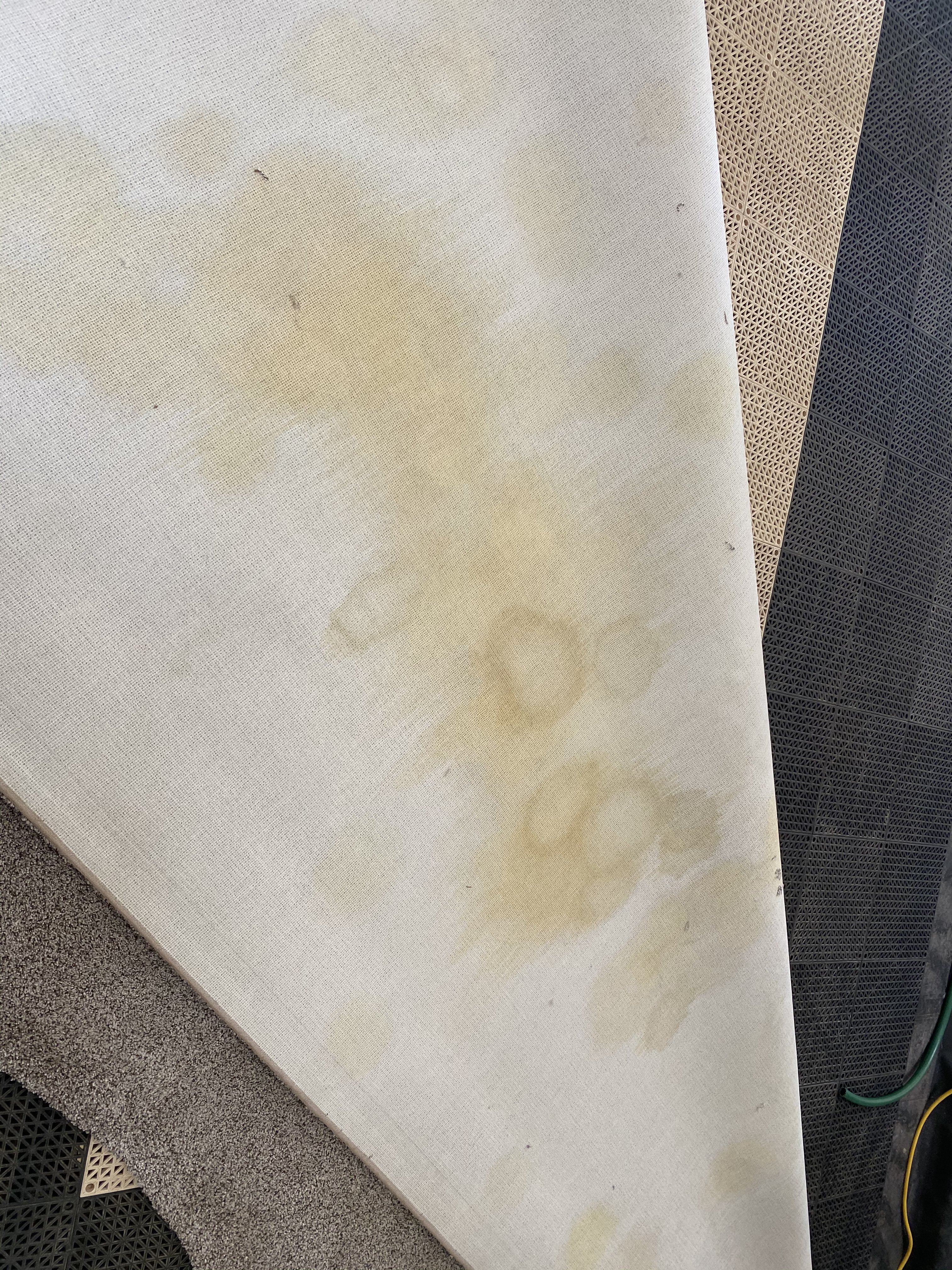

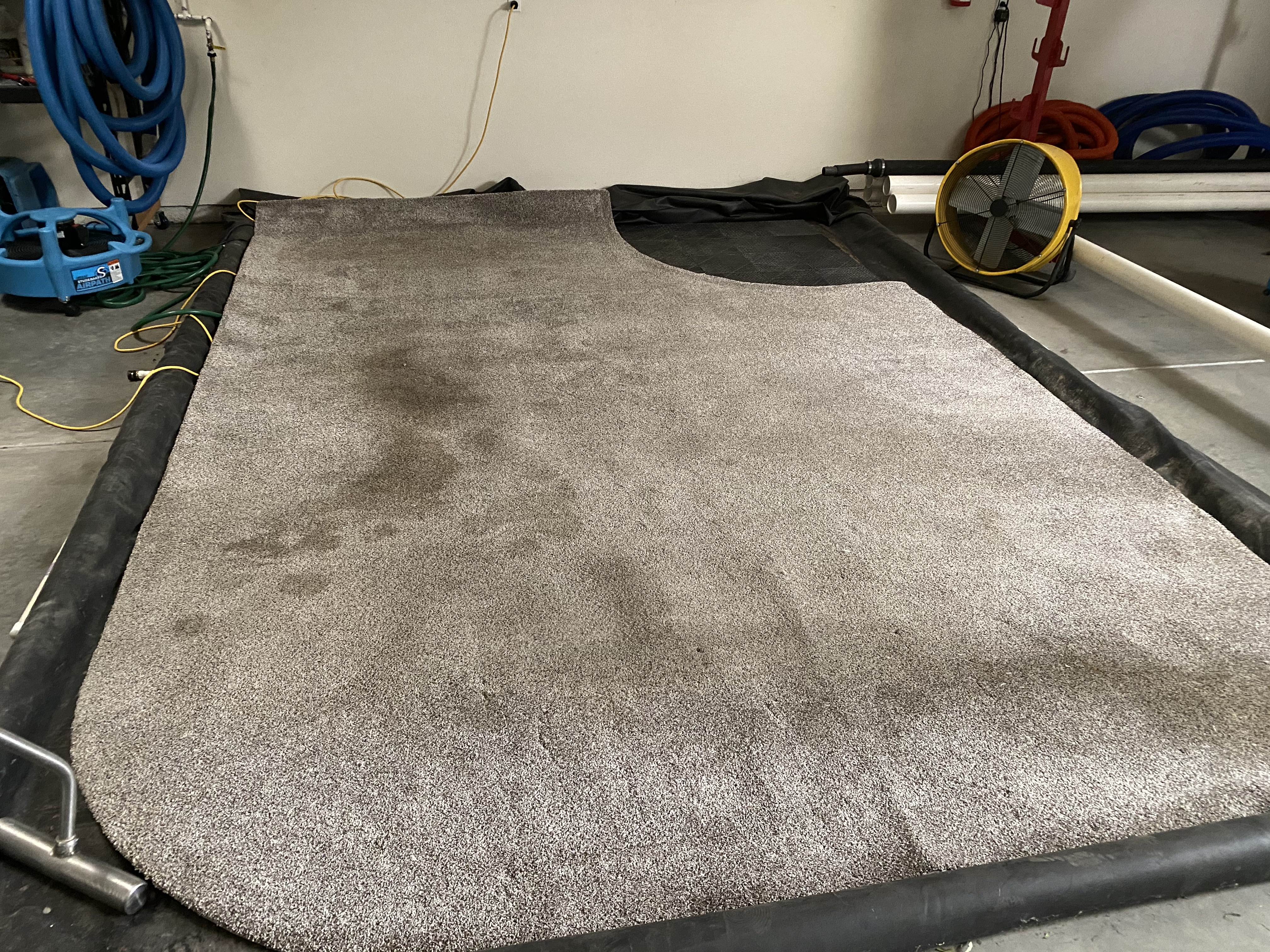

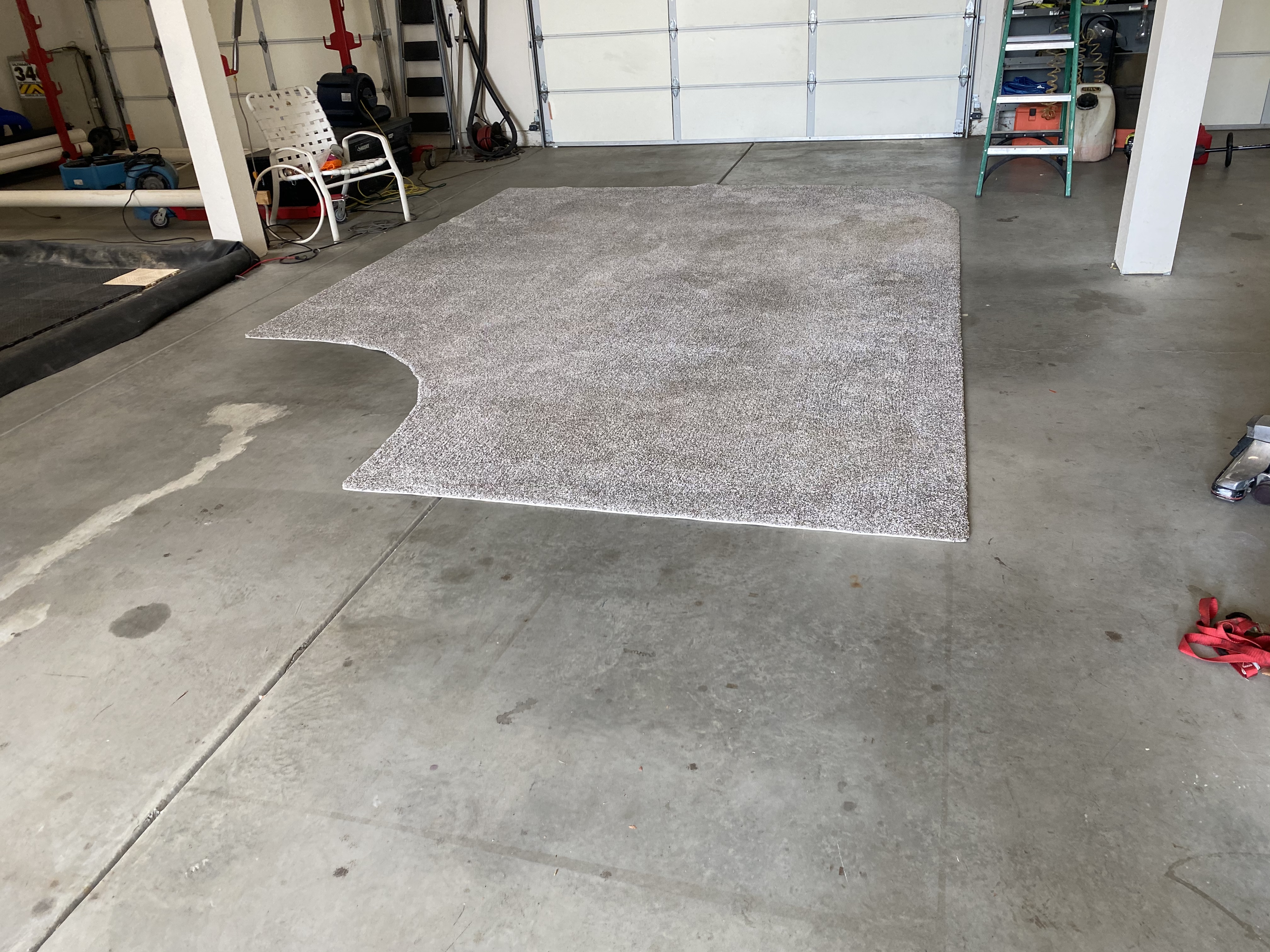

Ugh. Damn this urine soaked rug. Coming out better. Heading back to the shop for a final check.
E92E416B-26C5-41BF-B106-00CA51487BB6.jpeg A528ED44-1E3C-40EE-96CC-E87660B99BE0.jpeg
