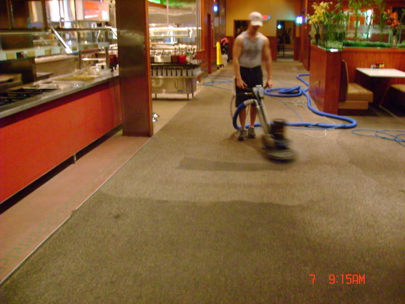

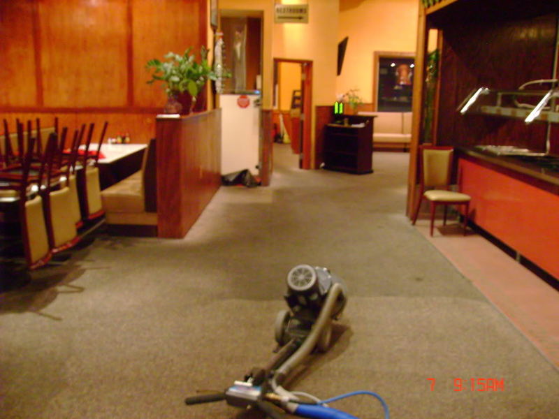

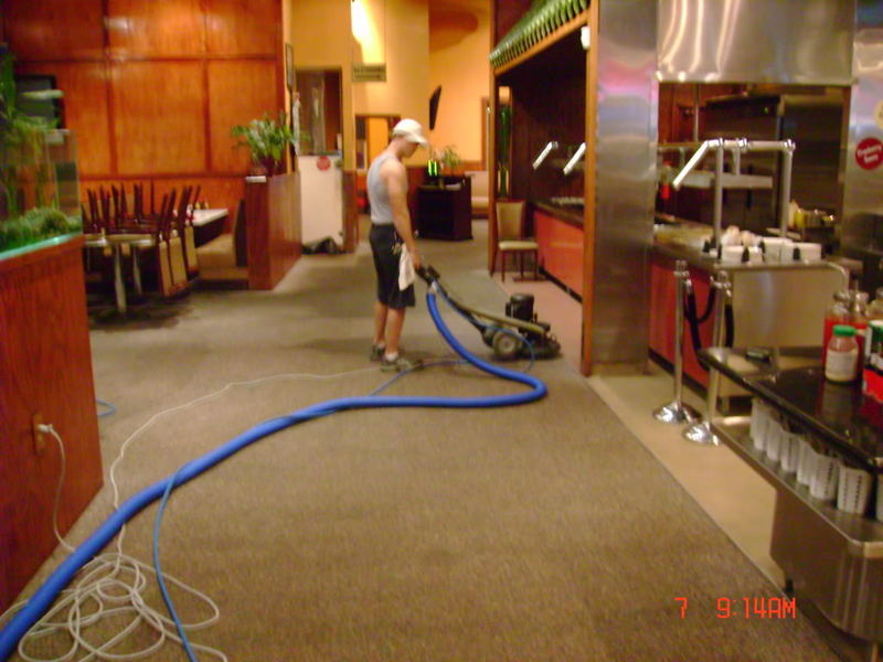

I have no clue why anyone would install olefin carpet in a grease laden restaurant. I have to clean this carpet with the RX or it streaks really bad. I modified my want and that helped a lot, but it is still not perfect. The RX cleans good but is a little slow. I am also tired of doing late night work and baby sitting my helpers. I am hopeful of the day that I can get a wand that is fool-proof so I can give it to my chimps and let them go to town. I think the new Stryker wand will help me speed up production, and it appears to flush the carpet pretty good. We will see. I have doubts that any wand will clean this carpet unless it is a rotary tool.

I really never have a problem with streaking except for this one job. Even on residential berber, switching to 110's in the center of my Prochem 4 jet wand made a big difference. I even tried cleaning with the wand and post padding and I could still see streaks so I just use the RX now. I wouldn't mind using the stryker wand. I wish they would get it finished.
