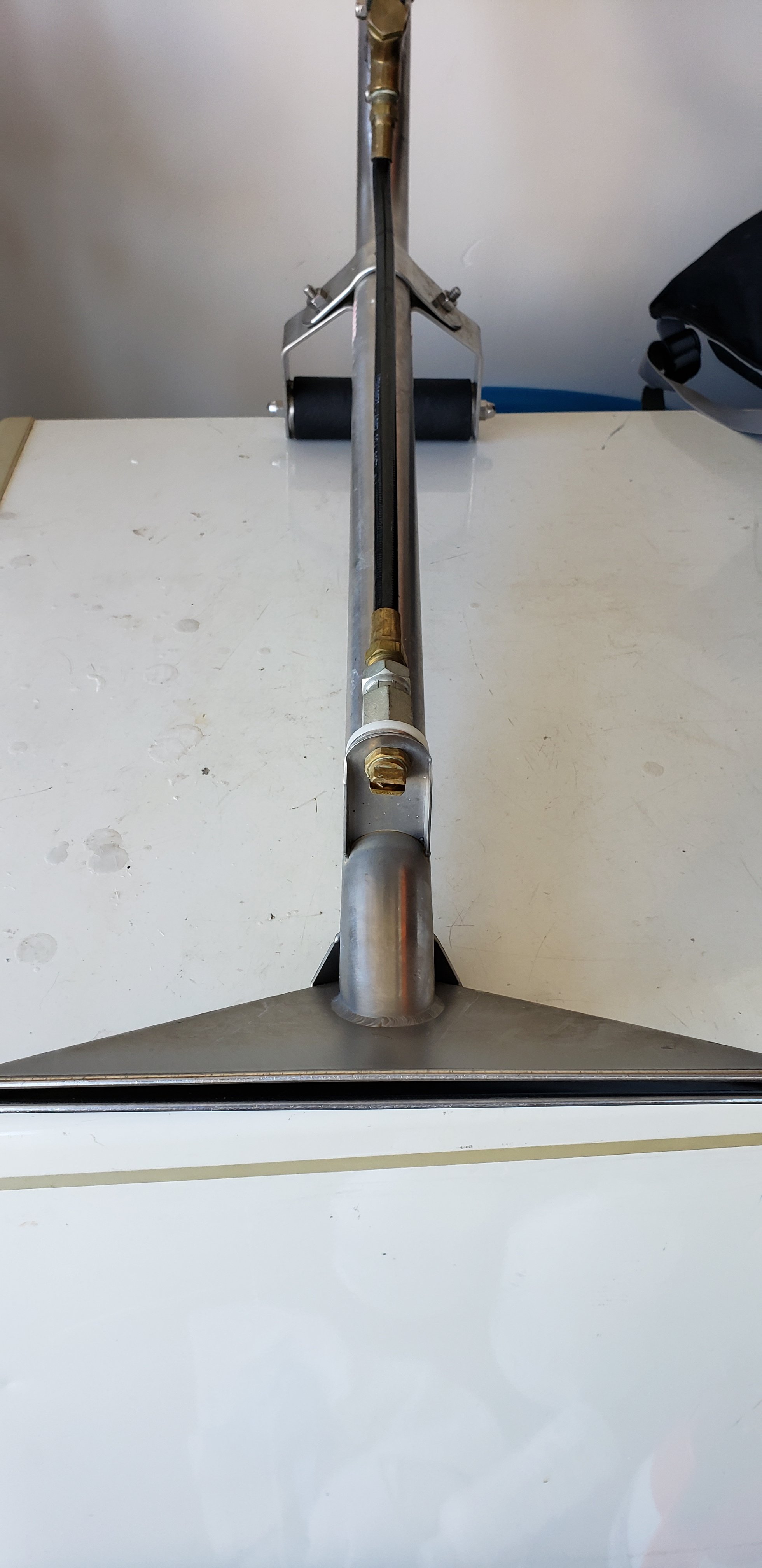

I want to extend this jet.
Oct 25, 2016
3,160
Montana
Swani
Can someone tell me the best way? 8946889470

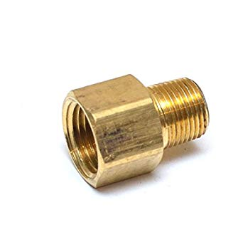

with something like this
89472
should be able find then at HD in the brass fitting section of plumbing
stack two or three for whatever length you want
You'll also need a wider angle jet.
How wide will be contingent on how much you extend
If not aware, Nick, the first numbers on the jet are the degree angle (80, 95, 110 degree, etc)

Awesome, thanks!
