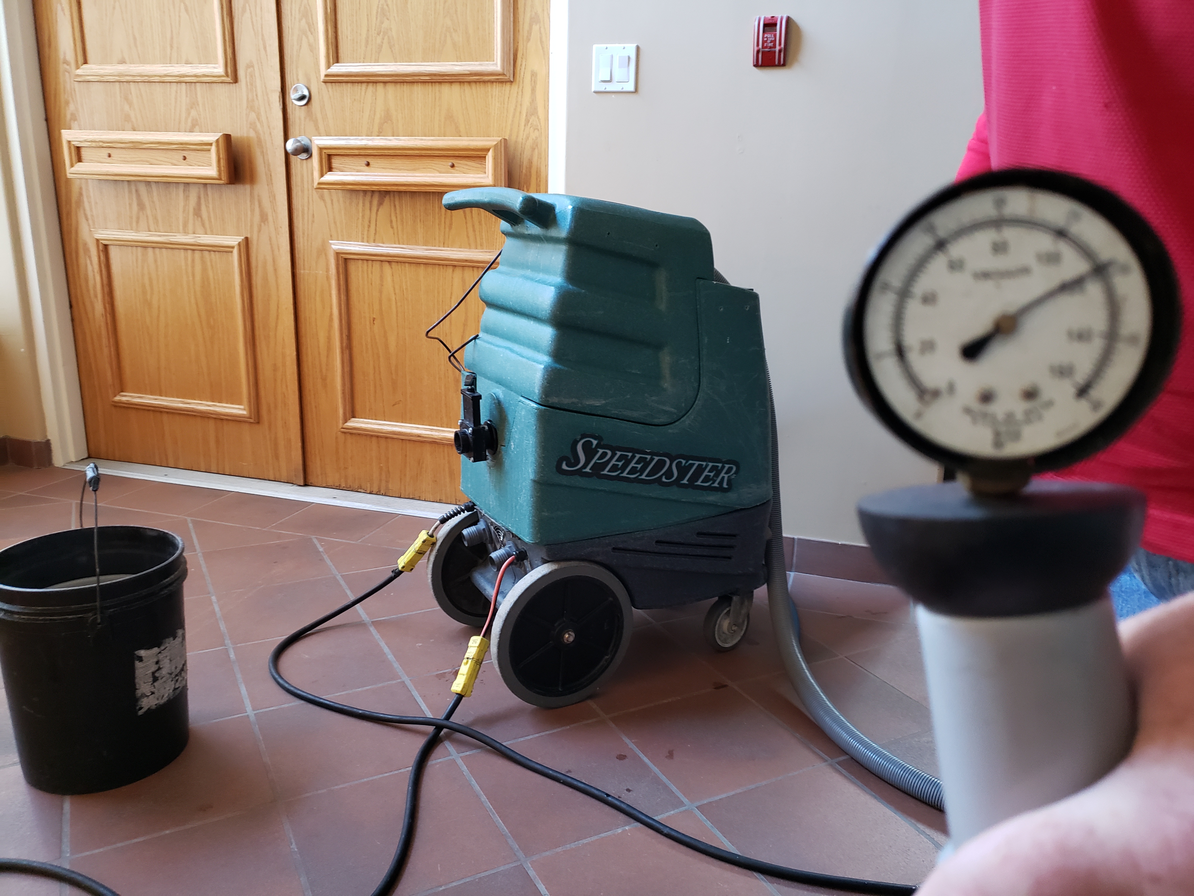

The vacuum off of my old Mytee with simple 5.7 motors running in parallel show I'm getting 120 inches of lift. Motors are a year and a half old and near the end of the life cycle. This was the results I got through 35 feet of 1.5 inch hose.

I get closer to 135 inches on my speedster. Probably around 180 CFM on 2 inch hose.
