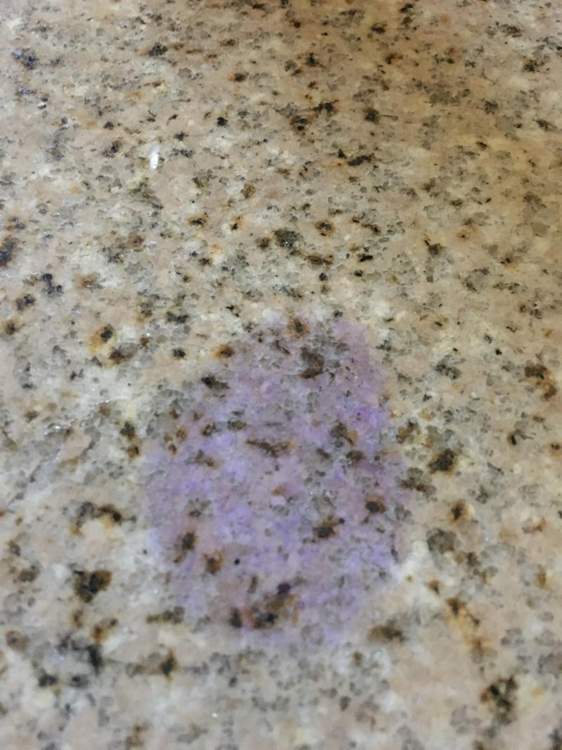

Ink on Granite
Wandslinger
1,006
Simi Valley
Tom Meyer
Custy used some Acetone and lightened it but still not all the way out..Suggestions?
srosen
May 27, 2013
39
waldwick,nj
stuart rosen
Agree with Mikey keep trying-
Dont rub-if the acetone doesnt get it all try below.
Try paper towels folded about 6-8 ply high placed on top of the stain.
Wet the towels with some bleach and let sit for an hour or two-
Should do the trick-if not maybe an overnight poultice of hydrogen peroxide
116,344
Stuart knows..
Try Isopropyl too.
Soak a paper towel in it fold it over the spot and cover with plastic wrap and seal the edges with blue tape
srosen
May 27, 2013
39
waldwick,nj
stuart rosen
Mikey makes a good point-when we first started doing this we chased every stain that came our way.
Some came out some didnt-others were 98.5% and some folks would give us a hard time about our time!
They didn't want to pay-Poulticing is something you do when your onsite for a larger job. If there isn't revenue there teach them for sure-
Bryan Thomson
Jan 6, 2016
123
Phoenix
Bryan Thomson
Agree with Mikey P......isolate isolproply poultice w/ plastic and tell customer to re apply as necessary. Tell customer you'll come by to check progress after a couple of days and then when you arrive to check book cleaning of T&G , carpet , upholstery... I'll bet you get an easy good paying job just because you " paid it forward" by not charging them to fix their major stain of a expensive surface like granite.
J Scott W
Oct 16, 2006
4,061
Shelbyville TN
Jeffrey Scott Warrington
Wet the area with StainZONE. Cover with Stain Absorb with stone for a poultice.
The professionally formulated version works a bit better than the Heloise methods mentioned above.
Reactions: Bruce Humphrey
dgardner
Apr 7, 2008
5,109
Phoenix, AZ
Dan Gardner
Scott, would the professional products lock you into making the trips out there to apply, or would you sell/give them the products?
Feb 5, 2013
527
Southern California
cameron demille
Ink = Hydrogen Peroxide. Every time.
you have to be careful with ink stains and solvents, you can actually dilute them and carry them deeper into the stone.
J Scott W
Oct 16, 2006
4,061
Shelbyville TN
When reasonable, I prefer to apply the products rather than trust a home-owner to do it right. I may ask them to wait a day or two and then sweep up the dried powder. But considering the customers and the price charged for cleaning granite, I want them to know I am the expert. Don't give them ideas to try and clean it themselves with something off the shelf.
Reactions: dgardner
