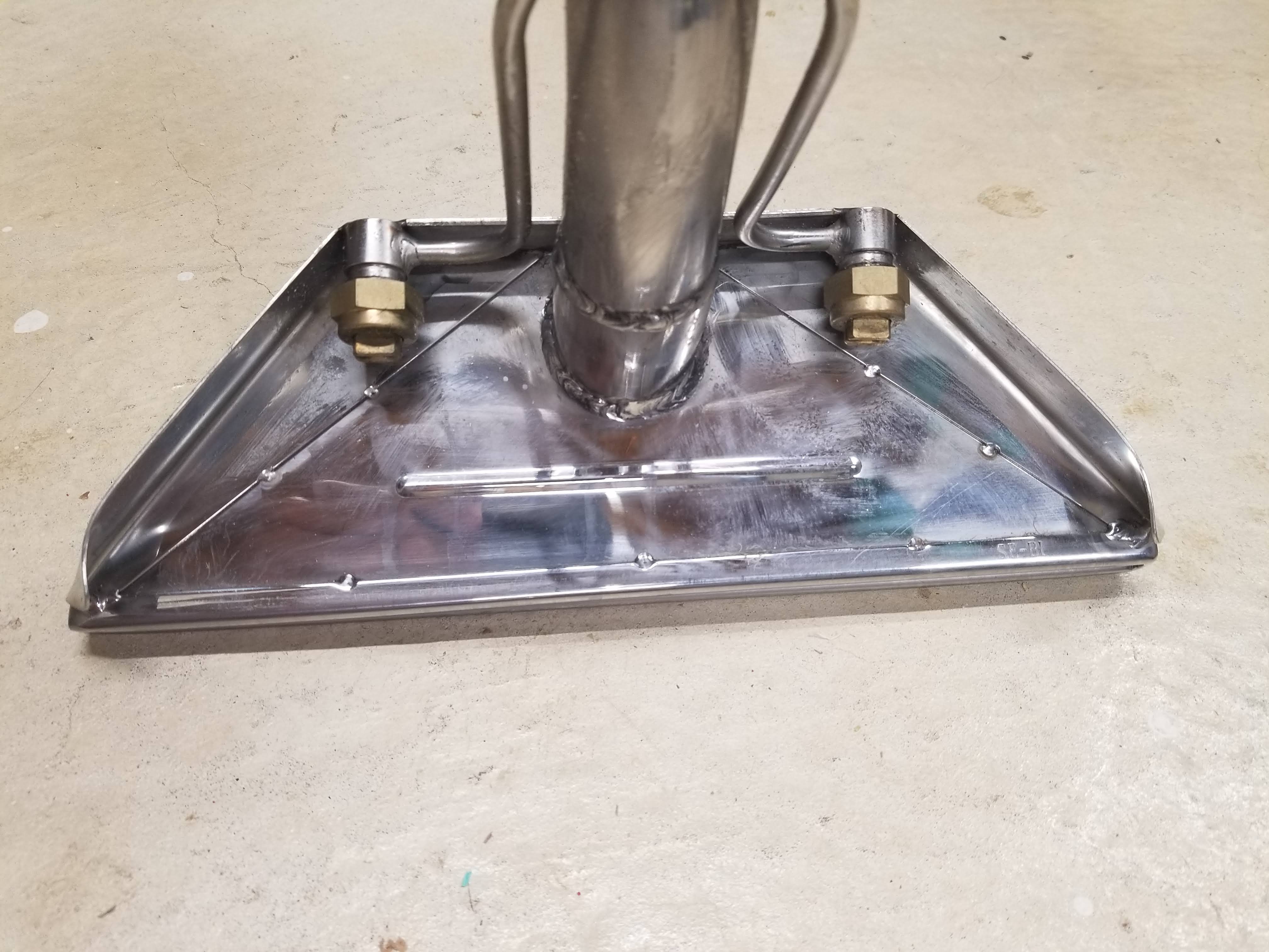

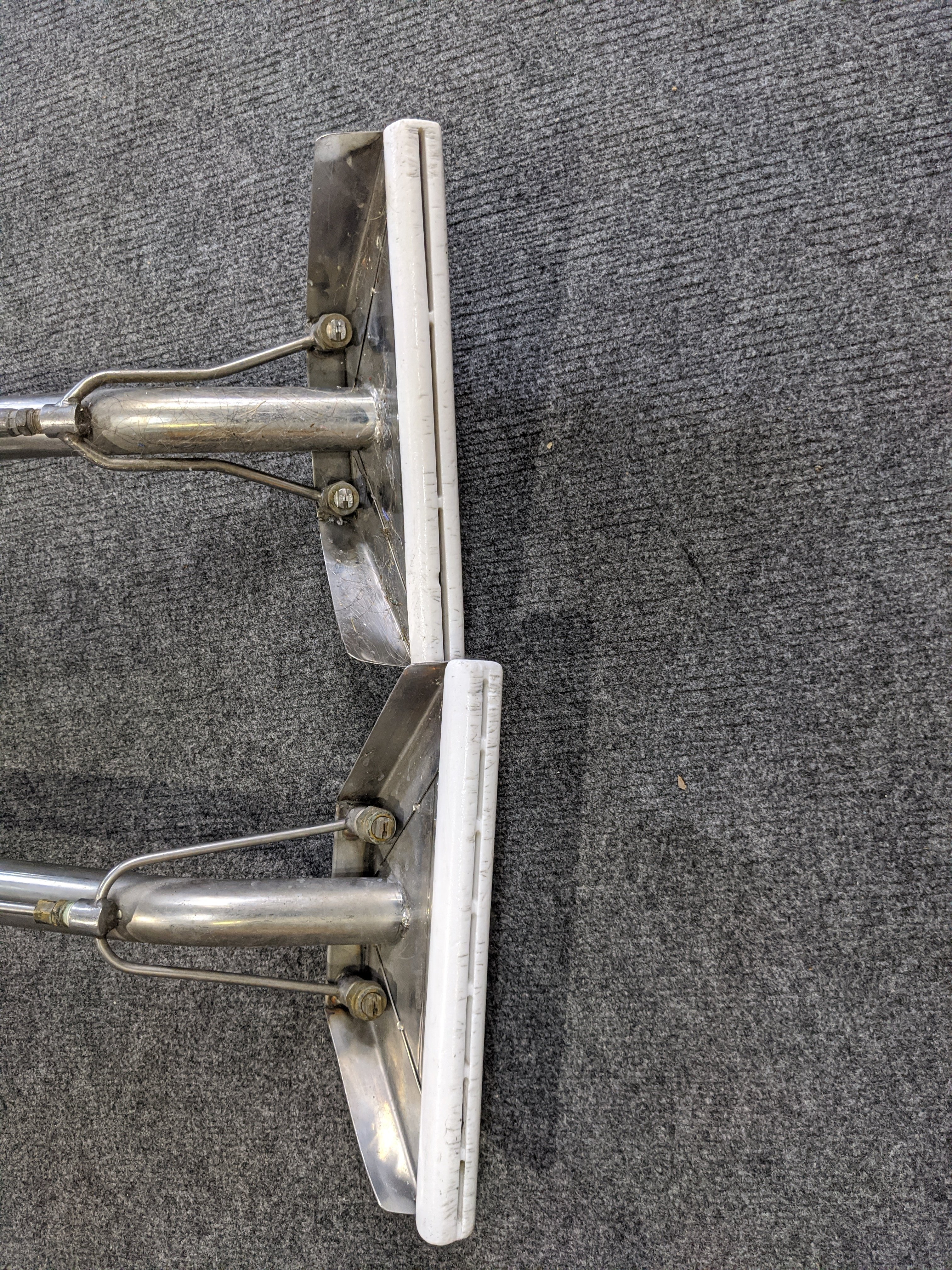

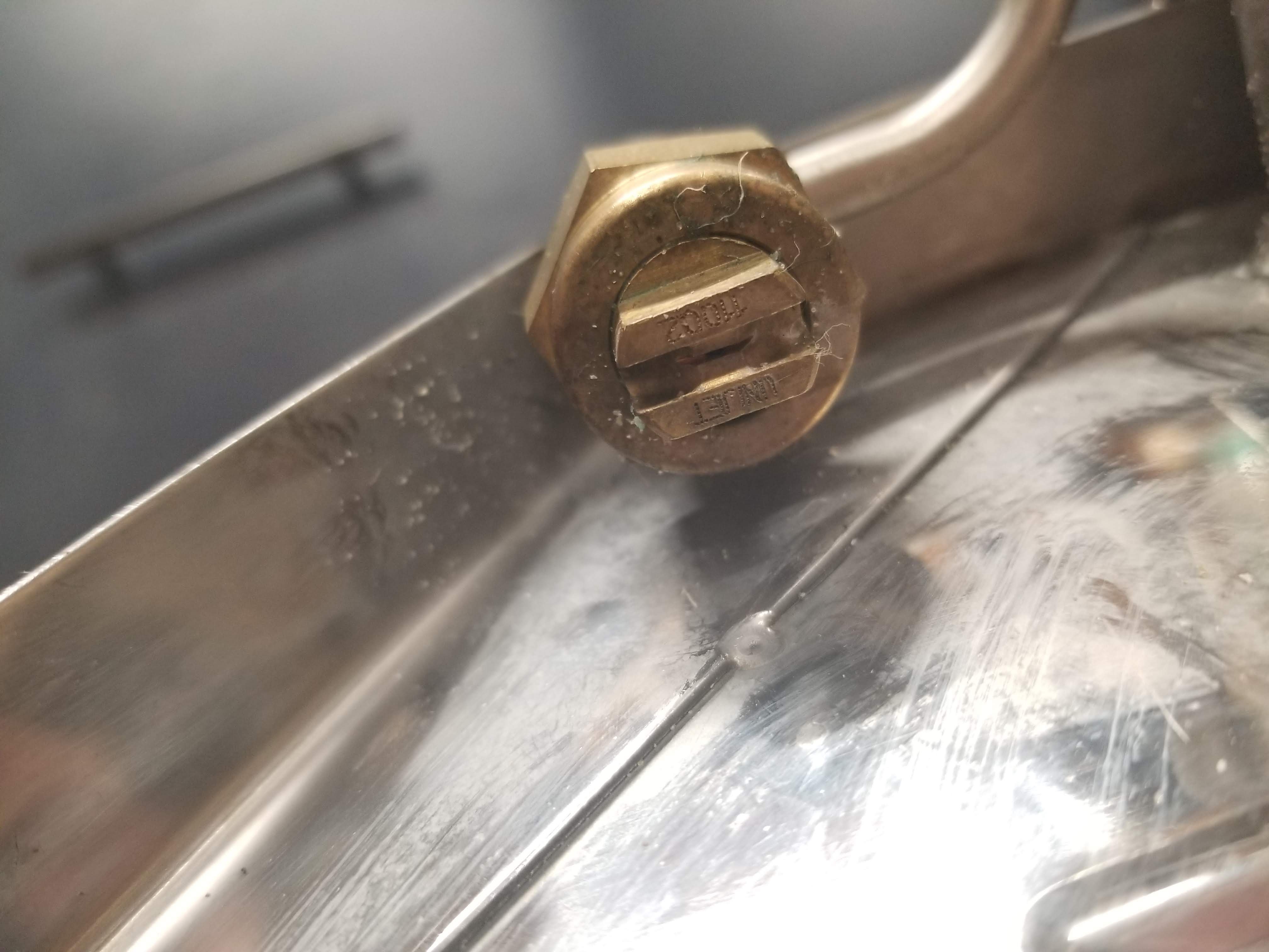

What specifically? jet type or the whole back of the head?
S
soundguy7440
I grabbed both

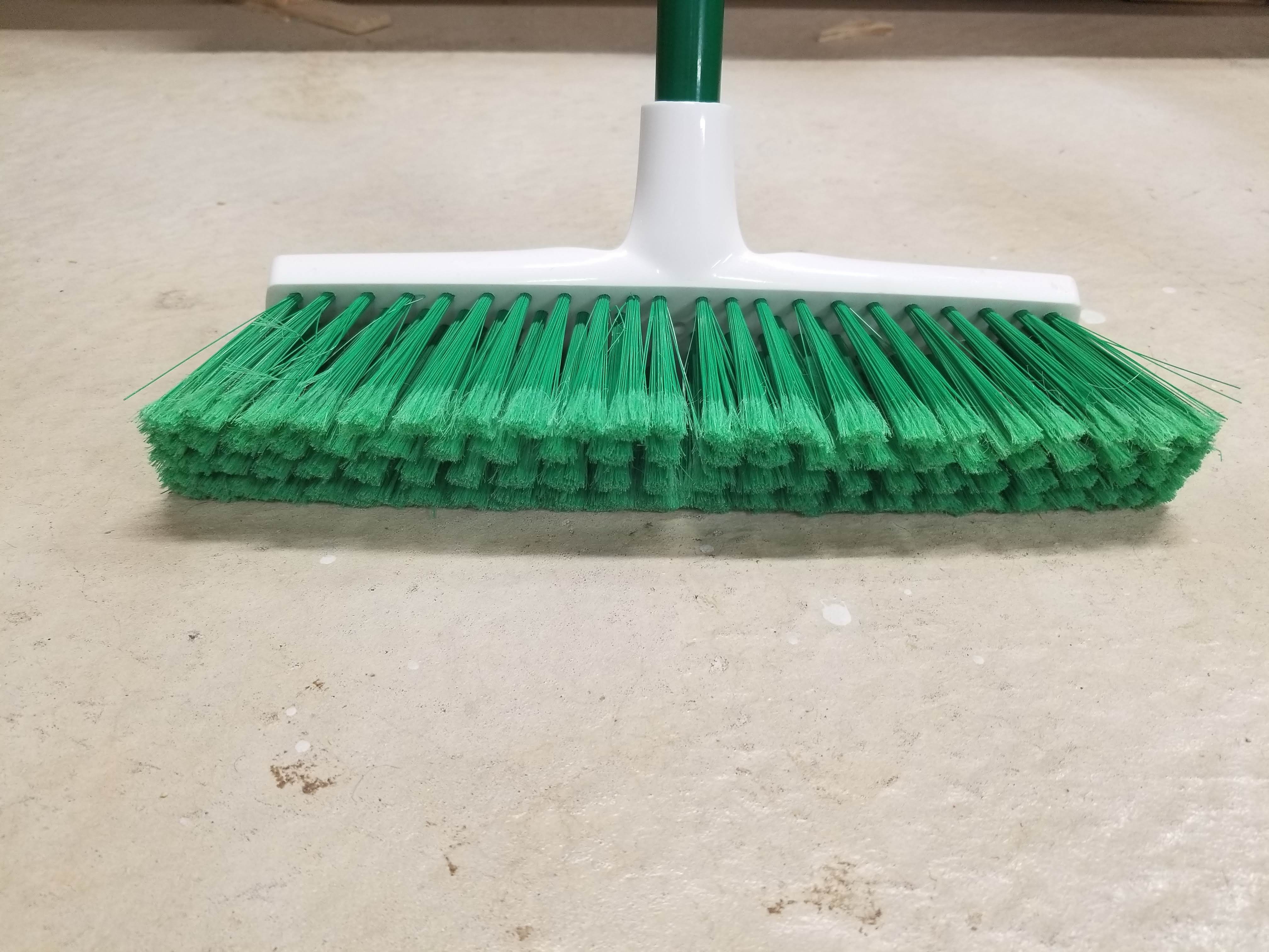

What do you mean by a soft bristle brush? can you post a picture of that?
I've done 2 rooms and a hallway in my house (and one of the rooms a second time because it browned a little :() and a buddies apartment. both were definitely close to 3hrs, although the apartment was a little faster because I was doing a ton of dry strokes.
The brush looks like this:

If it's a CMP AW29 we continue to sell those The three or four other knock-offs we don't sell them anymore but we may have them in stock if you can identify it tell us exactly what it is we can check
I just took pictures and measurements and sent it to Lisa. Turns the aw29 from a pos to something quite useable. Especially in tight areas.
