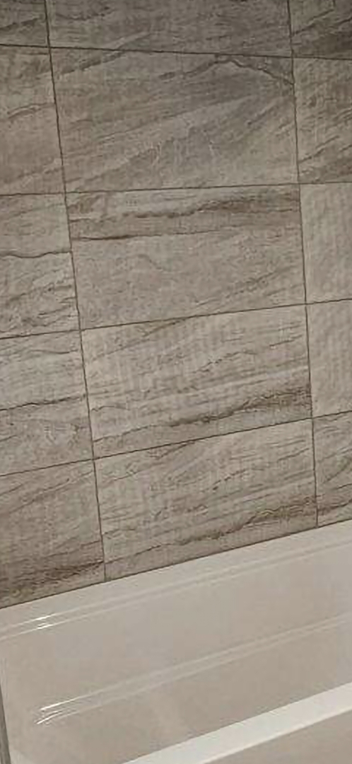

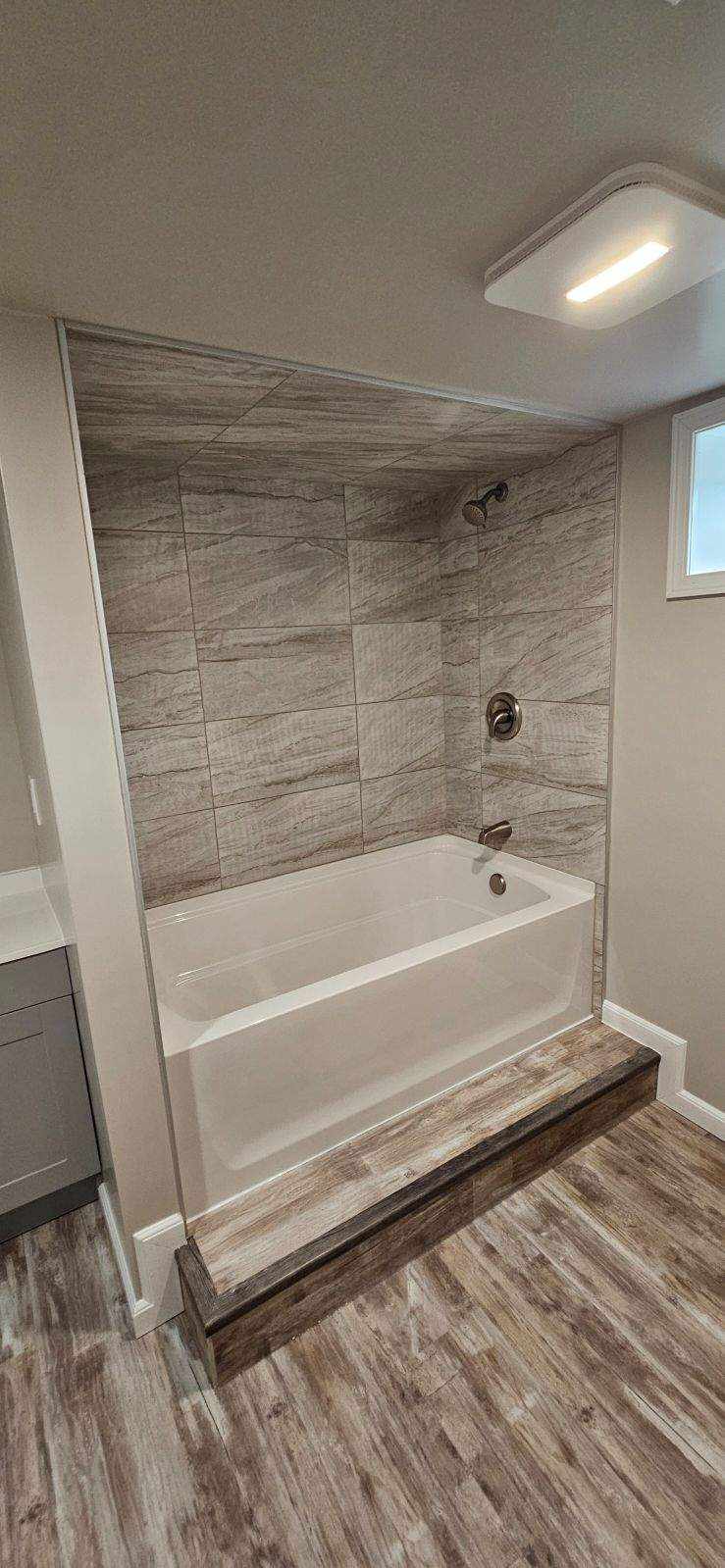

Nov 4, 2024 #1 Mikey P Administrator Joined Oct 6, 2006 Messages 116,045 Location The High Chapperal Homeowner says the lines showed up the day after being installed... Can a notched trowle be used that symmetrically in the real world?
Nov 4, 2024 #3 F FB19087 Guest Yes it can be used that symmetrically because it just gets dragged up/down. Hopefully it will dry out...not an uncommon issue to see adhesives/mortar through tile/grout grouted too soon?
Nov 4, 2024 #4 Mikey P Administrator Joined Oct 6, 2006 Messages 116,045 Location The High Chapperal anon said: Hopefully it will dry out...not an uncommon issue to see adhesives/mortar through tile/grout Click to expand... fairly common with stone, very uncommon with porcelain Reactions: FB19087
