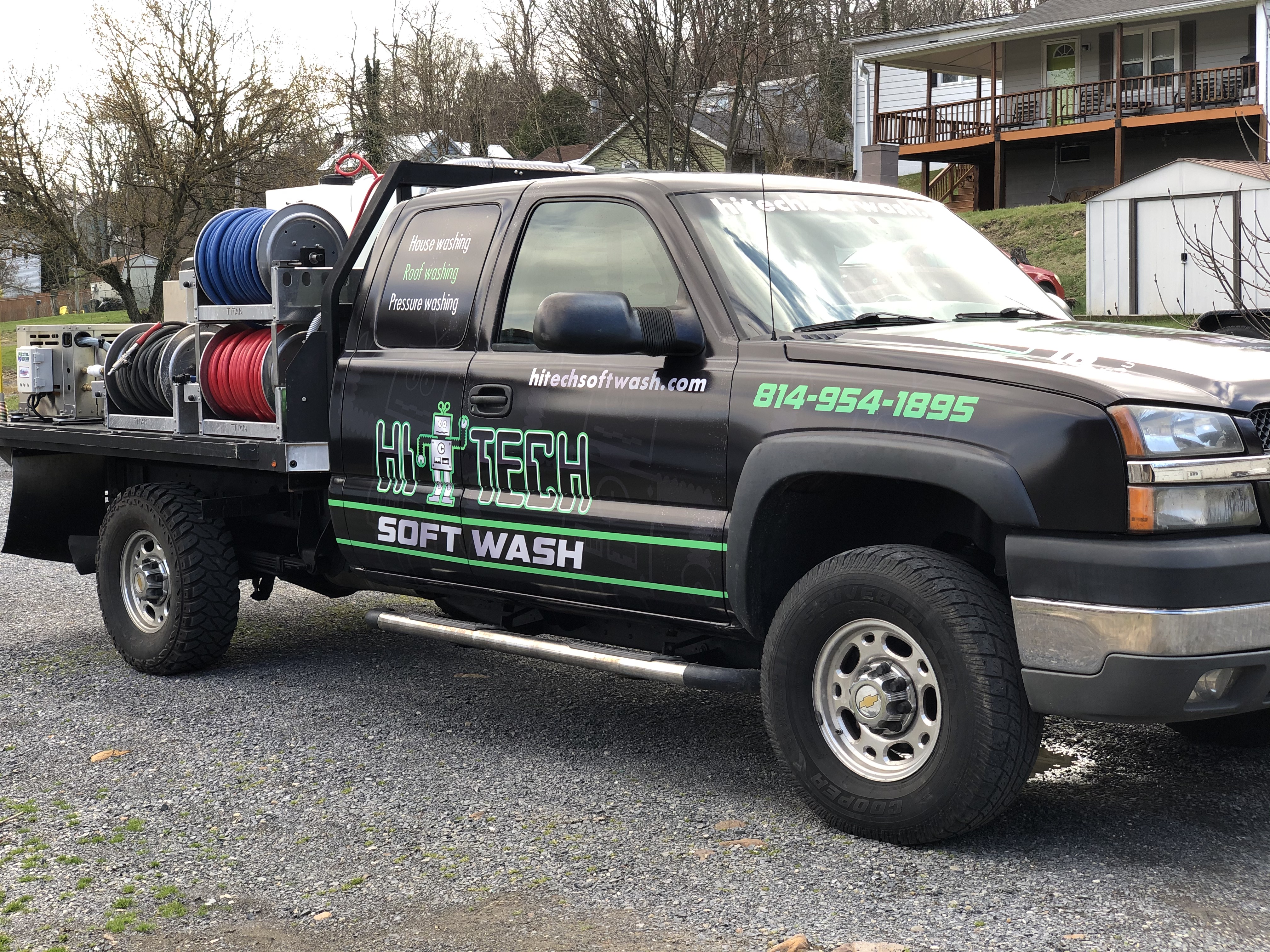

jwfoulk12
Aug 10, 2012
861
Justin Foulk
My Softwash rig
