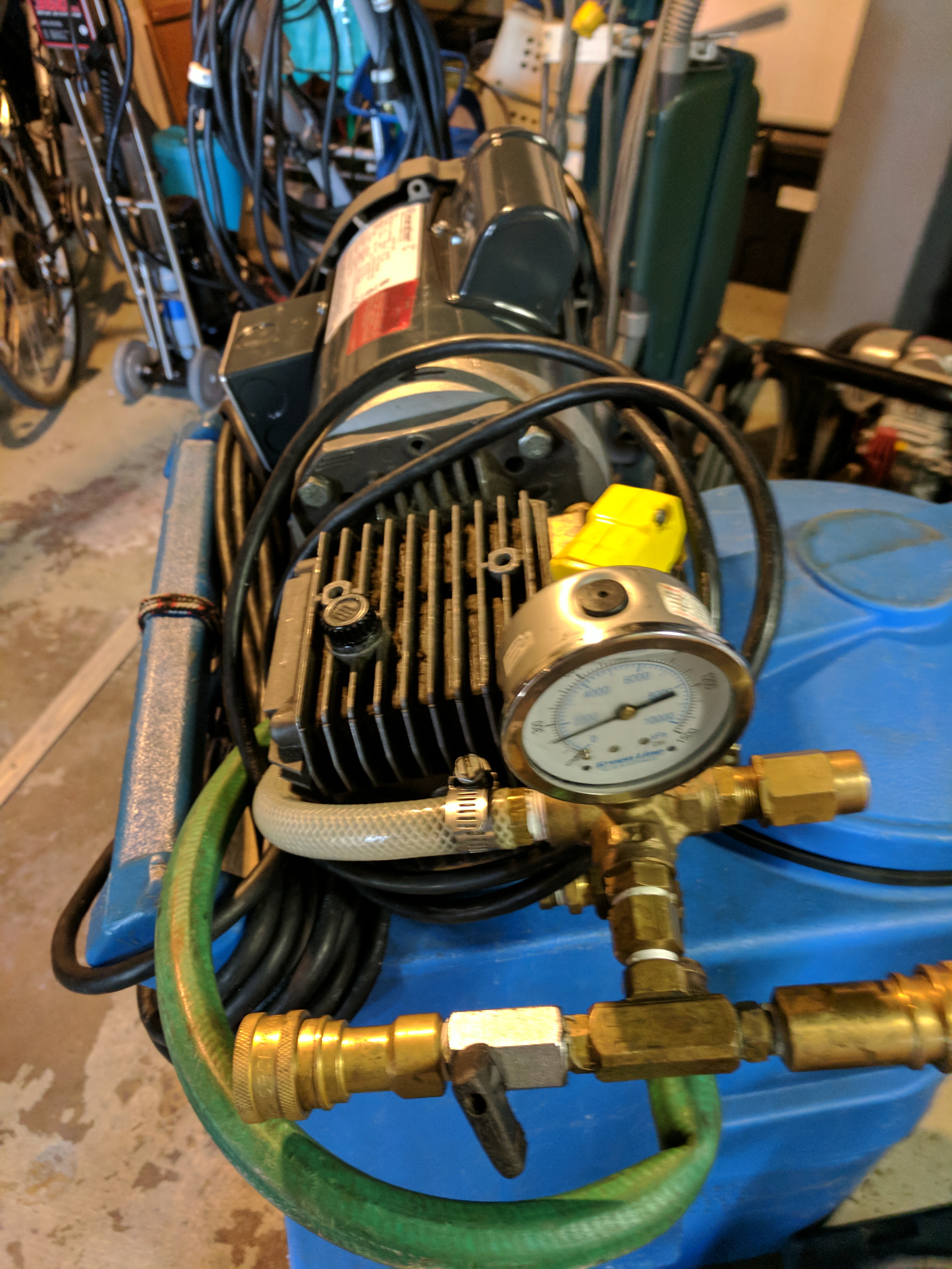

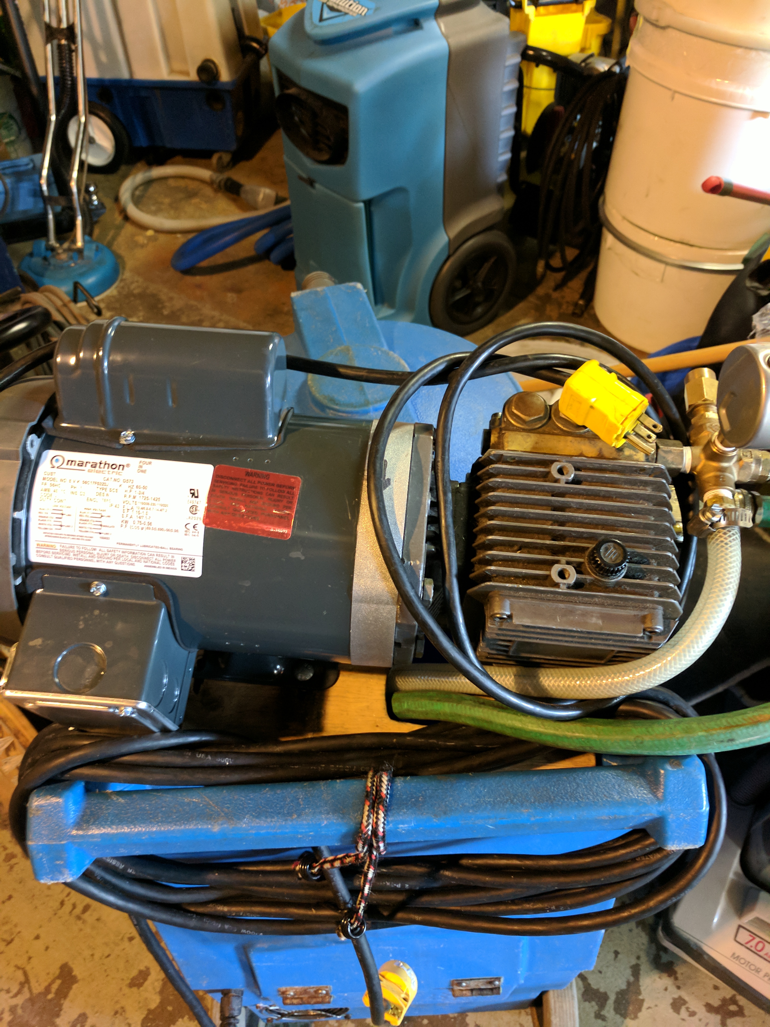

I've never used a water otter. I made my own pump using a 1hp motor and a general pump. Not hard to do. It sits on top of my old ninja and I drop my suction and bypass hoses into the solution tank. Gives me up to 1500 psi. I normally use 1000-1200.

These units work well but are heavy and hard to carry, I like the otter, it's pretty compact and a good backup unit, and great if you have to use a spinner in a high rise with a porty with auto fill, auto pumpout.
