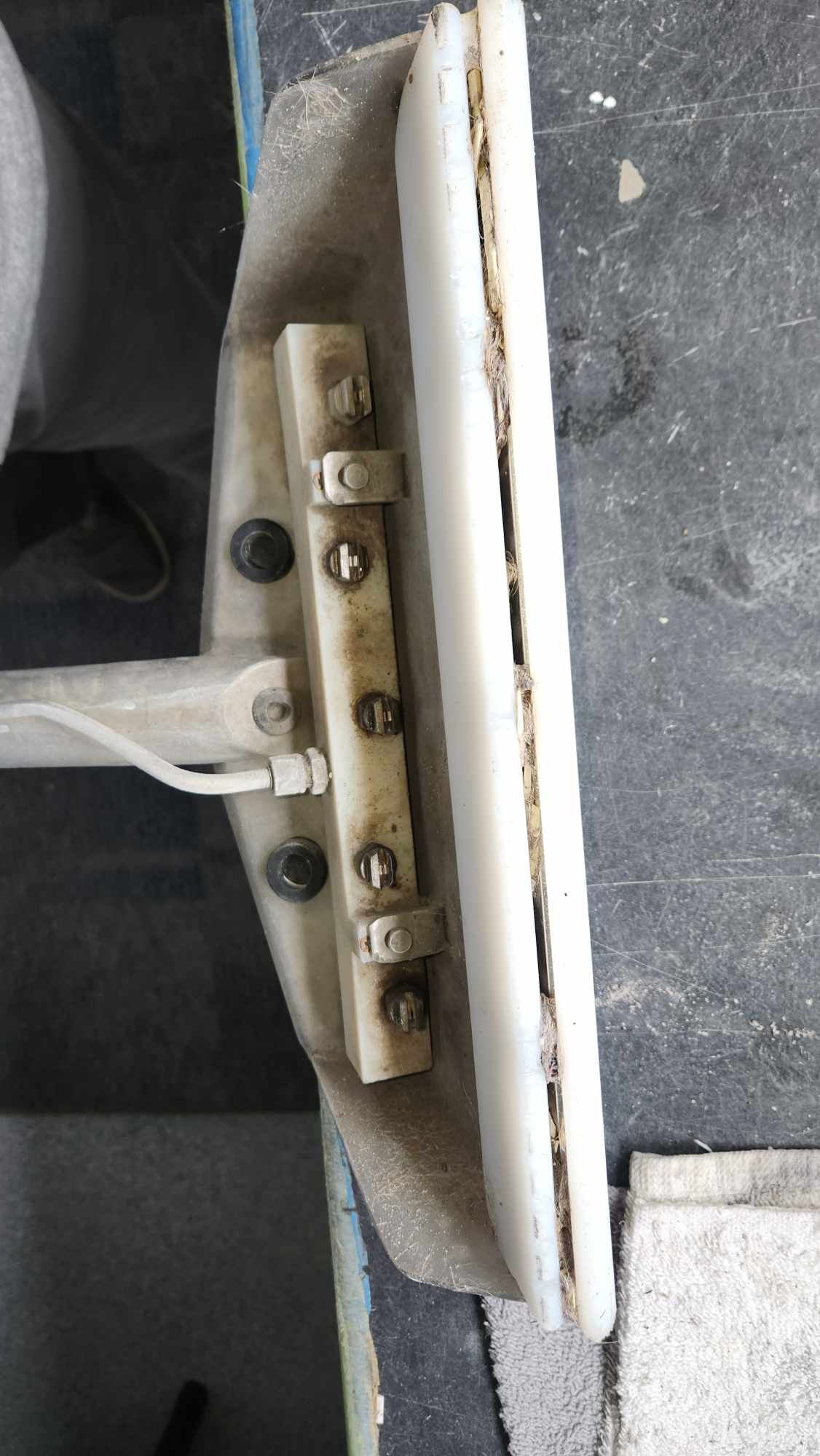

Is westpak the only wand that does this?
14,611
Stagger their jets so we don’t have to angle the spray.
Looks like the “other” wand companies are kinda lazy because my PR TI and other pmf wands never had this

Butler stagger sthem much more
Why doesn't legend do that? Or do they still use pmf to produce their wands? From your pictures of all the goobers that send you pictures of their jacked up wands, you could easily send the big box company your concerns for the price they want for their wands.

Yes PMF makes them.
They are not open to feed back, and due to costs and function, for every PMF wand I move, I sell 20+ Westpaks
Do me a favor time yourself cleaning 200 ft of open space with that 4 jet and then do 200 ft with the 530 at the same moving pace and let me know what the difference is time

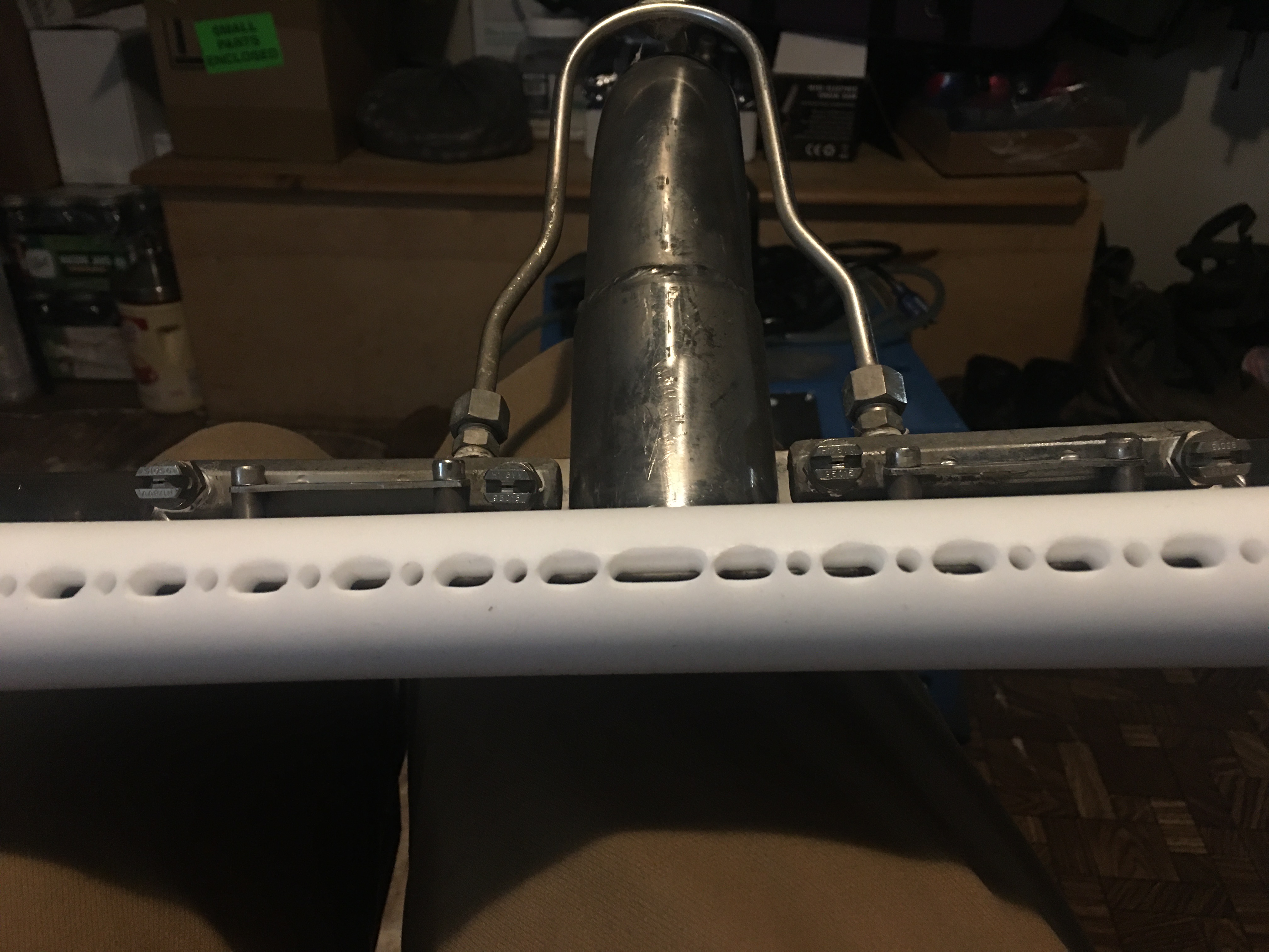

For these 11’x12’ rooms, there was a 2min loss in time with the 11” vs the 14”
14,611
Any visual or dry time differences of note?
Cleaned at a pressure of 500-550 and never got a difference in dry time. I think the 4jet might’ve cleaned a little better
Both wands are set at 6flow. 1.5 jets on 4 jet and 3flow jets on 2jet
I noticed some dark lines from the 2jet wand but it might’ve been just wet lines
