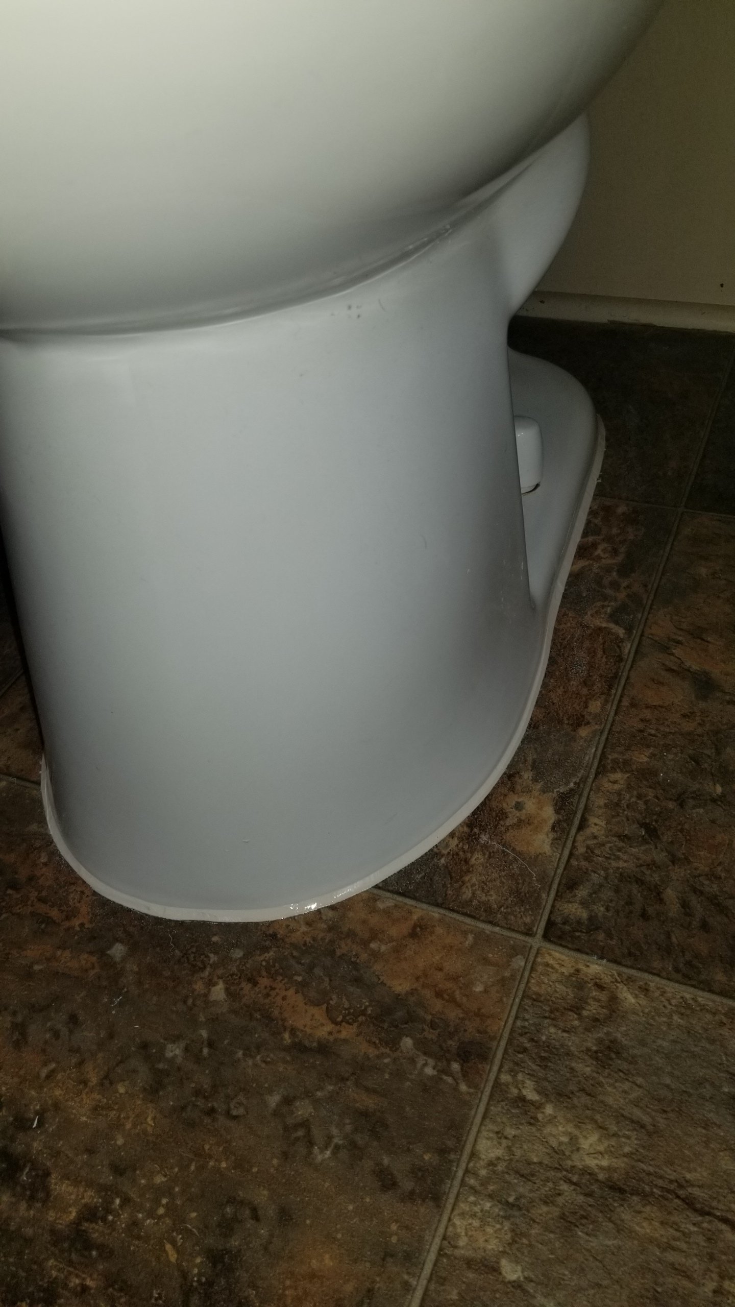

less is more
those stupid things put down waaay too much product
remember, just fill the gap
It was my toilet. I was just testing the the profile tool. I do prefer smaller bead.

Maybe it is because of the way I grew up seeing it but sometimes when I see your jobs I think "that doesn't look right".....ever get any customers like that?
116,056
No but I know what you mean and most people are so used to seeing caulking on both sides of the gap that I tell them up front that I'm only going to fill it then after it dries the next day when I return which is often the case to do more they agree with me that looks absolutely killer and seamless from just a bit of a distance.
Caulkins and silicones fail when people spread them too far onto the walls and tubs as they get thin and they eventually peel back from movement or over cleaning and dirt and debris get behind them and the mold starts and it's all over with.
Only fill the gap.....

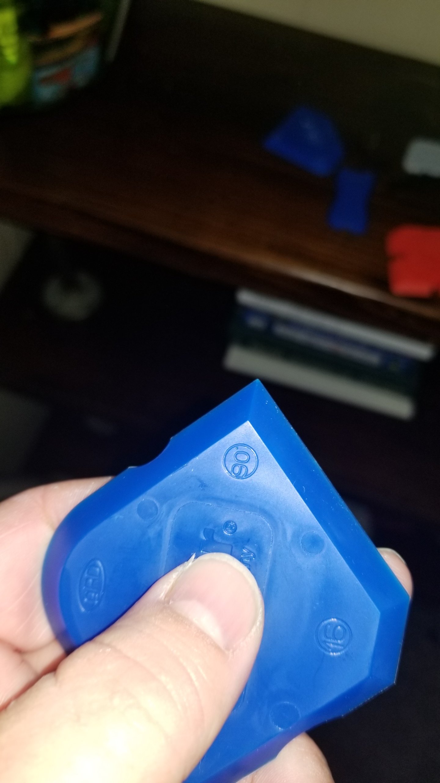

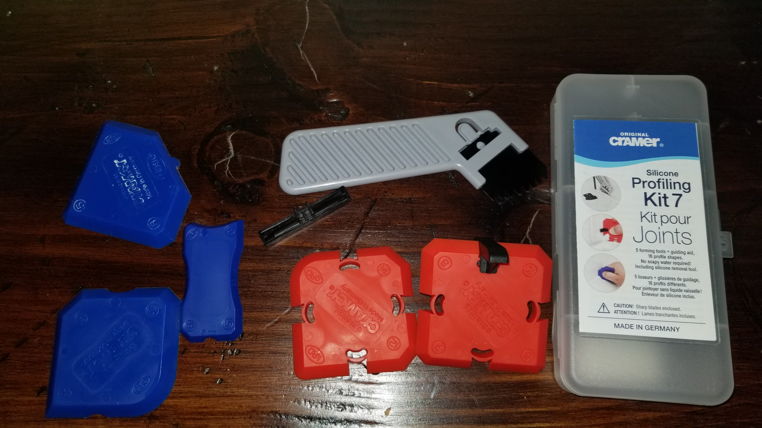

That's what nice about this profile tool. It cleans it up real nice. I agree about bead being too big. It can be pretty unsightly.

Ill be removing it tomorrow to try the 90 degree profile to keep on the edge and fill gap only.

Derek there's no way that tool is not leaving a thin skin I don't know if you are at the demos in Vegas but it takes a tremendous amount of wiping and careful clean up and a headlight to see the slight residue that's left behind when working with silicones and acrylic caulking
caulking is a skill few folks have believe it or not .
Of the dozens of guys I've worked with, only two were good at it
(I ain't one of 'em...I'm "OK" at best...unless I take 14 hours to doit)
Be it countertops, molding or tubs...
the thin skin on sides Mike referred to can also yellow with age
and QUAD caulk for exterior siding and window break metal is the worst (incredibly durable and THE best to use for such)
But it's not spreadable like "regular" silicone and latex caulks
you have to run a bead consistent from the tube
once 'n done

I had a flash light. Yes, no matter what you use, it always leaves a skin. I still had to clean up with towel. But what was nice about this tool, it left behind very little skin up on wall or floor. So clean up was easier.
I was at the demo station. I did a lot of it.
