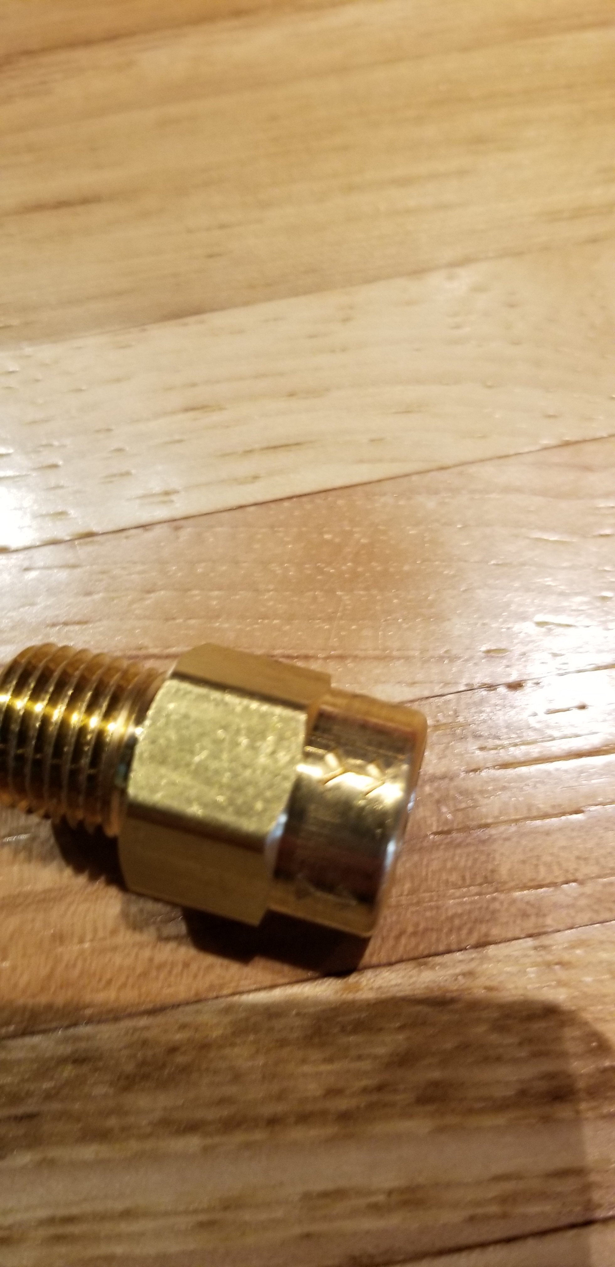

I’m noticing my jets on my sapphire 4 jetted wand is starting to leak...is it time to replace them? Jets have 255 hrs since I bought the wand(same day I bought my truckmount). Also, why does my wand pop as soon as I open up my shutoff valve on my solution line? Thanks.

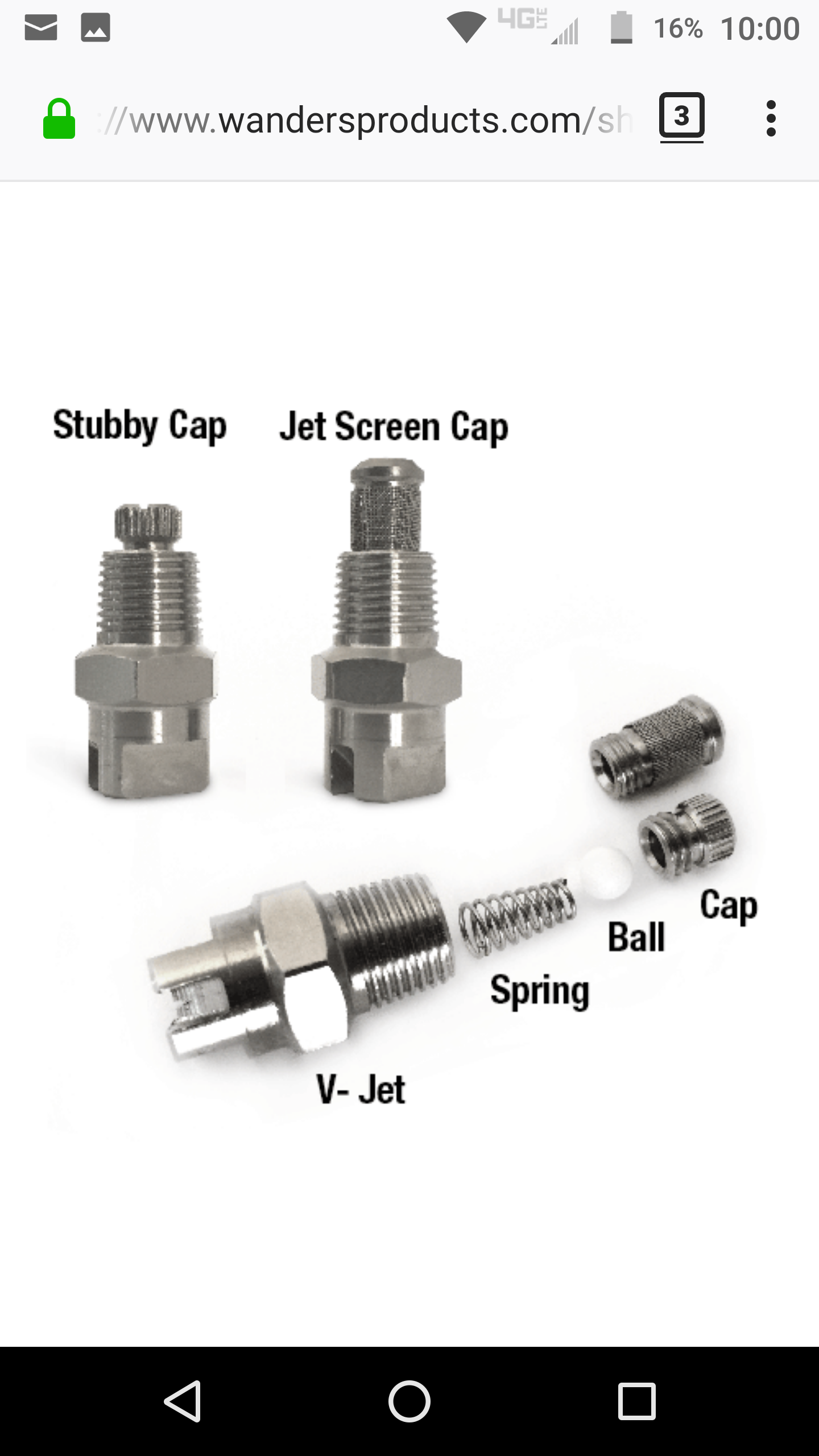

Who sells the jets with internal check valves?
Wand Slinger
Sep 14, 2018
283
Christopher Paulhamus
That would be
Reactions: Bob Pruitt

Pee streams...also leaks when hose cooled off as I’m about to disconnect the wand from the solution hose.
