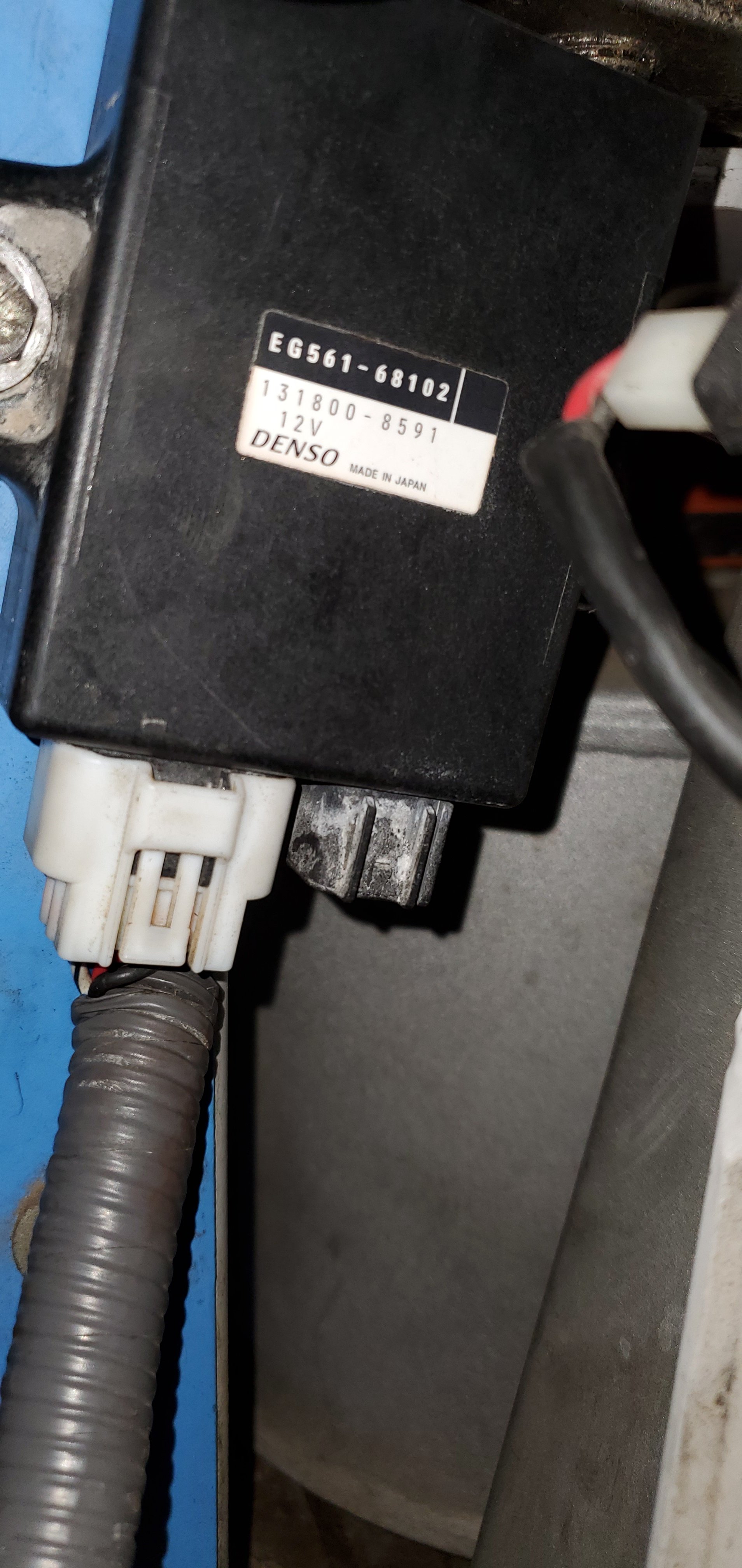

It ended up not being the computer it wasn't even the coil.
Its was wiring to two coils that were hitting and missing.
Mitch heard of the the thread here and called me and told me to take my machines somewhere else..
I took it to Greg at truckmount specialist and he got it figured out.
Ps Mitch is more mad about me not buying a 3rd computer at his price.
Like I just want to undercut him.
I just want my stuff to work and when I send it some where I want it fixed right.
I spent $55 on the diagnoses $75 for my guy to drive it up there $30 in gas.
And $500 for a part I didn't need.

You put it under load it bogs out or lulls we ran it an hour and it no longer does it.
Greg said a coil will heat up and the machine will shut off and it takes awhile for the coil to cool down and then the machine will restart.
So the symptoms don't match a bad coil.
But your very well right it still may have other issues.

dielectric grease
Greg put some of this in the computer and wire connector.
Should help to protect for further damage
