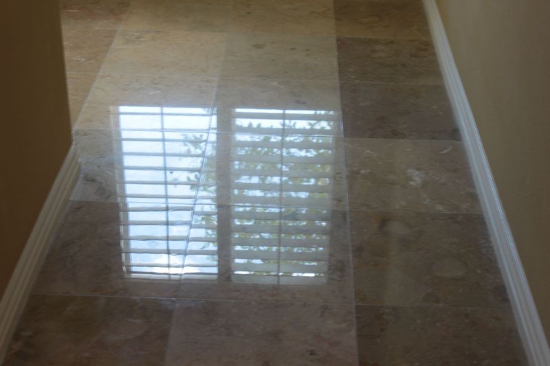

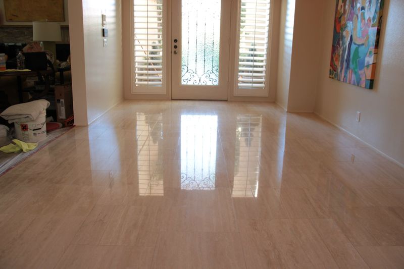

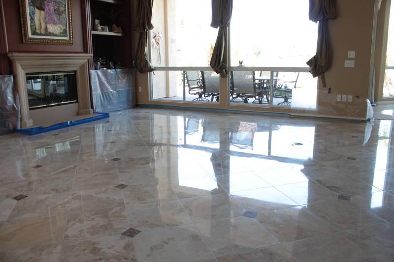

Werkmaster is not the best for the job. It's rigid, high speed and light. You can run circles around a werkmaster with a 175 rpm swing machine when it comes to refinishing and polishing (without removing lippage). For specialty jobs like grinding in place, concrete, etc. werkmaster definitely has it's place.
This video represents everything wrong with the refinishing industry. It's not rocket science, but you have to have a brain, a little common sense. A soft pad with with a ton of weight on top of it will never create a flat surface, you're just pushing it down as hard as you can and it will follow the different hardness of the minerals in the stone.
For companies to present these pads the way hey do is irresponsible and just plain BS. They have their place, but not for what they are presented as.
Here are a couple floors done with a 175rpm, 110v swing machine and diamond abrasives. Standard machine, cheap diamonds, 5x, home depot vacuum, etc. Nothing fancy. You don't need fancy equipment to do good work.
Notice the clarity. No orange peeling or texturing

I gotta come out of lurk mode to say "WOW!" Just beautiful work.
Feb 5, 2013
527
Southern California
cameron demille
I appreciate the compliment. The reality is almost anyone can be trained to do this in a relatively short period of time. There is a systematic approach and 80% of stone refinishing can be done without having any special knowledge or skill.
The top picture was done by someone else I teamed up with. That was his first time using 5x. The middle picture was done by me. The bottom picture, I did the diamonds and my helper, with no previous stone experience, did the powder polishing. Just by letting them run the machine and giving them verbal adjustments.
The bottom two pictures are travertine.
