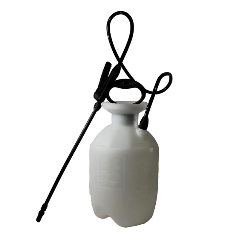

So like Mark says, it isn't worth the time to go outside and shut off the pump if you are only concerned with pump damage. But lately, the last couple of years, I have been keeping my TM off while I prespray and agitate with my red or white pad on my 360i. I am using cheap Chapin 1 or 2 gallon pumps instead of the HF so the truck can be off for the first 1/2 hour to 45 minutes of a job. They cost $10 to $15 and are surprisingly rugged and are more accurate than the HF albeit a little slower.

Thinking along those lines, maybe I am better off using a battery sprayer and not running the machine at all until I am ready to extract.
I have instant heat with a diesel burner, so I don't have a warm up time waiting on HX.
Sorta what Art Kelly is saying.
Reactions: Desk Jockey
Probably a better idea than the wear & tear on your machine when its not needed, along with the fuel wasted.
Its a bit of a hassle but with the savings in fuel treat yourself to a nice lunch. ;)
