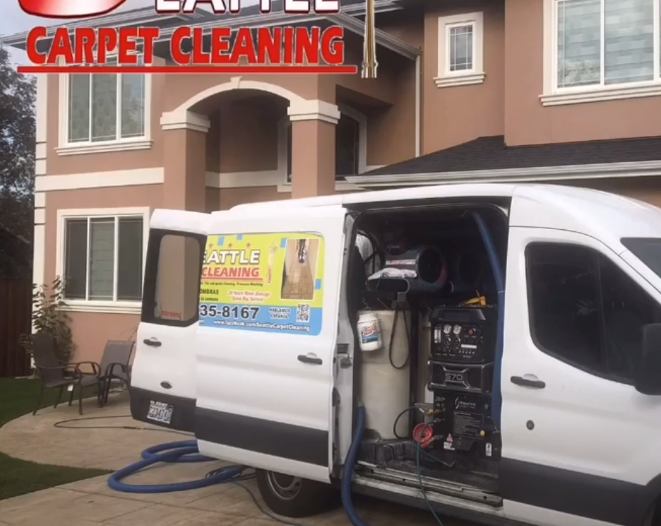

Just to piss you off.
It sure can produce some heat though.

I didn't see any dry passes, not correctly overlapping the previous wand passes, and thinking that showing the steam in the freezing cold room was worth something. Plus, the picture above with the van shows he's parked about 15-20ft too close to the house (carbon monoxide)
This is one of the dangerous parts of our industry
Since that room is freezing cold, I'm assuming there's no power to turn the fans or heat on to help it dry. That floor is ruined

So many mistakes...where do you start.
The hose maintence alone makes me arrr.
