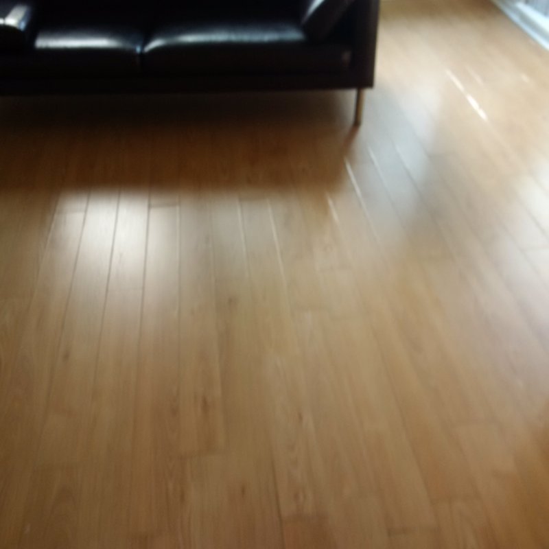

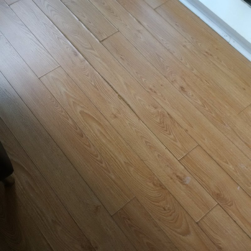

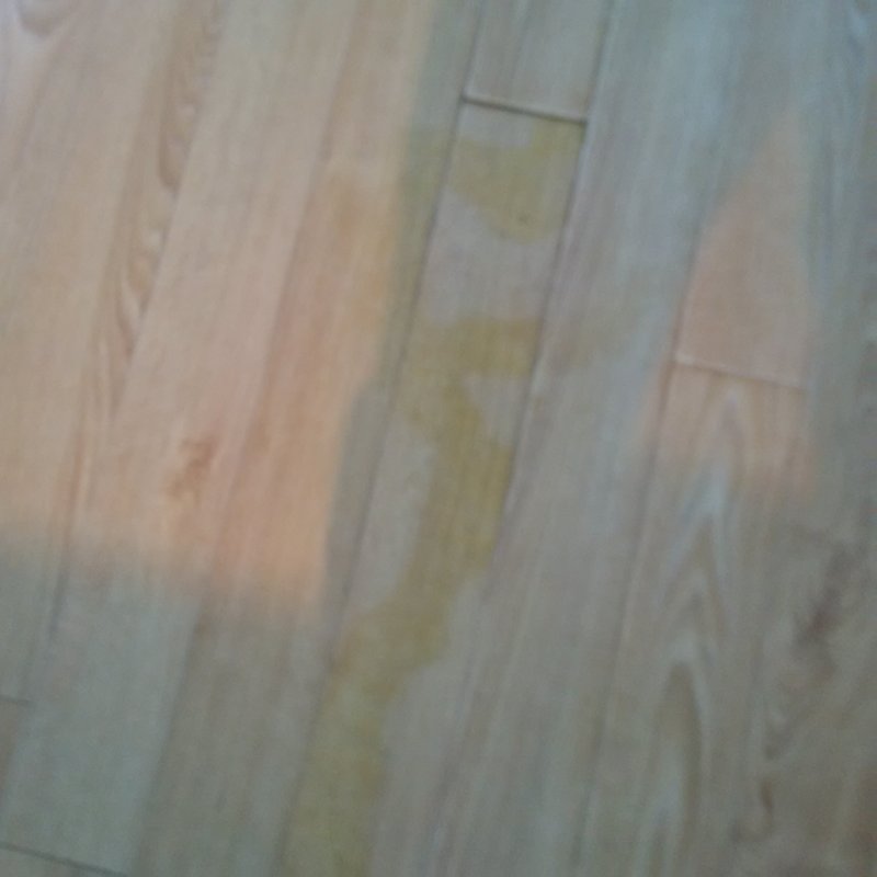

I just did those laminate floors today. Turned out they were badly water damaged and couldn't have used a 175 on most of it due to warpage. Floors should be replaced but lady wants them cleaned for now. Used my wife's handy/dandy spin mop with a neutral cleaner with some urine deo in it. Then a scrub with zep l. Floor cleaner. Then rinsed it again. Came up nice except for the damaged areas.

she had a small flood and her tenant did the rest apparently. she just wanted it to be more sanitary so she could move back in and plans to replace it soon. I'm thinking on my next one, I am going to try a 175 and cotton bonnet.

Ron, all kidding aside, you did exactly right to use a spinning microfiber mop and minimize the moisture. It is amazing how much territory one can cover with those things. Sometimes, low-tech is best.

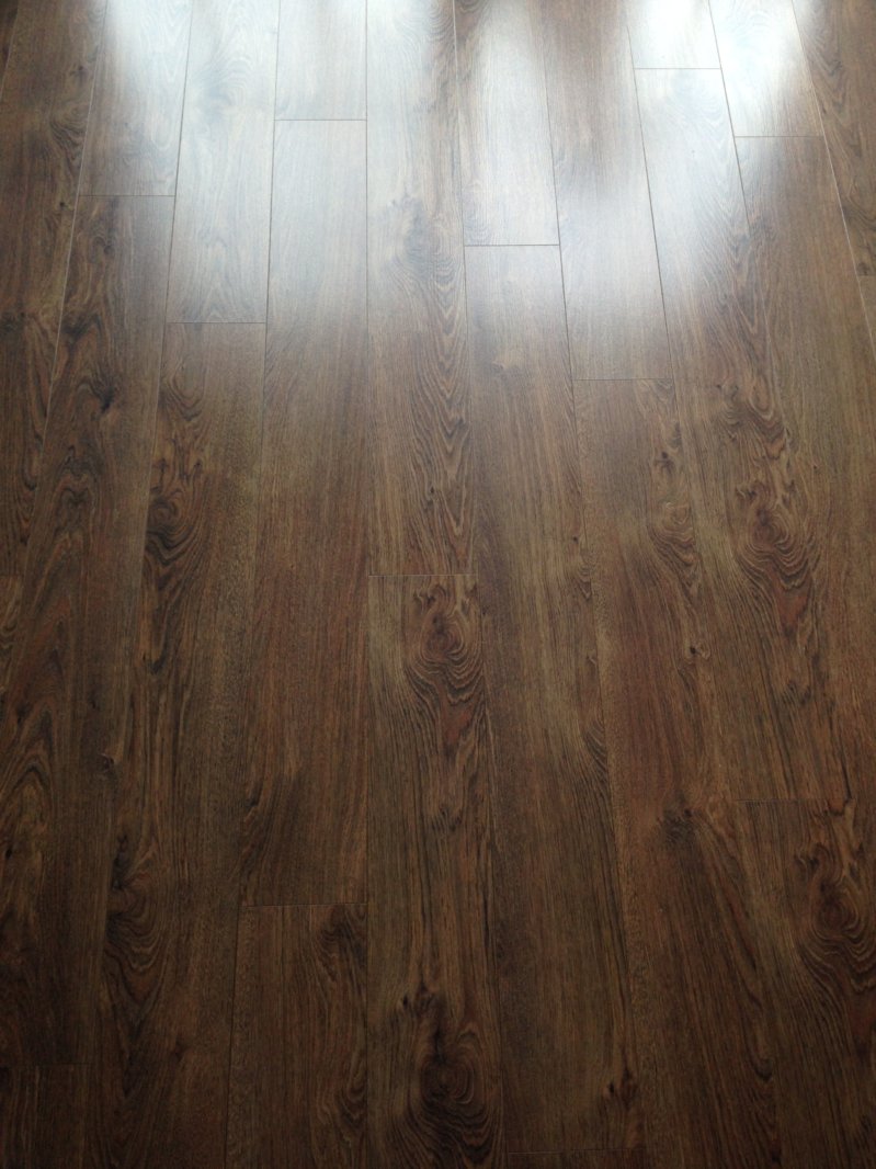

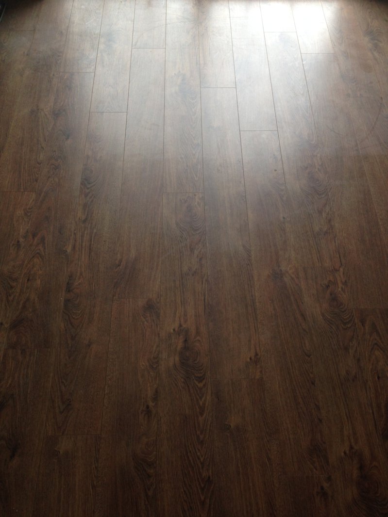

Laminator plus
I have used this product and is simple and works
The flooring look good for a long time
In my case it last over a year
So easy to do.
