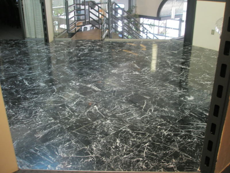

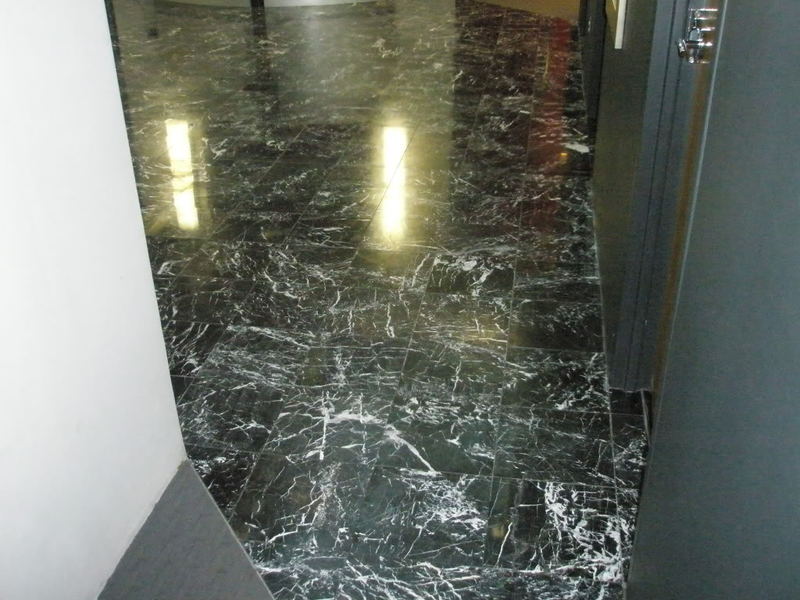

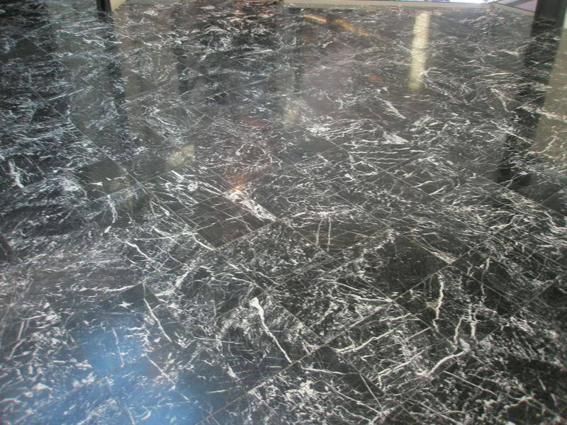

this is my latest stone job with Monkey Pads. It was a black marble and in bad shape. The maintance crew had slaped some wax on it and it looked like shit.
Before
its hard to see but they washed the floor with a acid cleaner and it has a bunch of acid marks on it.
After

do you have any plans on removing the obvious picture framing? Sorry, Monkey Pads lick balls
R
Ron Lippold
no im not going to flatten the floor they knew about the un even floor. shined up real nice thats what they wanted.

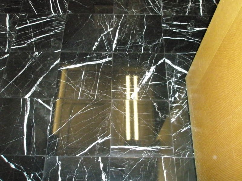

Look at the bottom picture of Ron's.
Find the tile at the bottom of the flour. light.
Look at the dull areas along the bottom edge.
That portion was not polished as well because the tile below it was slightly higher.
Larry

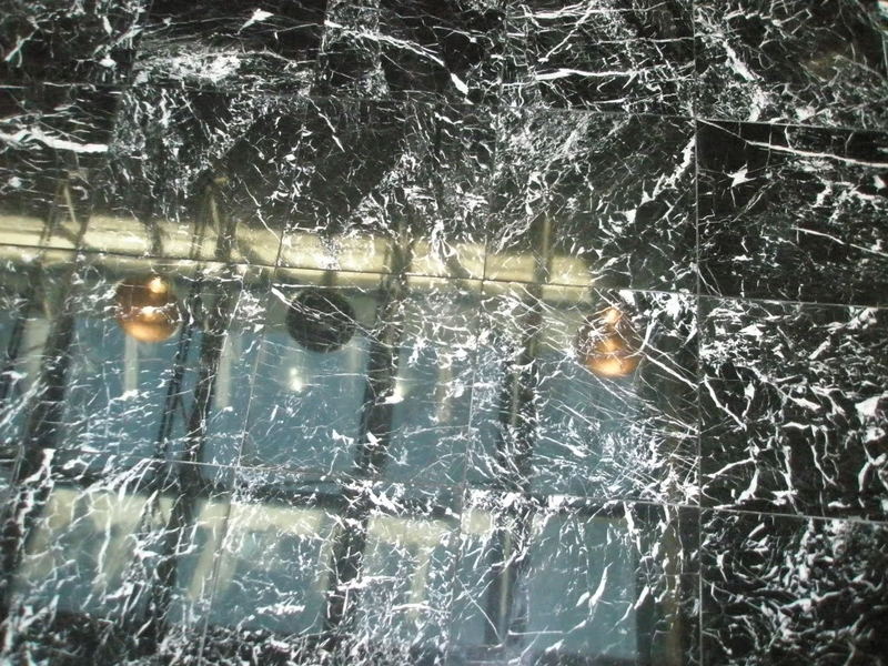

In the after pictures beside the door I see near the flourescent light reflections of what appear to be window paneing.
Am I right Ron? Did you encounter any lippage?
