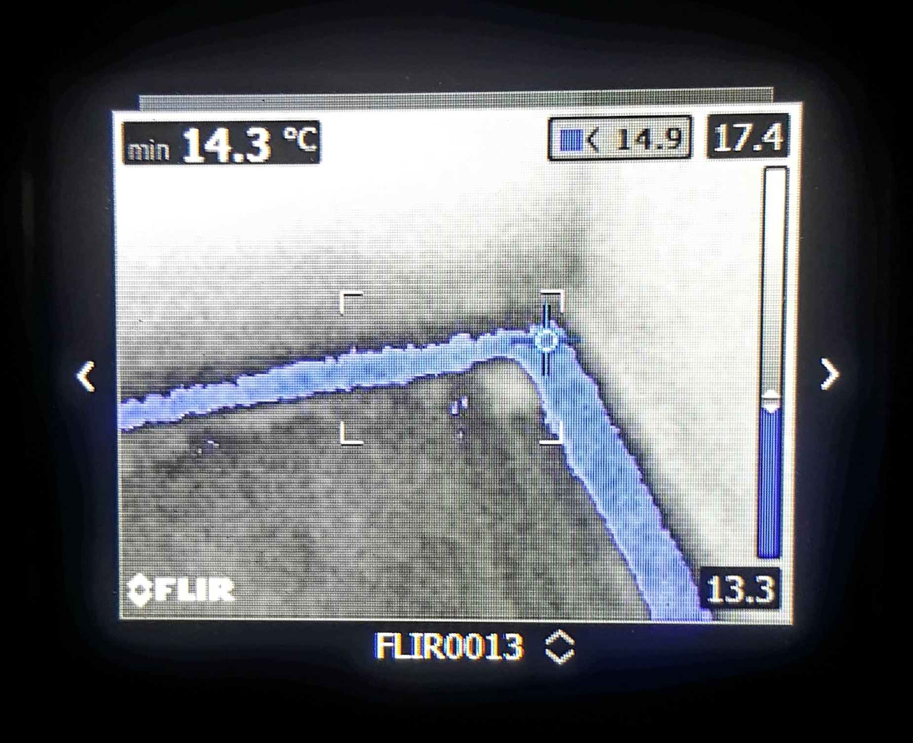

Relatively new build 7 months old..
Mold on face fibre of carpet and the smooth edge (U.S. tackless?) the ensuite is behind that wall its a leaker...
