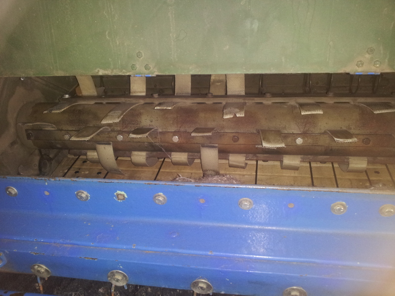

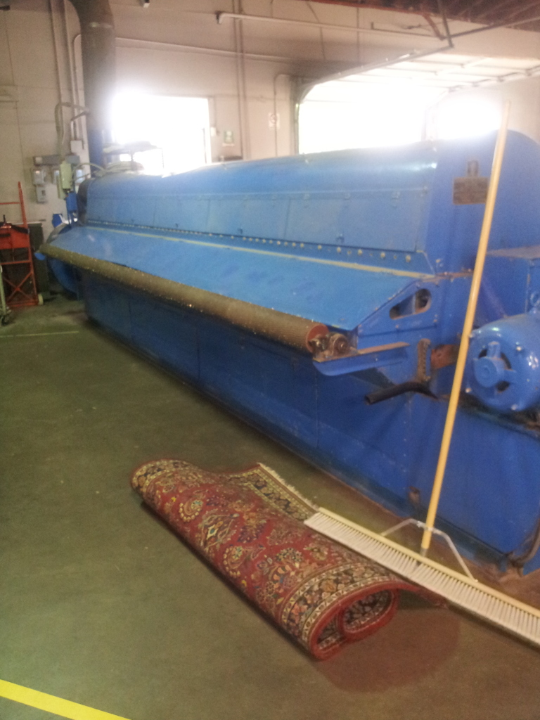

Here is the "Big" one that stood the test of times. It does not use rotating belts. It uses straps made of spring steel. I must also tell you it is LOUD!
An inside look:

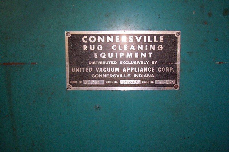

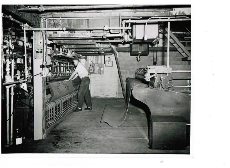

Here is another model made in past days. The company no longer exists.

I like the Connersville style duster because you get a workout while using it. The straps want to pull the rug through the machine fast, so you have to hold it back. When you give up the tug of war the rug shoots out the other side. A good modification might be the addition of a pinch roller to control the rug.

I spent some time feeding rugs through that thing ..looks like they need to replace the straps again!

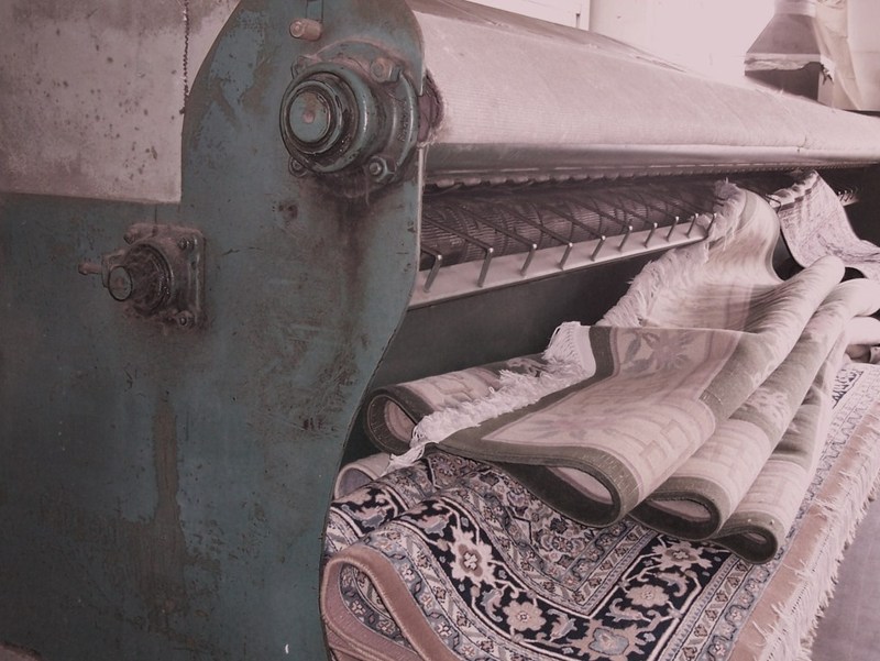

How about these?

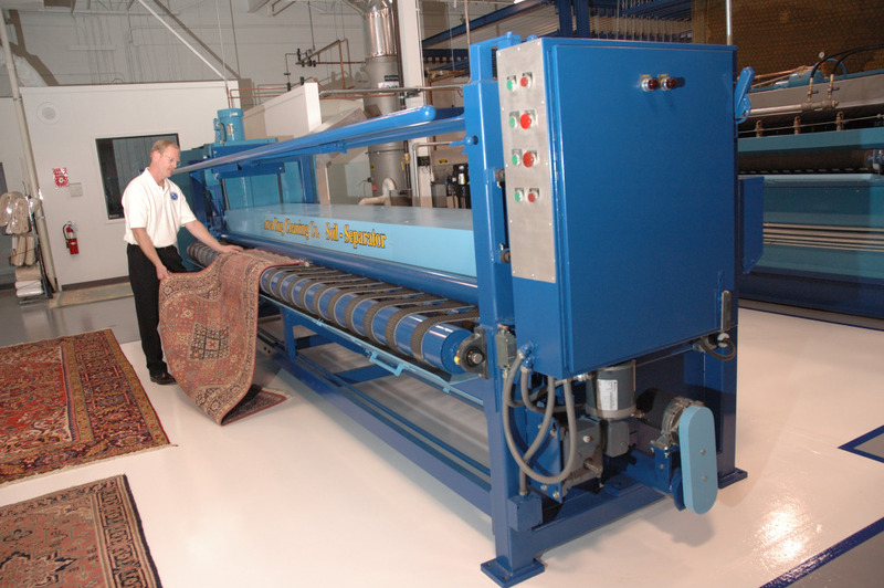

Here is the one and only one I made in 2005:
This duster resides in India now. (I made and sold it under the name of "The Soil Separator".

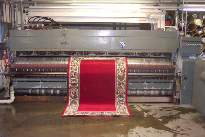

This one is from Culbertson's in Oregon. The lines you see on the drum are little spikes to grab the rug and the wringer rollers are relatively small diameter and immediately behind the wash drum. The shaft below the machine shows belts that are for the rug return. If you don't like the look of the rug you can flip up a metal plate and feed the rug back under the machine.
Pretty clever, but more complex and difficult to maintain than larger machines.
