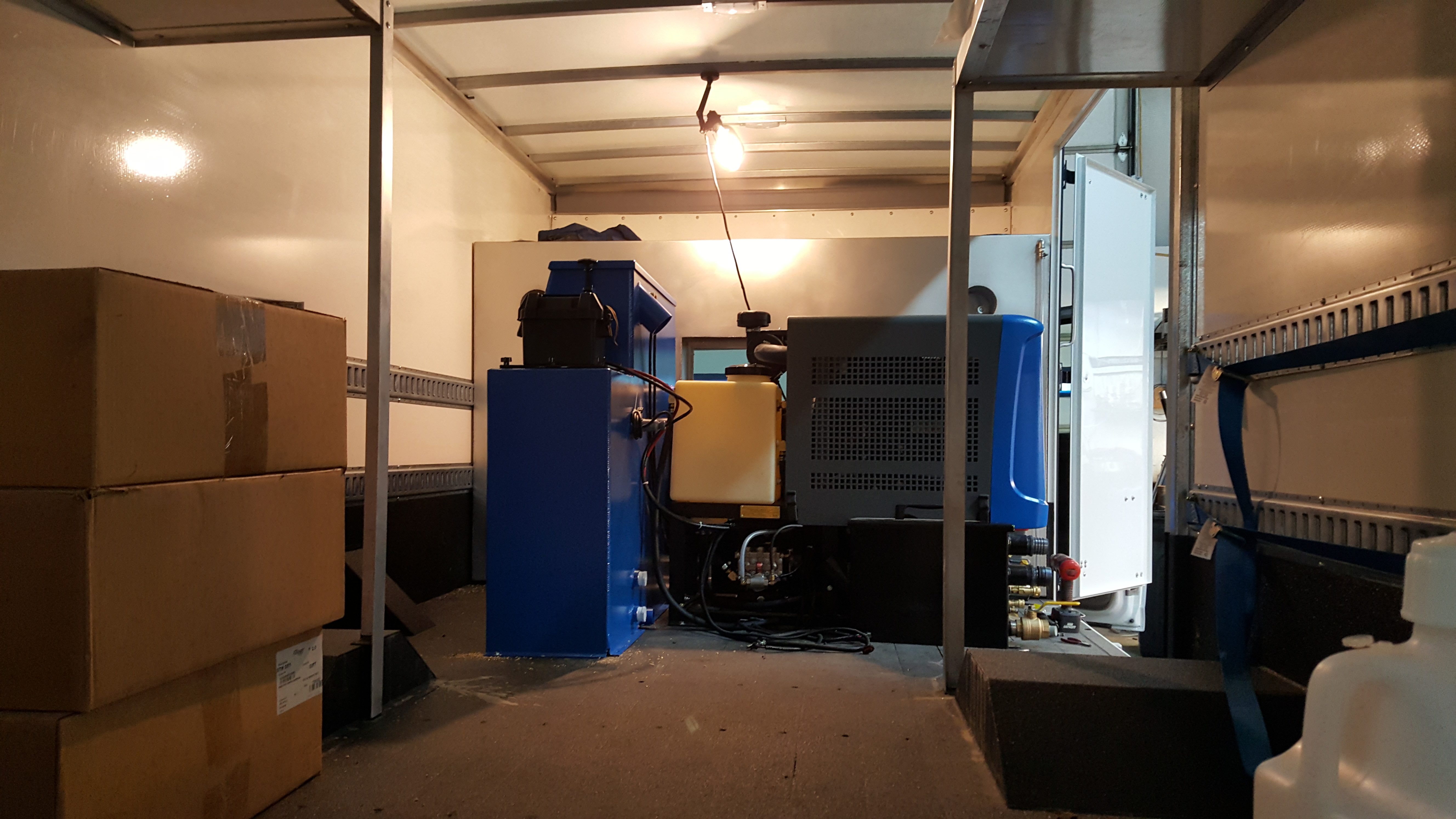

Last month I moved the exhaust exchanger from the back of the truck to the front, opened up space in the back.
