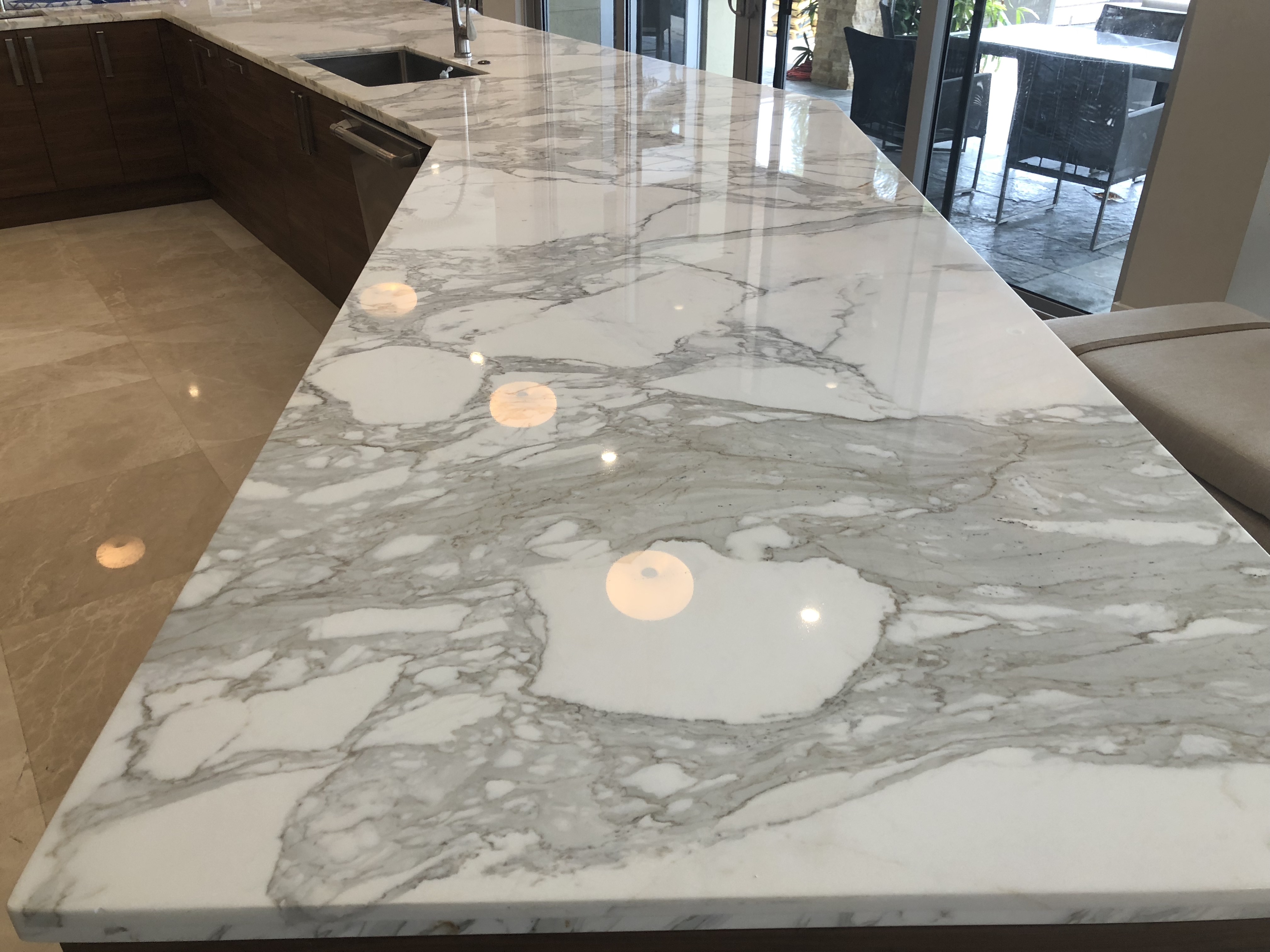

with the proper tools you will love it. Here is an example of resins and powder on marble bath counter..
