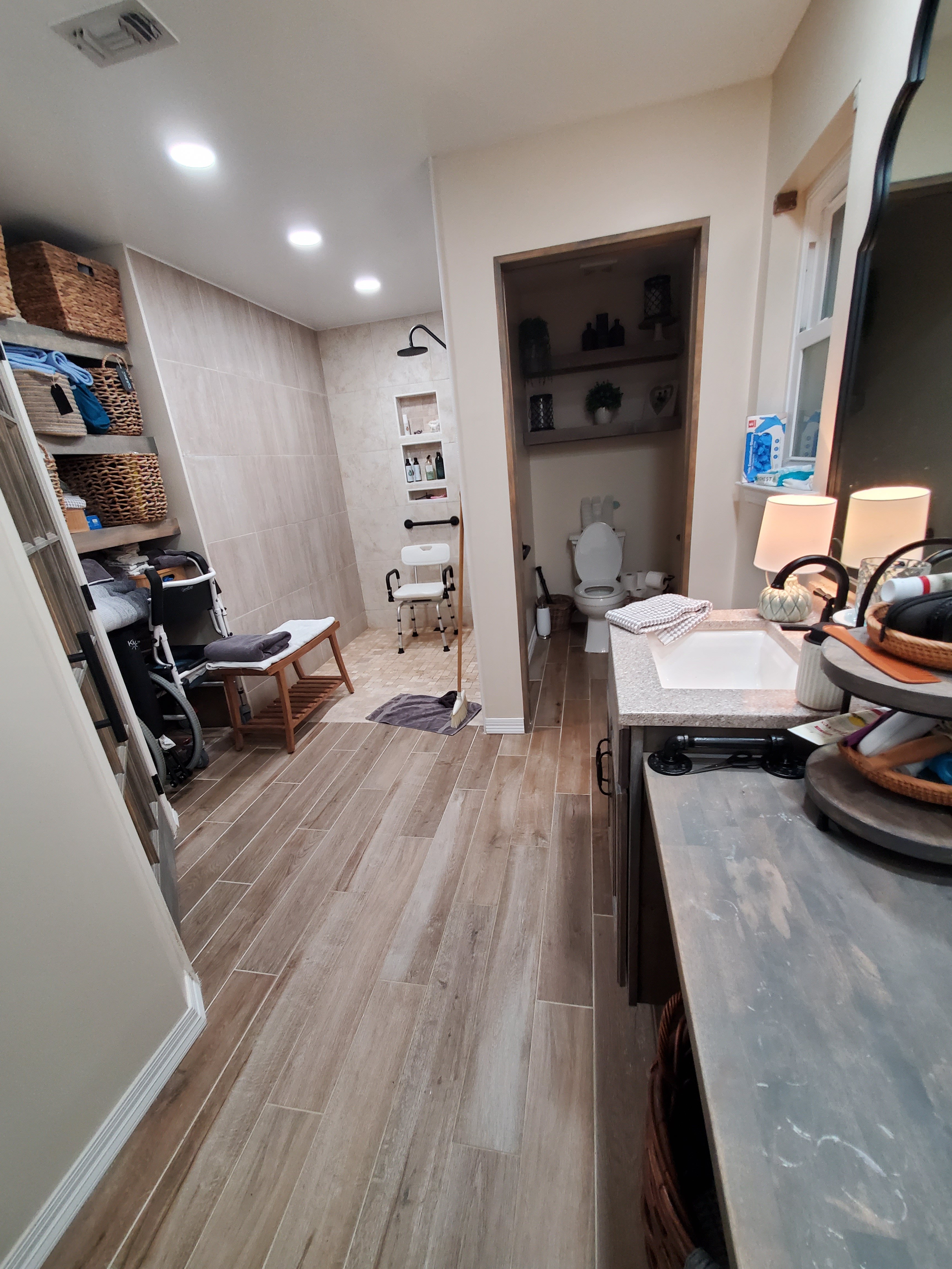

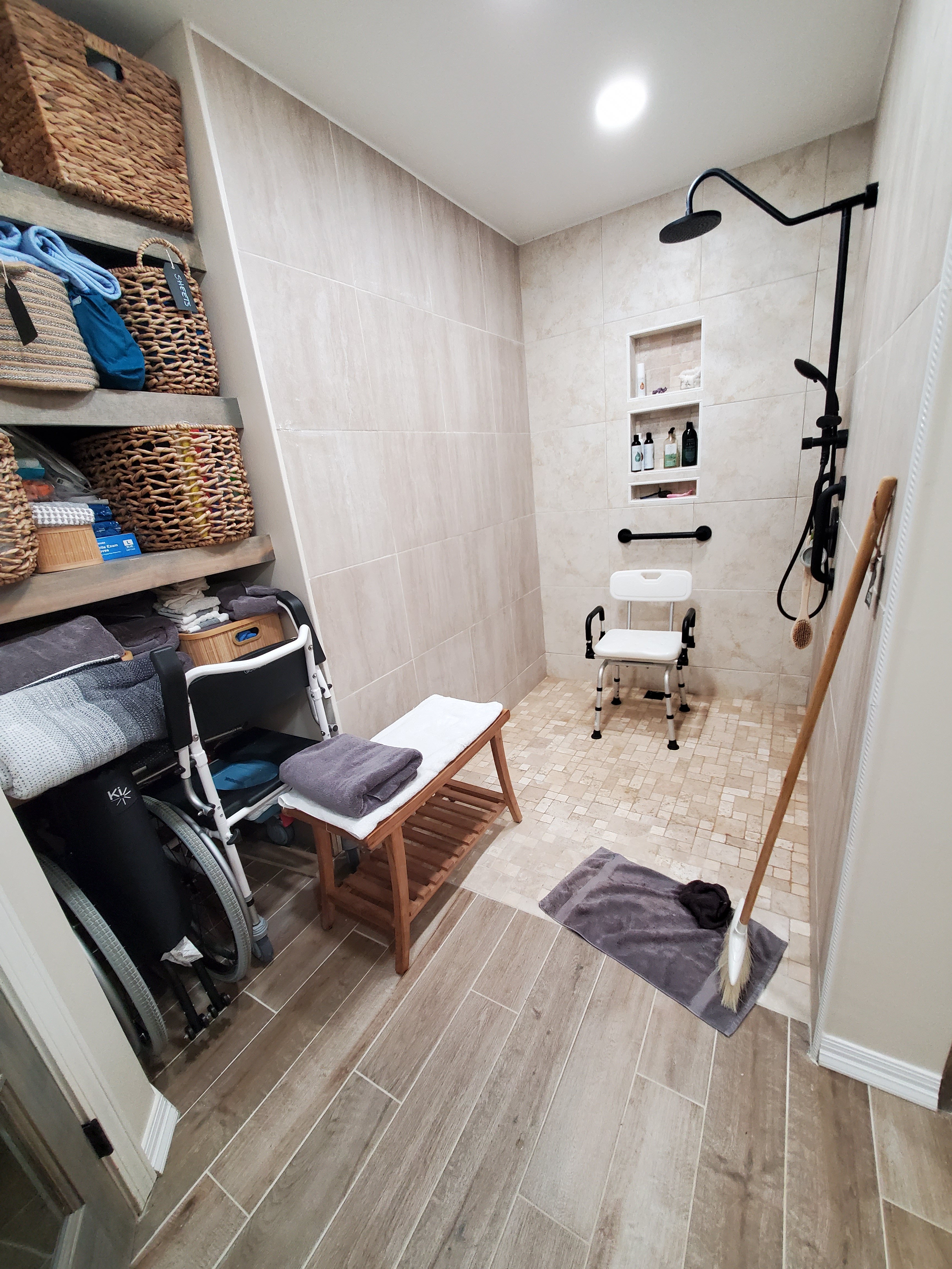

Had a custy call and her husband had a stroke last year, so she had her bathroom re-done to accommodate him. Large walk-in (well, roll in) shower, less than 1 year old and she's getting mildew on the grout. The guys who installed it said they sealed it. Is there a specific (or best) type of sealer that inhibits mildew/mold in showers? Or is this a problem with poor ventilation (not drying fast enough)?
Thx!

Try scrubbing with any old high pH grout or carpet cleaner and a stiff brush, if that doesn't work try 40 volume peroxide, that doesn't work try prochem professional grout restorer, if that doesn't work learn how to regrout....
