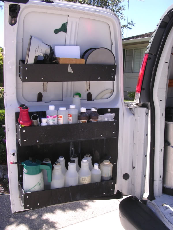

The roto molding sounds interesting mainly because you're using plastics but I'm having a hard time picturing them in my head. Since they start on the wall of the van there may be more space savings there. On the same subject, have you thought about making shelving for the side doors out of plastic?. The metal ones are out there but mostly in single shelving. Most of my chems are in the sidedoor in quart bottles. I made it out of abs and though they look ghetto I can see a professional model. Holes in the bottom so you can hose it off.

Albert, I like the way you have your shelves on the door, very handy, great idea, and plastic is a good way to go.
