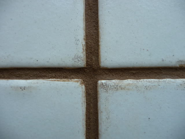

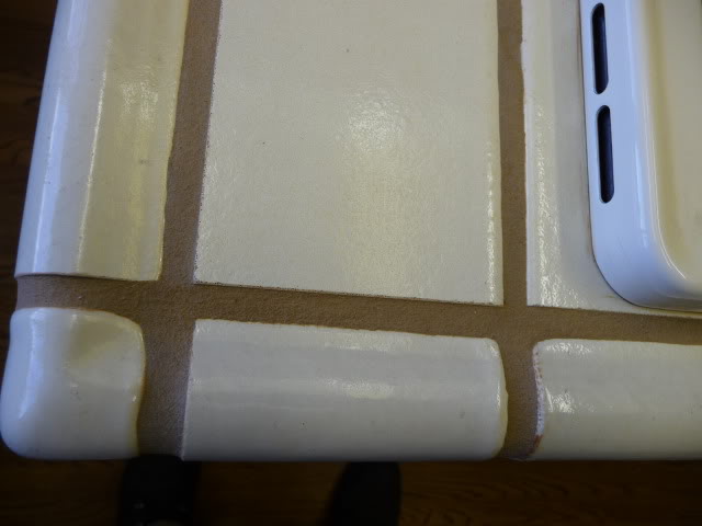

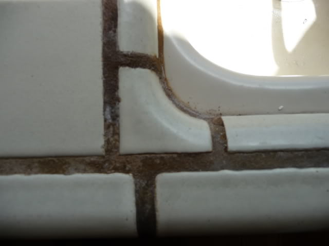

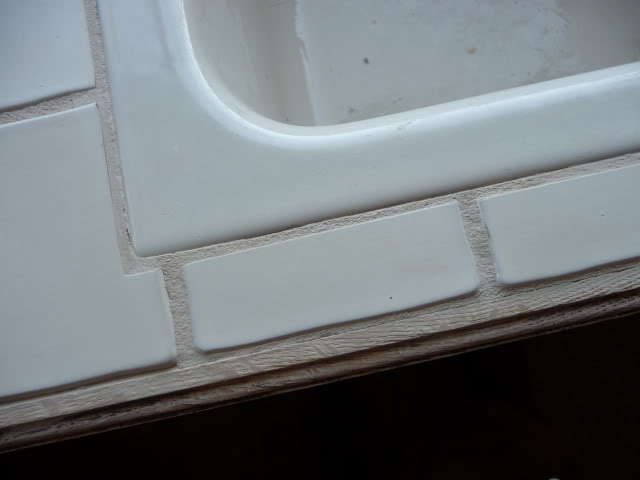

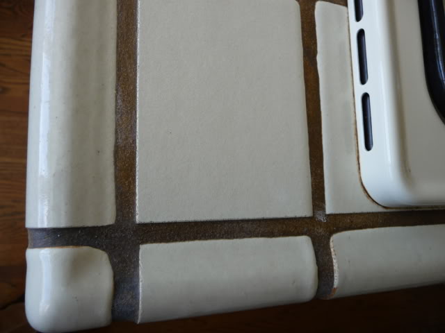

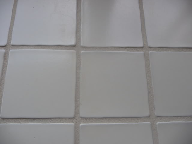

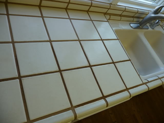

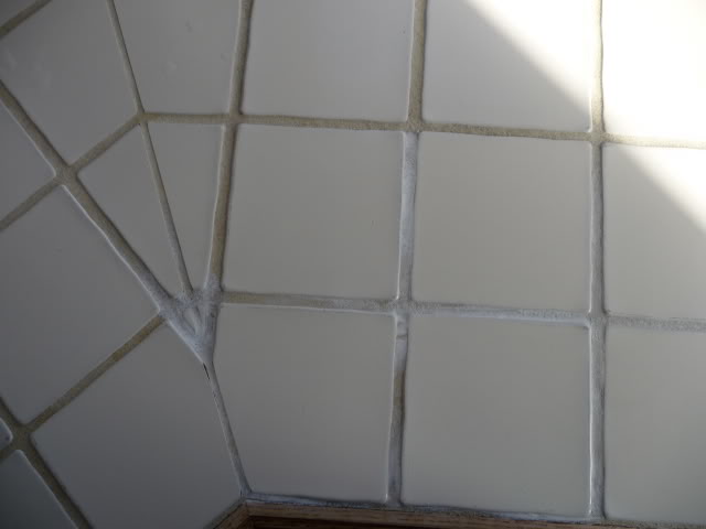

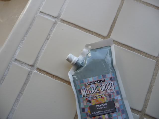

This lady though using some premix grout to cover her stained counter top.
Not only did she goop it up real bad but she used the wrong color.

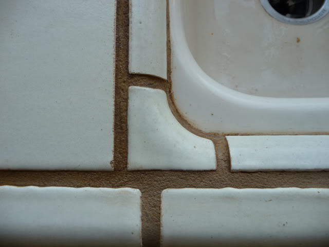

I used Franmar Soy Gel stripper. Nice safe stuff. No odour and not skin burns.

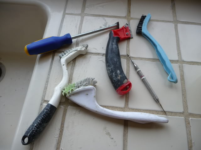

and a few tools..

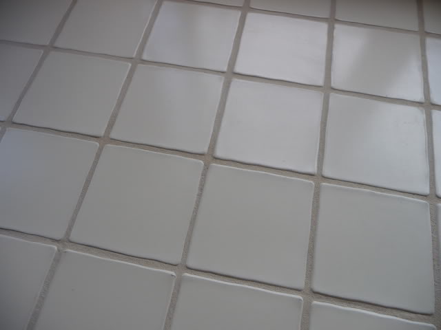

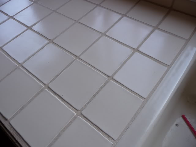

Power washed it off, color sealed it with Grout Perfect and voila!

Have you ever used that Soy Gel stripper before? And is that a Magic Wand product I see in the background there? :shock:

Do you always use those dental instruments. I just realized I have boxes and bags and more boxes of them
that my wife has used/autoclaved/retired over the years. Now I have some Ideas!

Magic Wand Acid is weak, I prefer Restore but want to use this stuff up.
A minimum of $600 to Color Seal a countertop
G
Mikey P said:
RW must be use to Formica.
The problem with that is justification,I can almost put in a granite slab for 600.00 bucks.Now,with that said,if it would last a good 5-7 years,fine,but you (they) already say no useage in a shower,so I am already skeptical on the time thing.And to be perfectly honest I think it might be really just a glorified masonry paint.This is not a bitch Mike,it is a real long term concern.
116,262
Most daily use showers never dry out, having a impervious coating over the grout would be a bad idea.
Plenty of company have been color sealing for plenty of years and report no real issues.
$600 for the slab, how much for the labor, new paint, back splash, sink, fixtures, trim work, time and hassle?
G
I like the stuff(easy way to look better) I guess I have to see how it goes in the long term.
