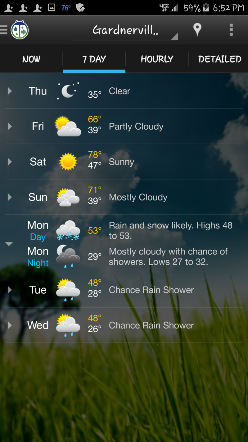

Monday is our first freeze
116,334
15" of snow above 7000
Dusting on the valley floor and high winds..
Tell me again what I should do with this 370?
It will be in our attached insulated garage..
Reactions: Desk Jockey
A planet far far away
We have a freeze warning tonight. All the TM's in but one. Our north garage has fire contents we need to move into the building next week.
The one tm outside has a single heater in it. Mike its not single digits, run one heater just to make sure the temps don't drop too low in there. Your day temps are so high its not going to be cold enough to be too concerned yet.

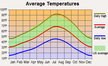

How low do the temps get in the Winters there Mike?

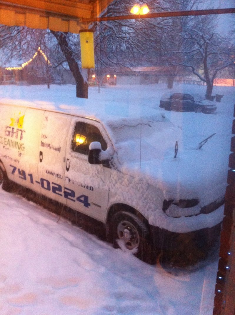

I wish I had the picture of my van in the driveway with about a foot snow on it that melted and froze all the doors shut in about two inches of ice.
It got parked inside after that.

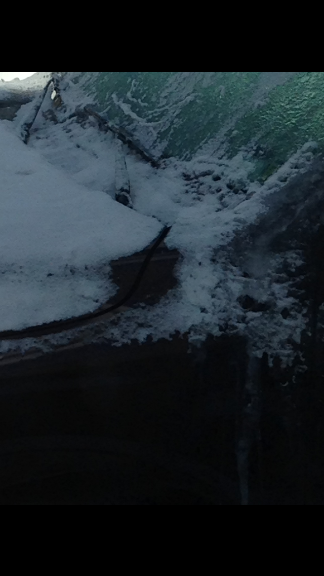

My 1st house I insulated the garage and didnt have to plug in a heater until it was less than 10 degrees out. This past wintewr was the first with parking outside and will be the last. Pluggin in the heater melted roof top snow then as the water flowed down the side - it froze the doors and wiper arms. There was like 2-3in of ice around the arm that had to be chipped daily along with chipping the door cracks to avoid bending the metal.
