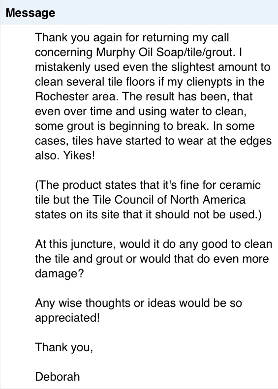

Customer has emailed stating that this Murphys 710 Soap over time is causing the grout to break (degrade) as well as the tile starting to wear at the edges. Wearing tile sounds impossible. I think theres a soft tile, maybe Duraceramic, with putty like grout. Could that be it and would this MOS be damaging the tile n grout?
May 12, 2007
2,519
Bruce
I just had a friend in a different industry show me a picture of his clients ceramic tile and she told him the ceramic was wearing on the edges. I told him I would have to look at it to make my guestamation on what it was , whether it be dirt or wear. I just find it hard to believe that it's wear.
