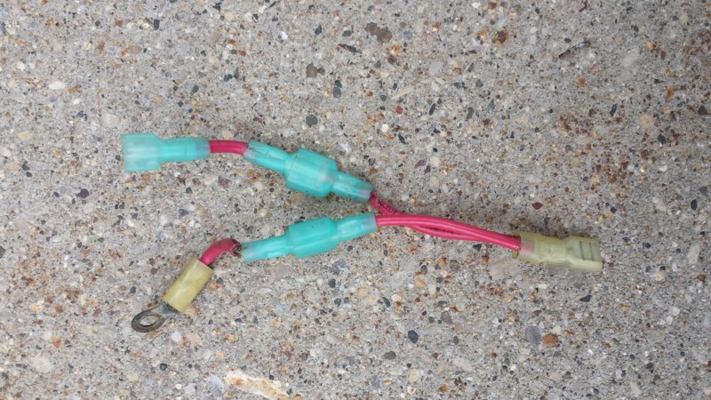

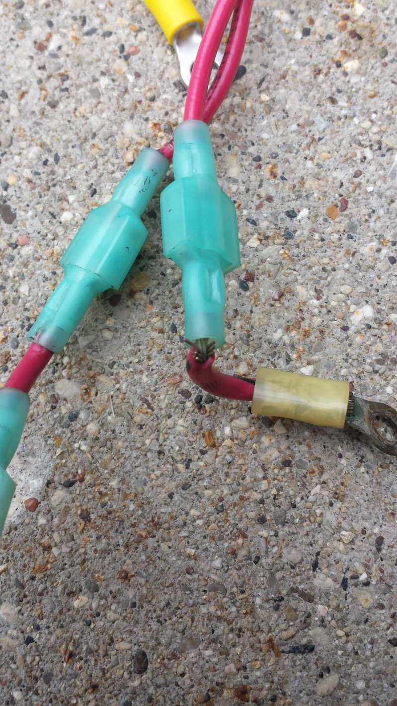

it was just a simple switch back out a relay and hook a ground up to see what it did...
I didn't think that was to confusing......if it did not change anything..plug back in the new relay....

OK, I put the new oil pressure switch in today and the electrical is back to normal, :rockon:but still runs rough..
There is a ground that goes from the negative batt. to a engine mounting bolt..
