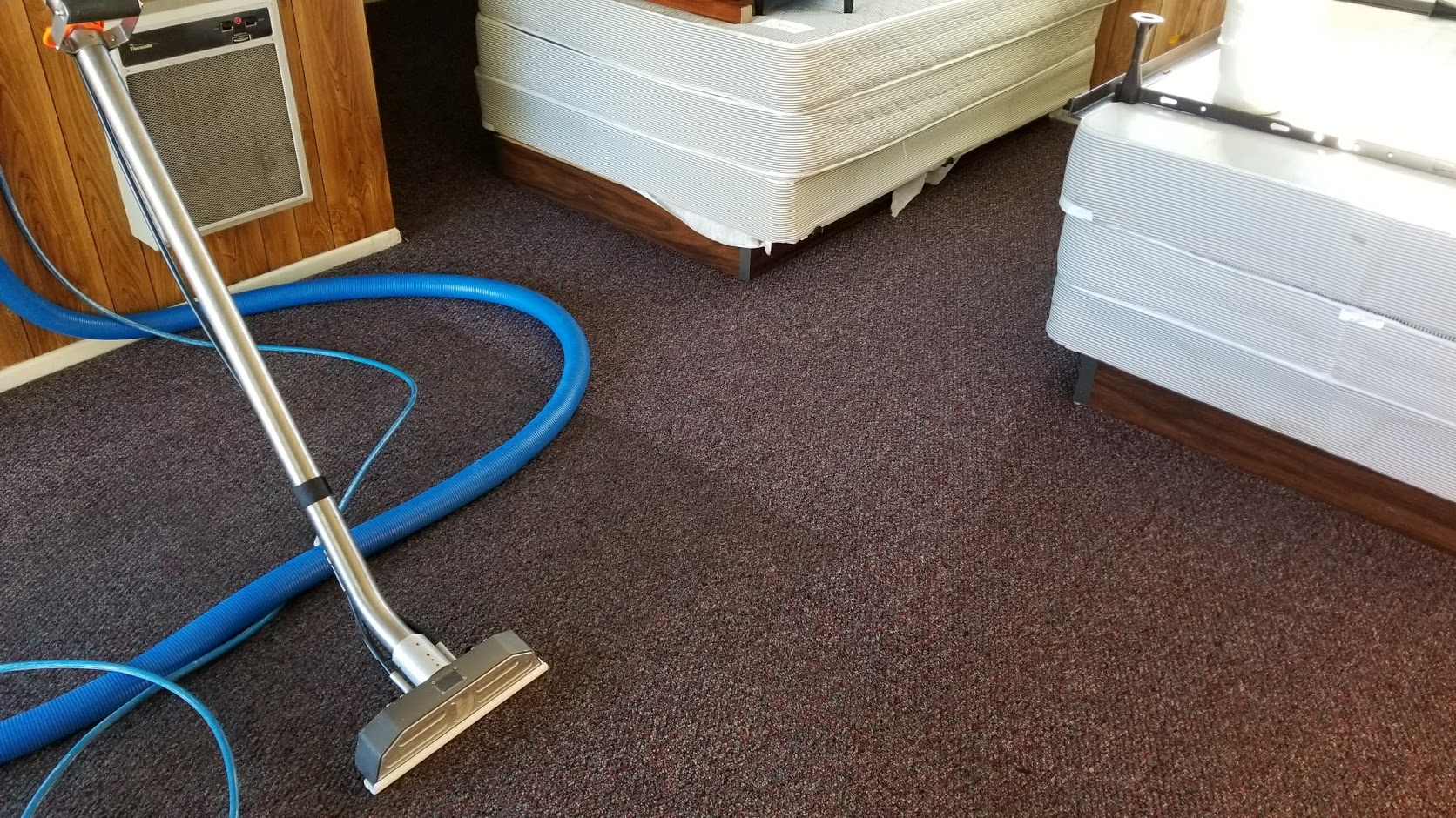

The level of soiling is not visible in the photos.

Followed with HWE?
Ever done a side by side comparison if done with a CRB scrubbing before hand?
Is there a visible difference?
Time saving?

Of course followed by hwe, did you not see the pictures that started this thread I'm clearly wanding the carpet.
Red padding with a 175 prior to extraction is certainly not just for commercial either, this exact same Berber type carpet is found in a million homes nationwide that's why every truck needs a 175 and the crb in it, otherwise you're just a goober..
