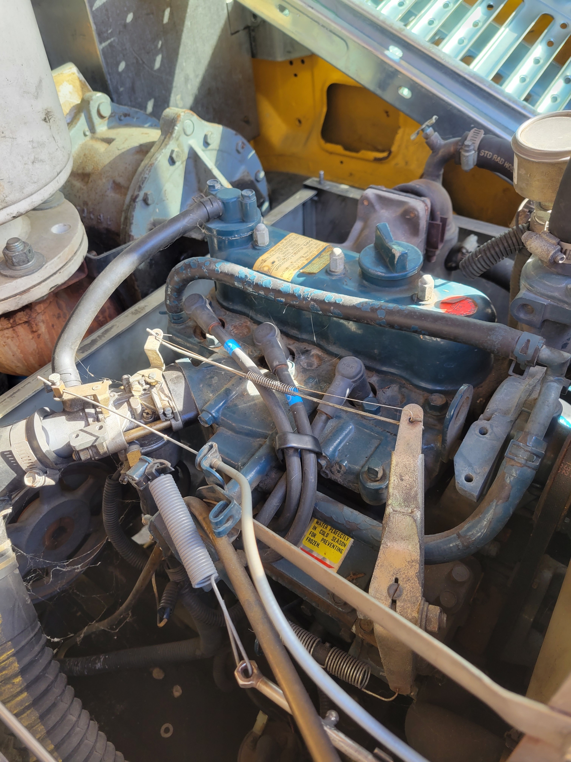

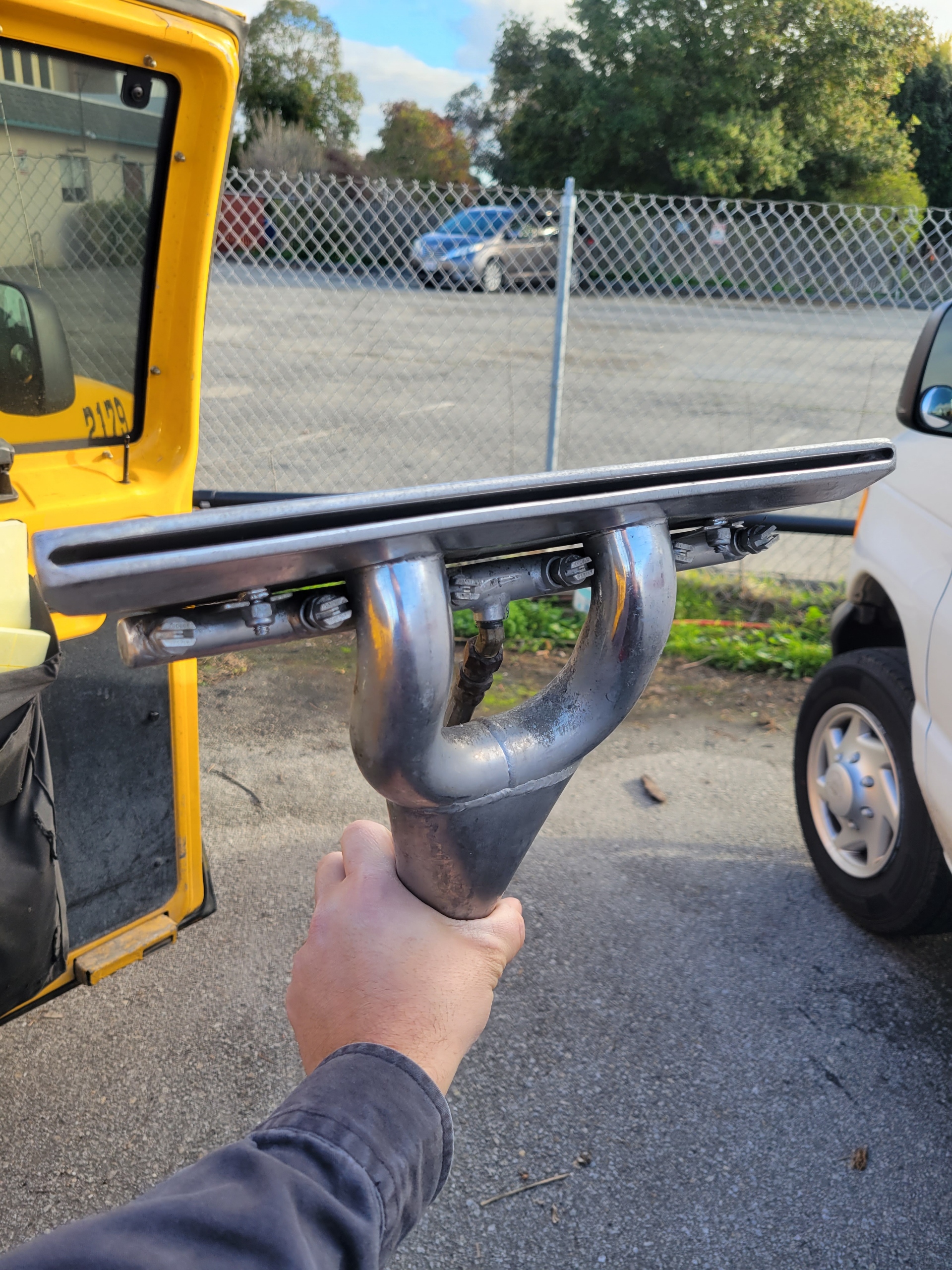

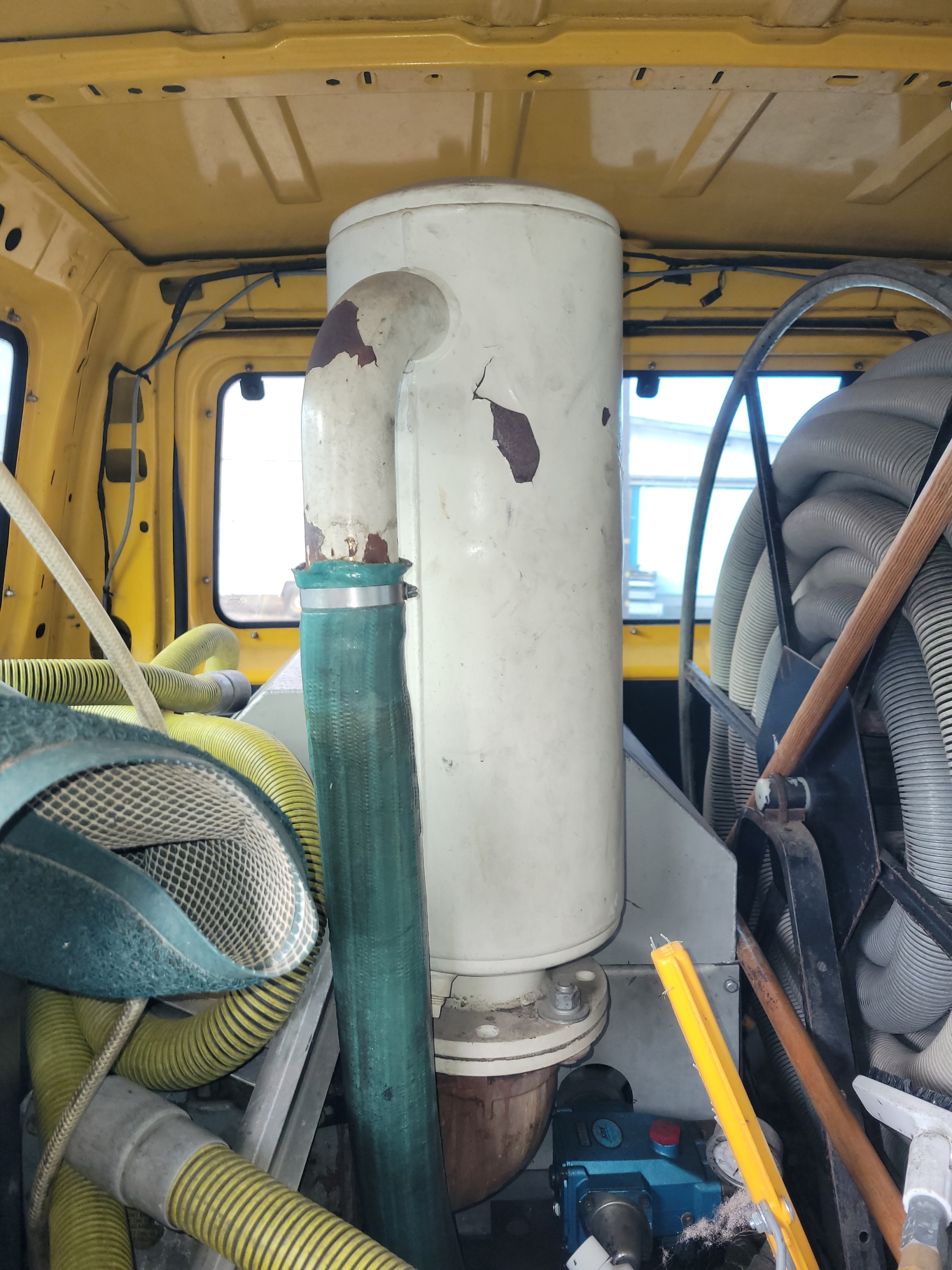

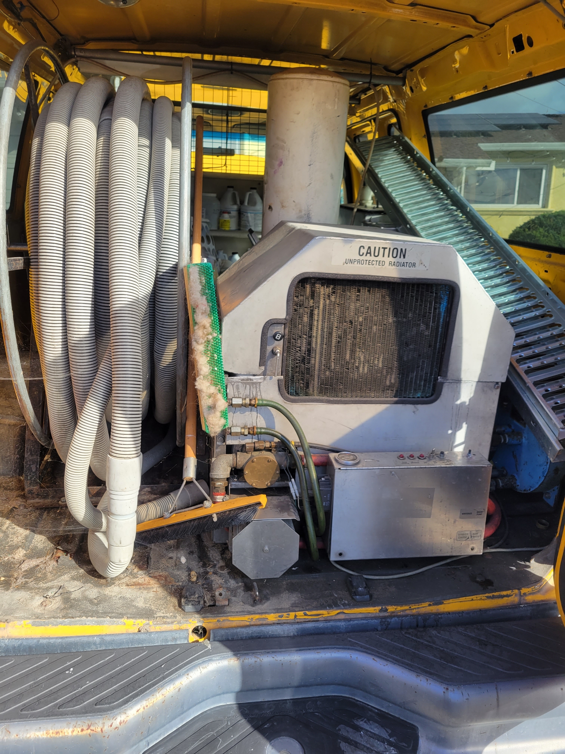

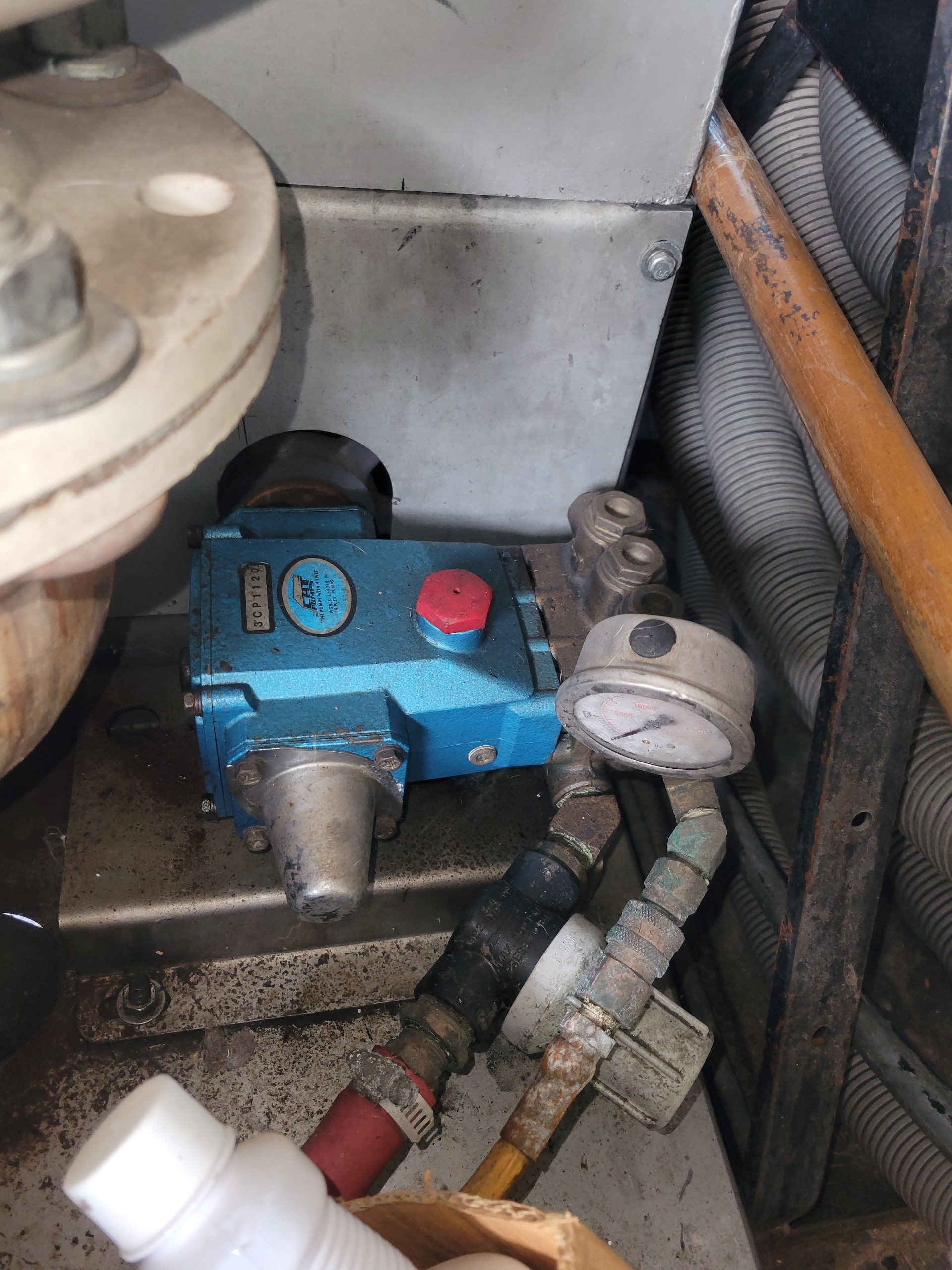

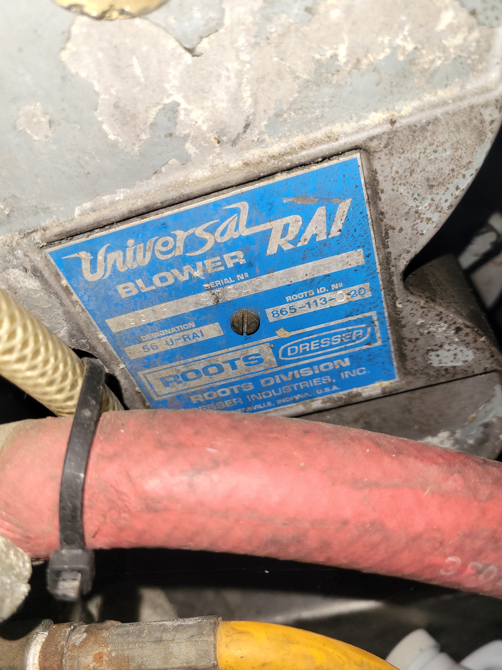

I have one that I've run for years. I built a frame to raise mine up so I didn't have to cut a big hole in the floor and changed out the 56 for a #4 blower because it's only a 21hp Kubota. Got rid of the all metal pancake coolant hx and replaced with a stainless steel one and added a ss exhaust hx. Simple to work on but it eats up a lot of your van space.
