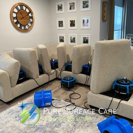

Extra work in drying that, it sure does look cool. Though I would wager 2 velos dry it better at much less work and time involvement. I have 5 air pods on me but switched as customers didn't like them put on the furniture.
Immaculate, like new.Why, were the units scuzzy looking?

I agree!!!I fully applaud the effort.Thats how all furniture should be treated .The faster it dries the safer the job is and it enables you to touch up as needed while at the home .Perfect ! If the industry did more of that there would be far less problems on Carpet and Upholstery ! That impressed me big time...A True Master Craftsman !!!
