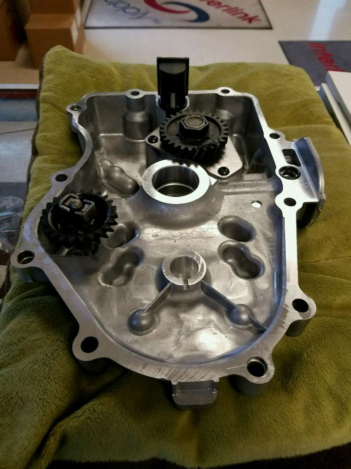

Back end has an oil leak.
I guess it so common than Kohler has modified the back to help the RV THREADS do its thing..
See that bevel on the lower inner edge?
That's where the RVT will gather to do it job..
Kohler is covering the whole tab.
Hmmmmm, mine has the same issue.
How much was the new rear cover? Install? My research - it was difficult to find the cover and was like 400+ just for it. Plus install. If they let you know, let me know.
I need this repair or a new engine. Ugggggg! Or just let it leak(not a lot, just annoying) and keep my money. Start over with something else, maybe.

There is no gasket kit for this
RTV
Well, sometimes the engineers get it wrong the first time...and the second.
If that were my engine a gasket would be made for it before I reassembled it.
I've pulled apart RTV long after the stated cure time just to find uncured wet product.
