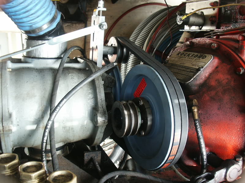

You've all been asking for it... Now here it is :|
Be warned it is a disgusting sight. Waste oil spewed all over it from a busted line then belt shavings covered EVERYTHING. Also Duct tape, 2x4's, hand prints... you name it
Specs:
70hp - 132lbs Torque
Rebuilt - 1983 Mercedes 4cyl Diesel - Running on 100% Veggie oil
5MP Sutorbilt
Some kind of General pump
Also Bawb will like seeing the GREEN belts
And notice my space age Red Power twist belts on the pump, i friggen love it. Best belt ever.

John Watson
2,885
Ashley, Thanks for the photo's, I am not trying to be knit pickey, critasizing or trying to be an asshole, (damn, thats a hard one not to do) but my early back ground was building stuff with junk shit to begin with. So please bear with my rambling,,
First off I am known for over building with heavier materials. I noticed you mounted your #5 on its side for ease of plumbing hook ups and from what I see you used 1/8x 1 1/2 angle. I would have used 1/4 as a minimum attatched to 3/8 plate with a slide type belt tensioner. I would have welded 1/2 nuts to the plate and use the 1/2 bolts with double nuts to adjust. what did you use for your adjuster because I see a hump in one of the green belts? ( I know of nothing faster to take out the bearings and eat belts on blowers.)
You have made that thing so it can breathe, good for you.
I can't see the frame you are using so no comment,
That ABS plastic pipe has worked great for me. I have a #5 vertical plumbed with the same stuff and size. Mine goes into a 200 gal fiberglass tank and was shaft driven.
What are your plans for heating your water? You sure got lots of options, Heat exchanger, Lpg, multiple, a vegtable oil fired burner would also be neat. You could get alot of parts needed of an old steamway unit..Their newer ones are 12volt compared to the 120 volt ones I had alot of trouble with those..
Anyways you probobly got most of it all thought out, You look like your doing a good job, Keep it up if I can help with your thinkin things out feel free, I am also bass akwards on a lot of things too..

John: I greatly appreciate your constructive criticism, thats why I posted it here.
The photos where actually taken while the machine was On and thats why the belts look like they are uneven. They flap around a little when the machine is on.

FCC:
I will eventually be doing something like this:[attachment=1:1zwxm4gh]drive plate.jpg[/attachment:1zwxm4gh][attachment=0:1zwxm4gh]drive plate 2.jpg[/attachment:1zwxm4gh]
Except NOT that long!
That way I could put a pulley on there that is MADE for B belts
Those pics are from a Home Brew Genset somone made from a VW diesel engine, here is the link to his site: http://www.oldengine.org/members/jdunmyer/genset/

Those green belts are the equivalent of Bx belts (They also have equivalent of Ax) and I bought them at Car Quest for $18 per belt.
There called "Gates PoweRated" and they are all green...
I appreciate Bob Vawter for turning me on to them.
I have not put allot of hours on them, but by this time on my last 3 sets of B belts they had worn down + glazed and slipped like crazy because my setup is not aligned well and my drive pulley is off a Ford diesel and not made for this application.
So I would say if they can hold up to what I am giving them, they would last 3+ years for anyone else.
As for the Red "Power Twist belt" I have been equally impressed with it. I just put it on my pumps pulley and took how many links off I didn't need, then "Twisted" them together and didn't even have to adjust the pump or anything.
I would love to know if these belts would work on a #5 blower, if these green belts ever give out.

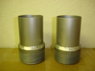

Jeff:
Are those Stainless Steel?
Greenie
6,820
AshleyMckendree said:
Jeff:
No, those are aluminum that has been hard anodized (like all of my metal fittings), they would be more expensive in SS, and especially so in the madrel bend type elbow assemblies.
Gonna make some 4" and 3" as well.
