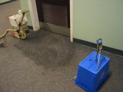

Another thought, use a Tripod for your pictures and when choosing a camera make sure to get one with a "portrait"mode for close ups. Also, always take two sets of each picture, with and without flash - you will find that without flash is usually better.
Here is a not very good shot of a very small tripod which closes up to about 6 inches in length, holding my new flip video made by Kodak model Zi6. I'm not recommending it yet as I just got it but it does have a close up mode.
